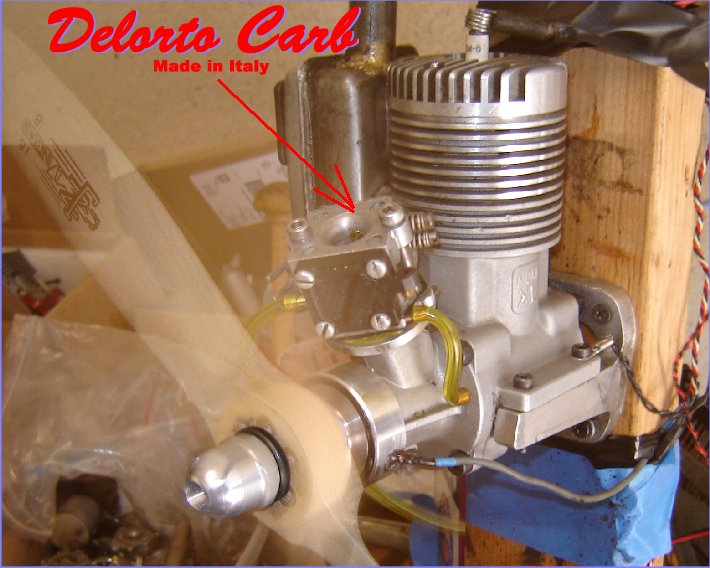

Scota, can you post a couple ofphotos of this engine? Just wondering what exact engine you may have. Thanks, Capt,n

MORE DATA I idid a google search and found a thread where a person did a nice conversion. Below are photos. Capt,n
