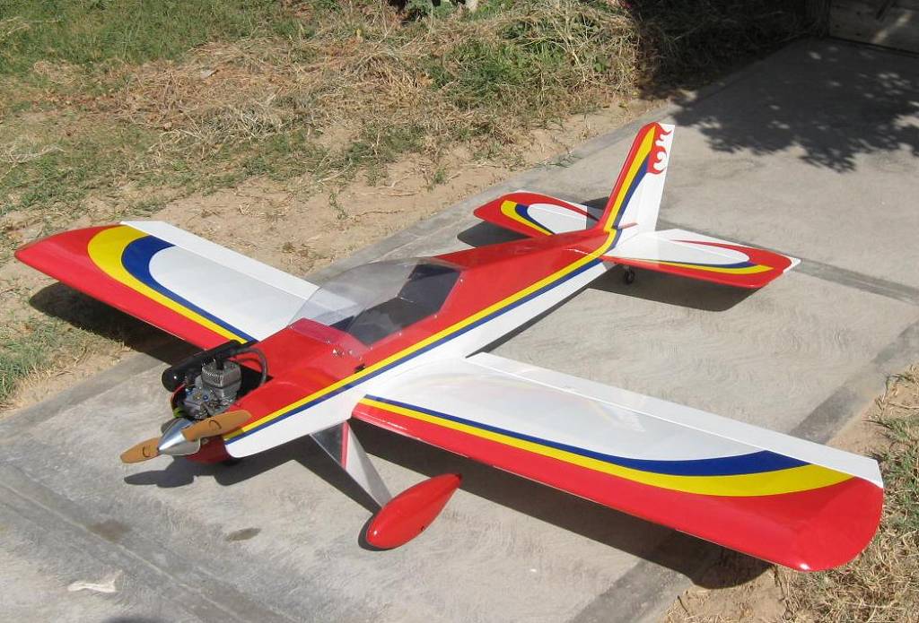

Well, if you look over in the "Gas Engines" forum, there is a huge "ballyhoo" about this, with proponents on both sides.
Having said that, I decided to try it. My latest plane, an ARF bash with a BME/Supertigre .90 on gas/ignition, is controlled by a Hitec Aurora 2.4 rig. I am running the ignition system and the radio both on one battery. No problems so far. (I am not using an isolator of any kind; just running both the receiver and ignition off one battery to save weight.)
Apprently from what I have read, the RCEXL ignition likes 4.8 volts but will live on 6 volts. No more than that however...

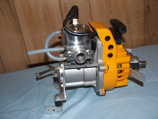

In running your weedeater on a glow plug,it eliminates the stock ignition,except for the flywheel.If this engine would be converted to an airplane engine,would it start as easy just flipping it, or would an electric starter be needed ? I have a Homelite 30cc I converted,but it is still using the original module.Would using a glow plug,be benificial to power and rpm's of the engine ? I also run highly modified Homelites in my gas r/c boats and if your method would increase the power and rpm's that would mean more speed. I run 32:1 mixture in my boat engines.Will glow plugs work with a higher oil content than the mixture you're using ?

There is always this option: http://www.rcuniverse.com/forum/m_80..._1/key_/tm.htm
It works on every engine I have tried it on from 15cc to 50cc, and you usually gain at least a couple hundred rpms.
