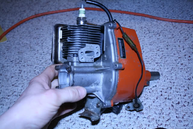

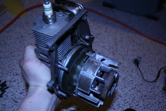

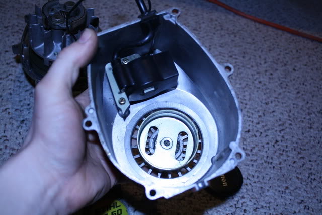

I got this engine from a rental yard some years ago. It was originally a String trimmer of some kind, though it couldnt have been a very powerful one. It does still run as-is, but I'm considering converting it to run as a glow. I cant find any info on it through stihl or googling the model number. I measures approximately 16cc or .98 cubic inches. (1.100" bore, 1.027" stroke) so I dont think it would be overkill to run as a glow. Anyone have any insight on this little guy?

The carb that came on this engine is a Teikei from Japan, the numbers stamped on it are NB and 3L. It also has a primer of sorts. Engine (butterfly) side of the carb is 13.85mm, outer diameter of the carb is 6.47mm approximately. This carb has two mixture needles.
I have a Walbro carb thats bigger, but I dont know if either carb will flow enough fuel to run methanol. The Walbro is a WT 26 and doesnt have twin mixture needles. Engine side is 14.28mm, air cleaner side is 7.9mm.

You will find that the power will be low for the weight of that engine. However, it might be good on a floater like a Cub or a Telemaster.
The Walbro WT-499 is made for use with methanol, but at 11 mm venturi it is a touch big for a 16cc engine. You might try a carb from a Ryobi trimmer. They are small, but probably larger than what you have, and they are usually Walbros. If necessary, (and it might be), you can enlarge the passages to double the area in the carb. (Double the area, not the diameter.)
Another option would be to go Gas/Glow, in which case most carbs will flow enough. Look up the "Gas/Glow How To" thread, and read the first two posts for info on that.

If I was going to use it on anything, it would be an airboat if I use it on anything at all besides the test stand. I just know keeping the ignition on it would require keeping the shroud on it which defeats any weight savings possibilities. The crankcase is huge compared to my ST S90, but displacement-wise its real close. I figured this thing should ought to run pretty well anyway.
The walbro WT26 I have came off a 30cc or so string trimmer. The venturi on that is about 1.4mm larger than the Teikei that came on the engine. I'll have to tear it apart and see it can be made to work with methanol. Otherwise I have one more Walbro carb that has two mixture needles on it that is off of something 30cc or larger. I'll have to find it and get the number off of it. Worst case scenario, I have a 30cc homelite that has twin mixture needles I could pirate to try..

Turns out the engine the WT 26 carb came off of does have a high speed mixture needle, but the OEM (Ryan/OMC) used a weird recessed needle and put white silicone over it. The engine this carb came off of was made in 1984, so I emissions had nothing to do with it AFAIK. Anyway. it needs a diaphragm anyway so I cant test it until I get a new one.
The engine has twin ball bearings on the crank I found, but I havent checked to see if the conrod has needle bearings or not. I'm assuming it does though.
It won't be easy, but for the heck of it I'll check the port timing on the thing once I get it torn down. Any idea how much the glow plug adapter would cost?
