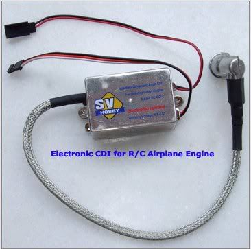

Could anyone post some pics of how to shield the spark plug lead.
I have read of it but i dont quite get how to do it.

Most CDI R/C ignition systems have a shielded spark plug wire/socket. The socket is solid stainless steel & the wire has a briaded S/S cover over the conductor/under the sheath isulator.
Similar in consruction, but different in application to a coaxial cable for your satilite/cable TV leads. 2 condutors, but in the case of the shielded sparkplug lead the outer conductor is a ground.
The braided sheath & spark plug cover ground to the engine via the sparkplug base & also to the ignition module case.
In fact, a good CDI EI system would eliminate your magneto/flywheel, be less prone to RF ineterfearance & save weight overall.
Here is a picture of a CDI electronic ignition system for R/C planes.
Note the braided shield on the high voltage plug lead & the metal spark plug socket.
This "grounds" any RF to the engine block/module case.

All I do is go to a shop that sells commincations equipment ask for some coaxial cable with braided shielding inside it.
You will have to strip the outer layer of covering off the cable to get to the braided shielding.Then I pull the spark plug cap off your lead slip the shielding over your plug lead solder a wire on to the shielding that is earthed to the head of your engine with a small self tapping screw.Make sure the shielding is isolated except for the earth.Then I cover it with some heat shrink.

See if you can find someone installing cable in a house somewhere and just ask for a scrap of the coax cable, I've done that before, I might have just crimped on a ring terminal at one end which should work fine, that stuff doesn't solder very well

Never found it necessary to use shielded cable if the noise suppressor plug was used and eliminate the steel throttle link.
You've kept radio gear isolated best you can so I would try that first.
Shielding would be a final application if all else failed.
TV Co-ax will not be suitable as it is designed for TV signals at very small voltages, maybe just a few millivolts.
Ignition systems operate at thousands of volts and the co-ax does not have a high dielectric strength. i.e. the spark will jump across the insulation to the outer shield under load.
