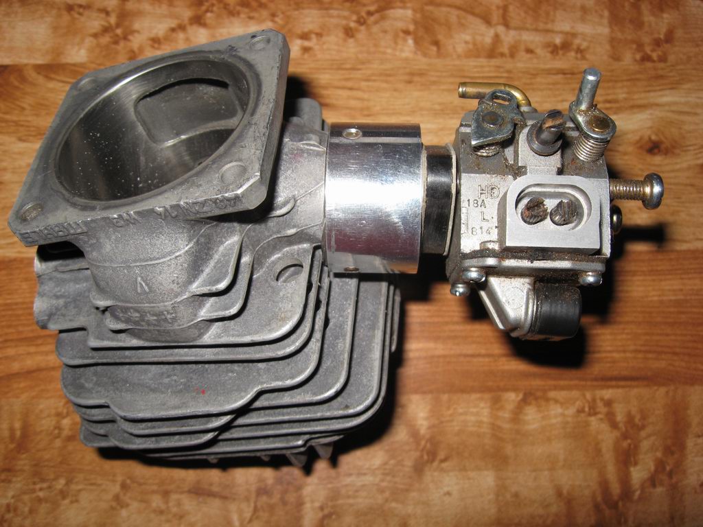

Finally got around to finishing my Stihl 62cc out of an 036 chainsaw. It was a bit of a labor intensive conversion, but it turned out nice. Turns a Zoar 22 x 8 prop at 7400 rpms.

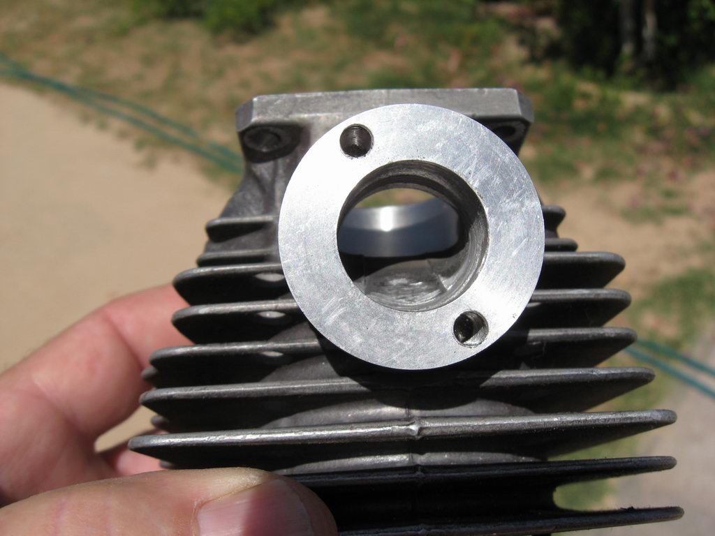

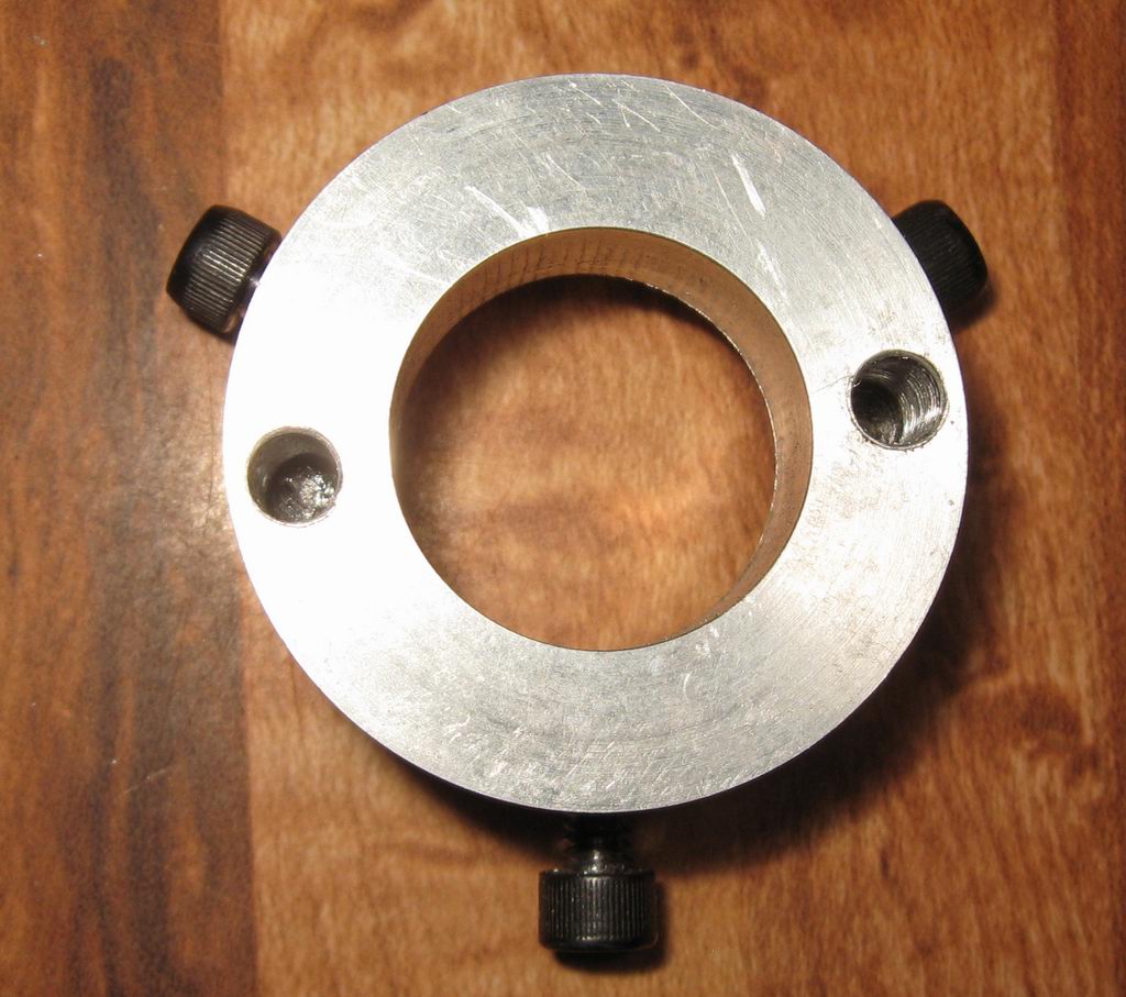

I had to make an intake manifold adapter to fit the oddball round intake port. My first idea was to use a homemade aluminum adapter, along with a spacer that used the carb mounting bolts. I was going to insulate the bolts themselves with shrink tubing, and use fiber washers under the heads at the carb, all to insulate it from heat. This didn't end up working too well, as the carb still got too hot. Also, that setup was too long to fit the cowl of my 28% Wild Hare Extra. So I milled down my aluminum adapter, and made a new insulator that bolted to the adapter, and had separate holes in it to mount the carb, thus properly insulating the carb. That setup works perfectly.

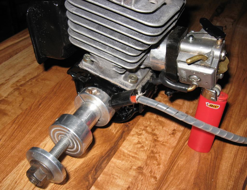

I didn't want to use the tapered end of the crank, because it had a very small threaded end that I didn't trust to screw a prop adapter to. So I cut the other end of the crankshaft to length, then bored and tapped it for a stud. The prop adapter screws onto that stud, and seats against the shoulder where the stud screws into the crankshaft. The prop adapter extends back over the crankshaft in that area, and is also supported by radially placed set screws. The crank is a real "bear" to work with, as it is super, super hard. Anyway, I then cut the tapered end of the crank off right at the bearing, and made a plug for that end of the crankcase.
Instead of using the original screws to hold the crankcase halves together, I made up studs. The aluminum mounting stand offs are tapped, and screw onto those studs, thus holding the crankcase halves together. The standoffs are also machined to be a snug fit into the counter bores of the crankcase half, thus increasing their security even more. Extensive test bench running showed the mounting system to be stable and problem free.
It weighs 4 lbs. 8 ounces complete as shown, and handles very nicely. No porting was necessary as I checked the port timings and found them to be quite adequate. So, it is a bit lighter than a Zenoah G-62 Lite, and makes more power too. But it wasn't a "slam dunk easy" conversion.....
