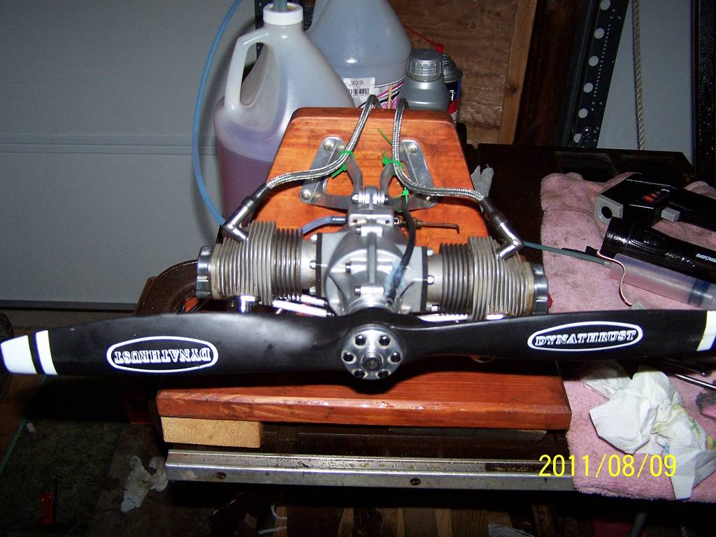

I would & do use the same oil I place in the oil sump. If I use Klotz in the sump...then its Klotz in fuel. If I use Mobile1in the sump...then I add Mobile 1in fuel. I change the oil about every 4th run. This engine will run with only 1 degree difference in temp from onecyl too the other. Made In Germany. Go tohttp://www.mecoa.com/kavan/index.htmfor more data.
Capt,n

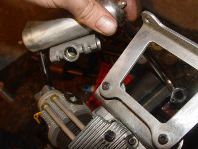

I see thath will need to change engine mount suport in other way because I need some space for the walbro.
I see carb suport was not well tightened, i decided to unassamble some part to fit itcorrectly

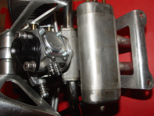

Finally carb support is ready i will use a Tillotson that for me is too much fine tah walbro.
IS our four strokes design ste modification with special STE valvle

I solved with 2 separators and a high resitant allen 8-32
