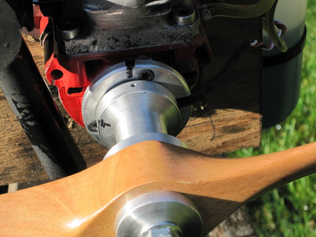

a bit more work than your usual saw conversion but fun nonetheless. will probably be a while before i get the ignition and carb sorted out in order to run it, not in any hurry as the plane i built the engine for is still in the drawing stages...

Very very nice. I would enjoy seeing any pictures of the crankcase machining in progress. What kind of mill? Rotary table ? You just plunged an end mill to make the lightning holes? For the ignition I would suggest putting the magnet on a ring that is secured with grub screws. This gives total flexibility on setting the timing, and just looks nice too.
RE: husqvarna 61 conversion
sorry, didn't take any photos while machining, i'm really bad when it comes to documenting stuff like that....if it wasn't for my wife i don't think we would even have any photos of our kids...
everything was done on a bridgeport including all the turning. no rotab, all the contouring was done with plunge cuts using "arc" function of DRO for coordinates. then just a bit of sanding with 400 grit and a polish with fiberglass insulation and WD-40. lightening holes were first drilled undersize and then bored with an endmill ground to cut a flat bottom with a slight radius at the corner.
magnet will just go straight in the hub. behind the hub there is a ring that's mounted on a bearing. hall sensor will be mounted there and connected to carb for ignition advance. this will also allow some adjustability for timing. hub has a keyway so timing won't be upset if i tear the engine down.
blog has more photos of the parts. quote my first post to see where it is, same username as here...

I used to move the sensor too. I found that often a prop hub will slip the first time you run it. I copied the idea of the fixed sensor and ring with grub screws from Ralph Cunningham. In the end it is less hassle and neater looking. Suit yourself, you are clearly a great machinist.
this one shouldn't slip:
was easy enough considering the crank already had the key slot.
i am going to use the collar method on a little engine i want to convert soon. it has the same crank set up as the G23: tapered and threaded nose with no key way.
and thanks but i think i have a way to go before i would ever consider myslef a machinist. i am enjoying the way there though!
