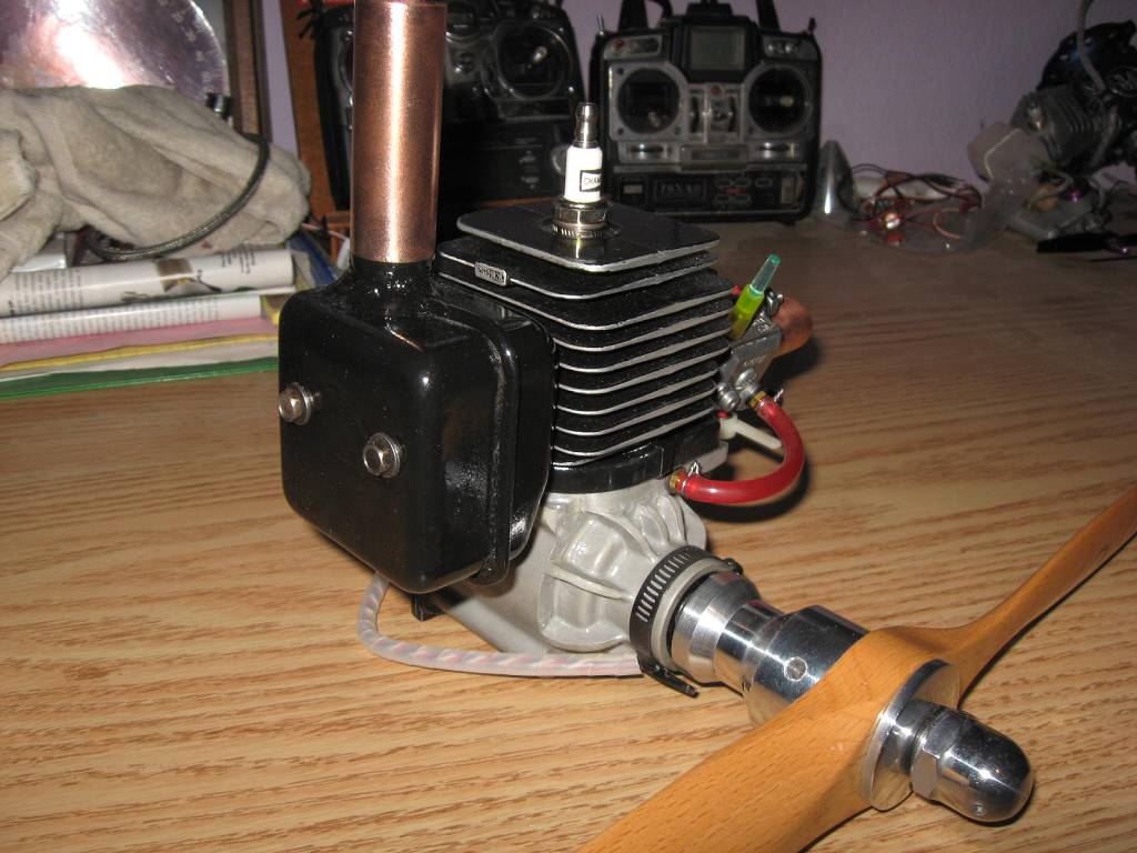

Hello,
Iwant to pull the magneto coil from an old homelite 25cc engine that has been converted to RC flight and replace it with an electronic ignition. Need some tips on how to proceed. Iknow where Ican get theelectronic components and what to do in general,except for one thing :What do Ido with the old flywheel? It has not beenmachined or anything and itwouldbe nice to get a newone with less weightbut if Icant find one, will the magnet that is currently embedded in the fly wheel fire the CDI ignition hall effect sensor at the right advance time? It has an aluminiumhub of sorts that is screwed on to the engine shaft. I could potentially put a magnet there but how can Iget the right position for the magnet?
Thank you in advance for your replies.
Ranga

I think that wackerengines.com has the parts to convert a engine over for you. They have Homelite engine conversion parts.
You basically need the prop adapter hub, a CDI unit with the timing sensor and magnet.
They use a small neodymium magnet with the sensor. The flywheel magnet is too big.
Basically you find top dead center. Then using a degree wheel, locate a convenient spot for the magnet and sensor. Maybe mounting the sensor first. Then place the magnet so that the sensor is about 28 degrees before top dead center (BTDC) as the magnet passes it. The sensor triggers on the trailing edge as the magnet passes by.

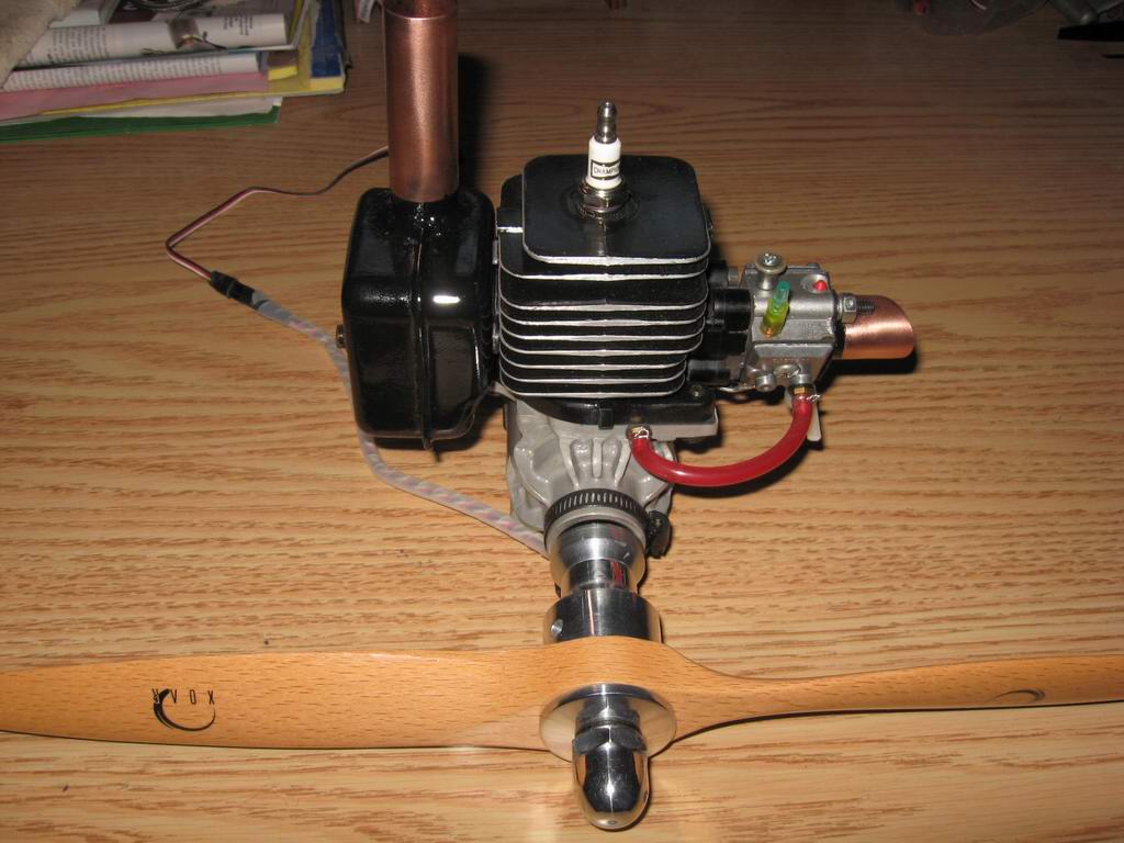

Yeah; www.wackerengines.com, www.lambertsrc.com, or www.carrprecision.com.
The prop hub for the CDI electronic ignition replaces the heavy magneto flywheel. A sensor is mounted on a large diameter hose clamp that clamps to the front bearing snout of the crankcase, and you can rotate it to set the timing.
I made the parts for my Homelite engine shown in the pics. Just posted them to let you get the idea how it works.

A couple of unrelated followon questions related to your picture (but not to my original question) :
You have a connection from the top of the carb to what looks to be a crank case vent (the red tube ). What is that?
Is the velocity stack on your setup positioned the way it is supposed to be when the aircraft is flying?

When I hop these engines up, I do a special mod to the intake manifold, and enlarge the ports. When I do so, the pulse hole for the pulse that operates the fuel pump in the carburetor gets very close to the intake tract, or in fact gets broken into. I fill the pulse port in the manifold adapter with JB Weld, and then provide for an exterior pulse to operate the fuel pump in the carb. That is the line on the engine in the picture that you asked about. As far as the velocity stack, yes, that is the way I recommend installing it; with the larger opening to the rear. People often think it should go forward to get some ram air effect, but the truth is ram air only gives about 1% more power at 100 mph, and usually causes problems with accurate carburetion. You don't want ram air.
