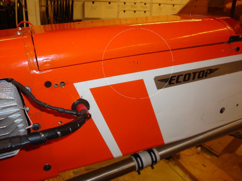

Here are a couple of pics of a carb fitted with the remote sensing static air line. The yellow tubing will go into the fuselage in an area of undisturbed air. This allows the carb to sense actual ambient air pressure and not the higher ram air pressure or prop blast pressure that is often present inside a cowling. It doesn't even have to be in a cowling to be problematic sometimes. If the installation ends up with the regulator cover facing the oncoming air stream while flying, or is in the prop blast, it can throw off your carb settings. It doesn't always happen; Bill from CH Ignitions calls it "black magic." Sometimes a remote static line isn't necessary. But if you are having problems with an engine running great on the ground but then going rich in the air, this is the first thing to look at. I generally just go ahead and install them on all my setups just to eliminate a potential problem area.
AV8TOR

Why not connect that remote static to static ports and get REAL static pressure?????????????????????????????????????????? ??

Yeah PE, you're probably right, but running the line into the fuse seems to work well enough, and saves the hassle of making a true static port.

Please define Hassle?
You mean this is much work?

Just to tell you that following the recomendation, I solder a tube into the pressure hole and run a tygon line from there into the fuse tank compartment.
All my problems were solved.....the engine gets easily tuned with just 2 turns of High and low needle,,,,,and never varies in the air giving me a great flying sunday with 7,800 Rpm on a 18x6 wood prop and very happy to finally being able to get my conversion engine completely ready, (and without noise given the tuned pipe and long header)
