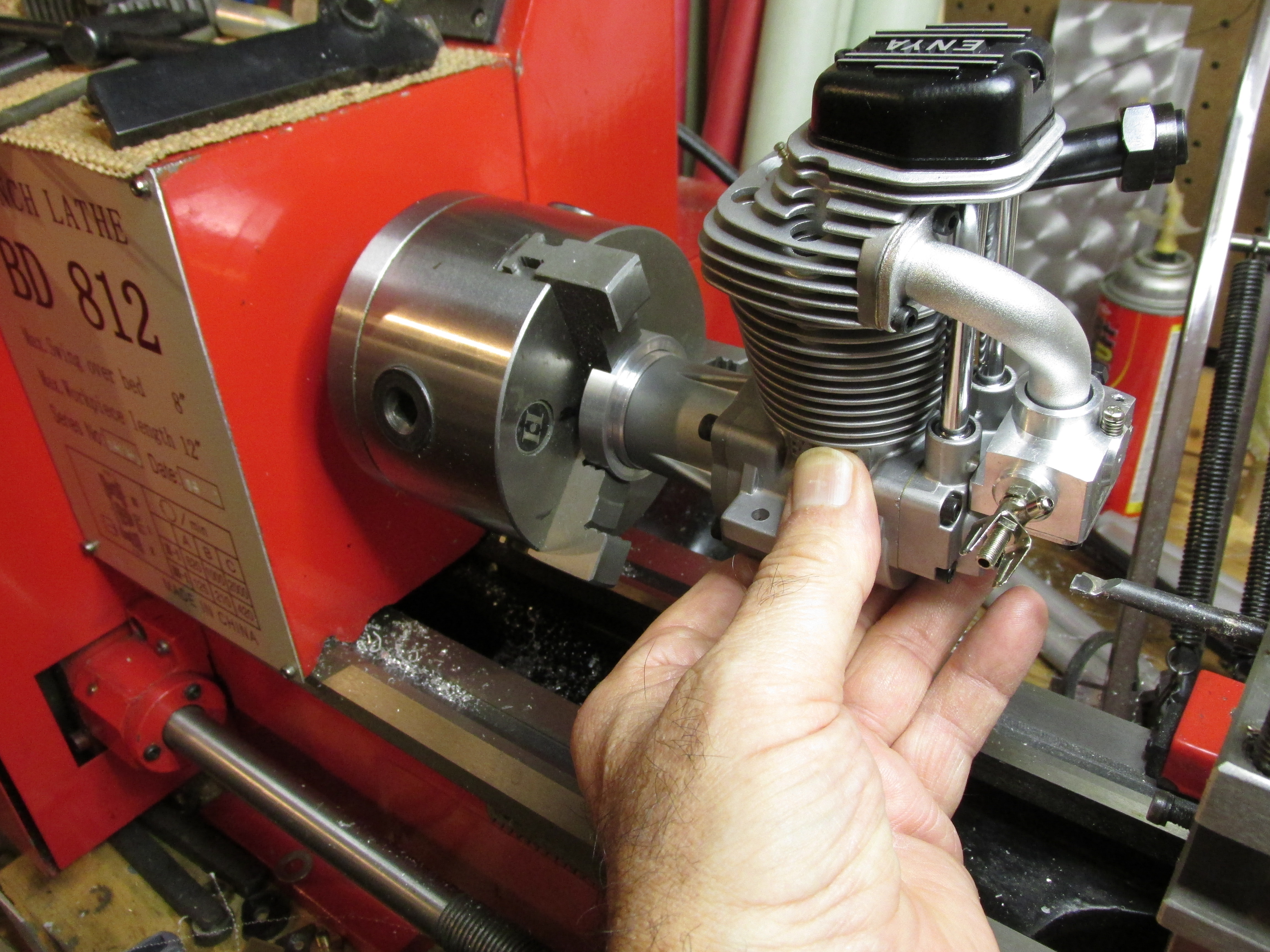

Make timing rings for the magnet. Install on prop hub. Use set screw for the ring to hold timing position. Easy to set timing any time you want.

Thumbs up Timing rings for adding ignition for about any engie
I will have 3 brand new engines to test run with new ignitions on them as soon as the weather warms up. One is a Bully 35cc engine, next a 1.50 Saito & last a new Enya 120 R engine. The Enya will be interesting indeed! Best Regards, Capt,n

The grade of the aluminum is not to important. The thickness is just thick enough too install a small magnet & small set screw. Another way is to use the flat aluminum washer back of prop. It would need to be knurled (both sides) so prop would not slip. If you can post a photo of the hub. Capt,n

That "V" groove commonly seen in prop hub drive washers is generally there for looks or weight reduction, and in some cases was meant to allow starting with a starter belt as is done with many boat engines. You can turn down the drive hub with a lathe, down to the diameter of the lowest part of the hub. (The bottom of that "V".) Then make a magnet hub/sleeve with the same i.d. to fit there, and with an o.d. the same size as the original drive hub; which is the same size as the front snout of the engine. Then the magnet will be at the same height of the front bearing snout of the engine, and either the hose clamp style CH Ignitions sensor mount, or the plastic sensor mount commonly supplied with RCEXL ignitions, will fit perfectly.
