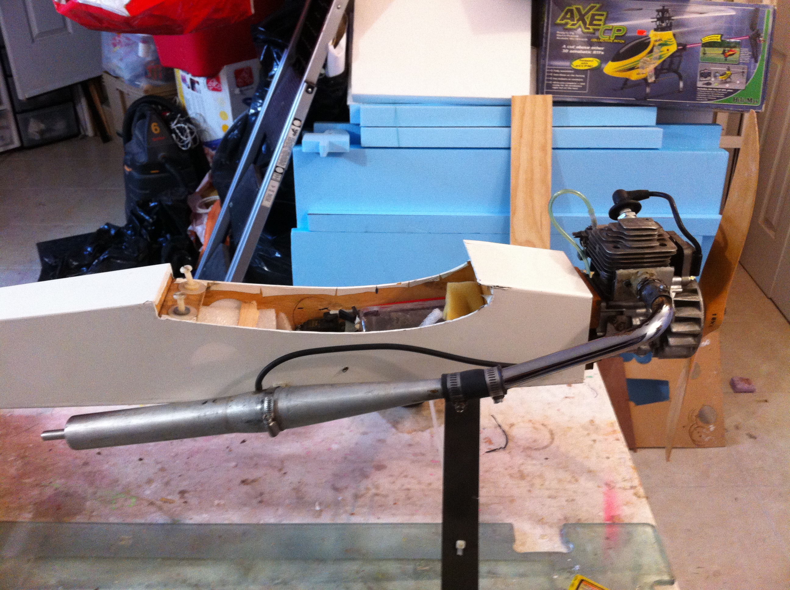

Hello Everyone,
I converted a mitsubishi 33cc
After a lot of experimentation, I added a walbro carb from a DLE 50cc and a tuned pipe of a 60 size engine and presurize the tank and the engine runs great, never had to move the needles again, great idle, great transition and getting 7,500 RPM with a 18x6 wood Turnigy prop.
I live in Mexico city so I fly at a very high altitude and I have received the recomendation that raising the compression ratio of theisse engines would be of great help specially on this altitude
Could anyone tell me hoiw to raise the compression ratio.
My objective would be to be able to use a 19x8 prop on this engine maintaining arround 7,500 rpm to get a better performance out of it
Thanks everyone.

You would replace the cylinder gasket with a thinner one.

Here is a thread I started about Homelite 25cc modifications. A lot of it will probably not apply to your Mitsubishi, but the part about lowering the cylinder will.
Click here: http://www.rcuniverse.com/forum/engi...c-hot-rod.html
Read through all of it so that you understand that lowering the cylinder to increase compression will decrease your exhaust and transfer port timings. They will need to be ported, or at least the exhaust will, to gain back the lost timing. I often leave out the cylinder base gasket to increase compression, and just use a good sealer instead of the gasket. You must be sure to check the piston to head clearance though.
Whomever told you a higher compression ratio would help at high altitudes was correct. You can also try advancing the timing a couple of degrees.

Thank you very much, I will try leaving it without the gasket.
For advancing the timing If I recall correctly, I need to open up the exhaust on the top of it righ
Thank you very much.
Víctor.
Old 02-05-2014 | 07:11 PM
av8tor1977's Avatar
Joined: May 2003
Posts: 7,245
Received 6 Likes on 5 Posts
From: Tucson, AZ
Yes, take material from the top of the port, and do it a little at a time and keep measuring to make sure you don't go too far and take too much. A good timing figure is usually around 150 to 155 degrees. Using a tuned pipe, you might experiment with a higher exhaust port timing though. Make sure to chamfer the edge of the port so it does not have a sharp edge to damage the piston and/or ring after modifying the port.
