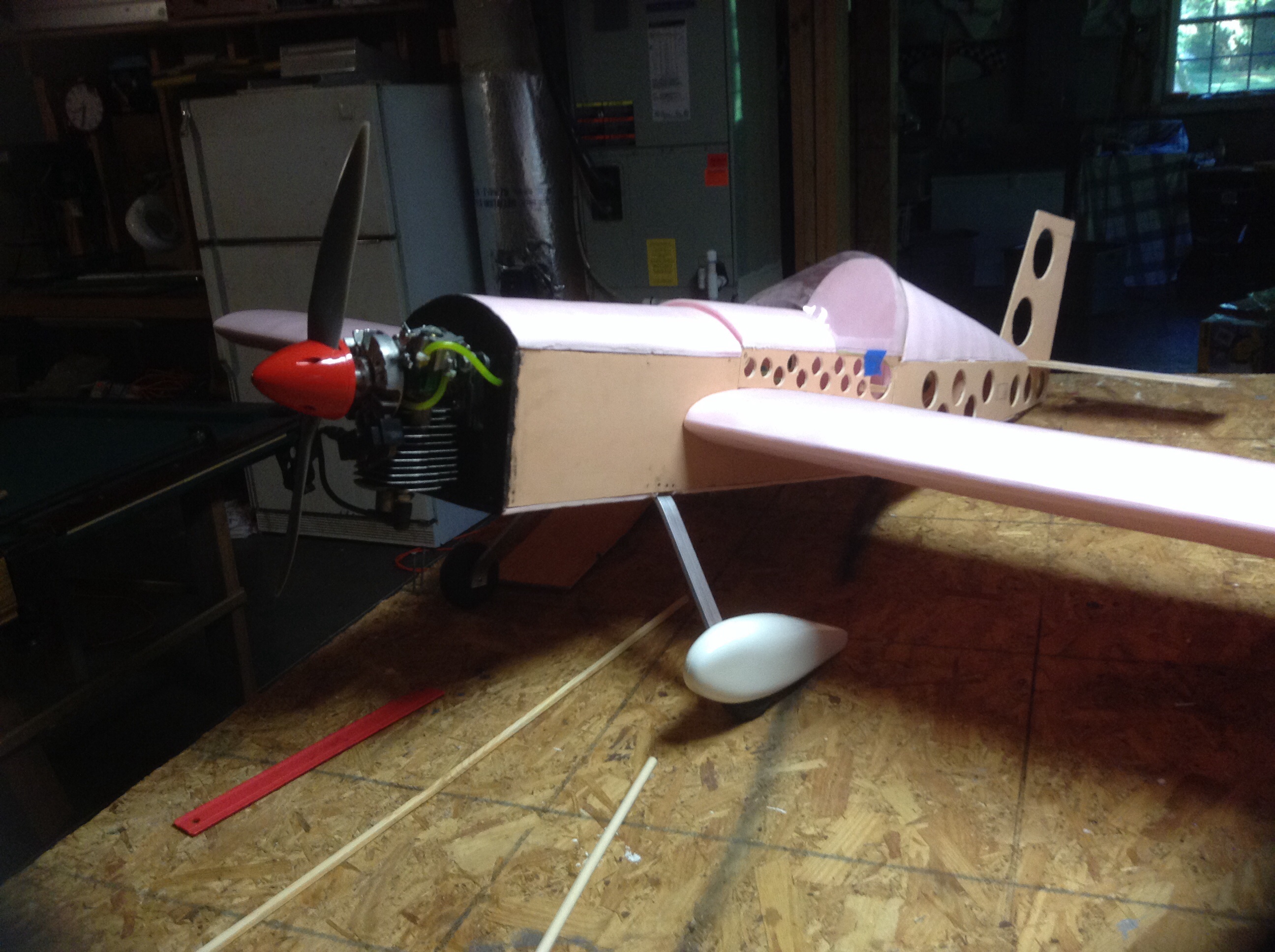

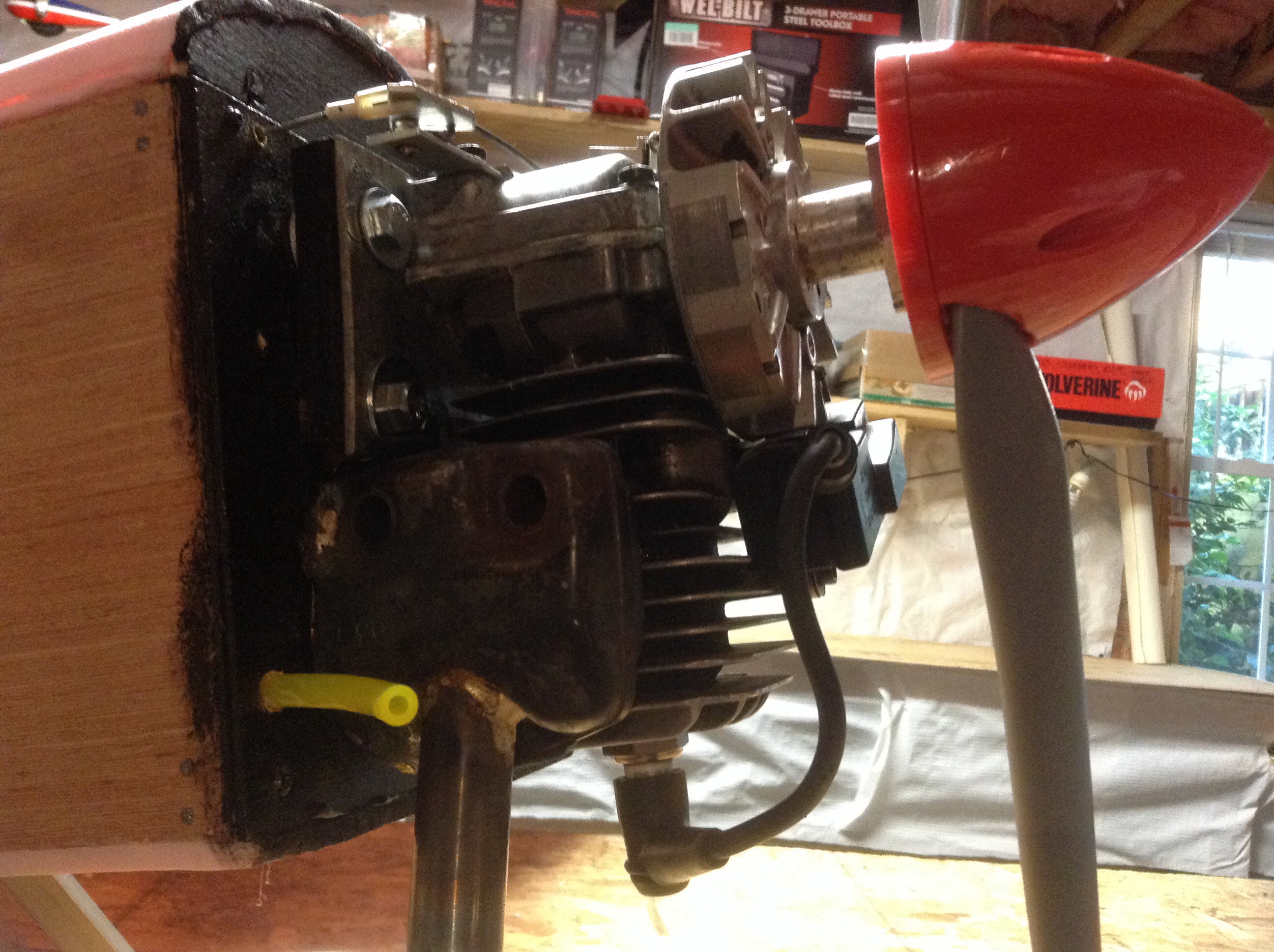

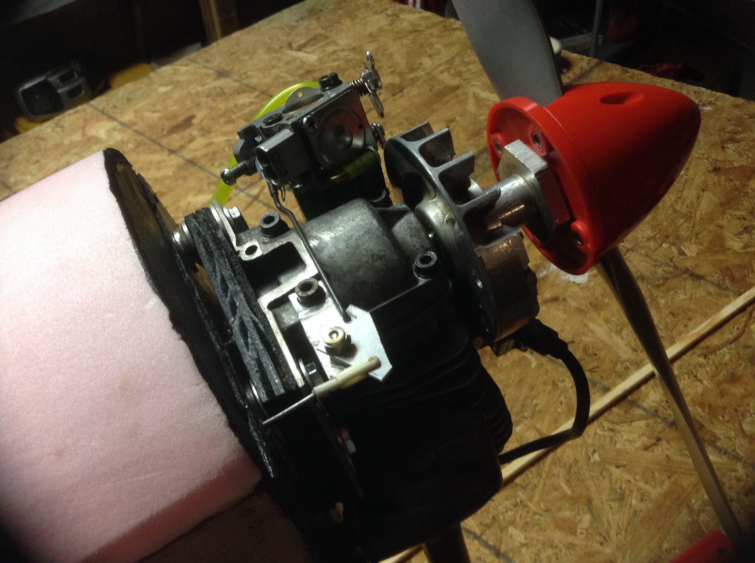

Here is a husqvarna chainsaw I converted. Gutted the muffler and brazed a pipe. It swings a APC 18 x 8 W at 7500.The engine weighs 3 pounds 12 ounces, ready to go.

Finally flew the plane with this engine on it, the rpms got better it runs at 7900 with the same prop. The plane weighs 15 lb. The power is excellent, not unlimited vertical but more than enough for sport flying. Here is a video my brother shot of the first flight.
