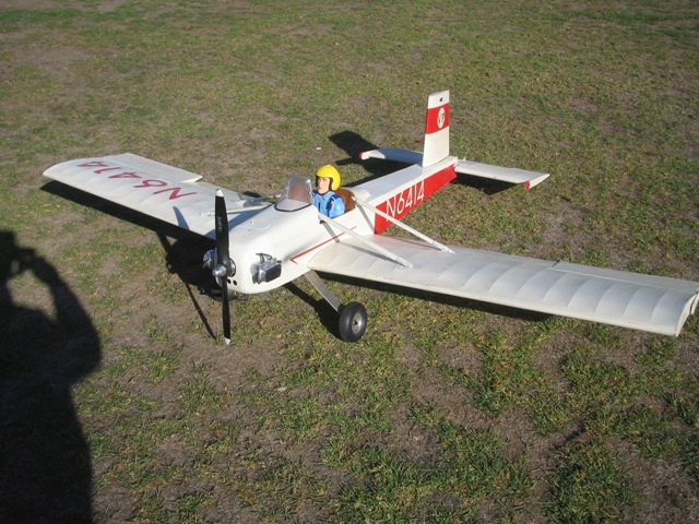

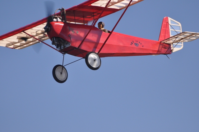

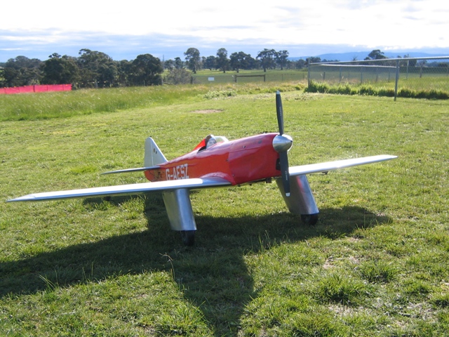

Old 03-16-2015 | 03:32 AM
cutarug's Avatar
Joined: Jul 2006
Posts: 112
From: Melbourne, AUSTRALIA
I would like to get my hands on a four stroke Stihl, what is the motor from, I could check out the local mower repair for one, is it out of a weed trimmer? I have attached a picture of my Volksplane 1/3 scale powered by a ryobi and also my Sparrowhawk with a Ryobi also. The Pietenpole is 1/4 scale with an old OS 120 inclined rocker. I will post a phot of the D7 when it is more advanced in construction.

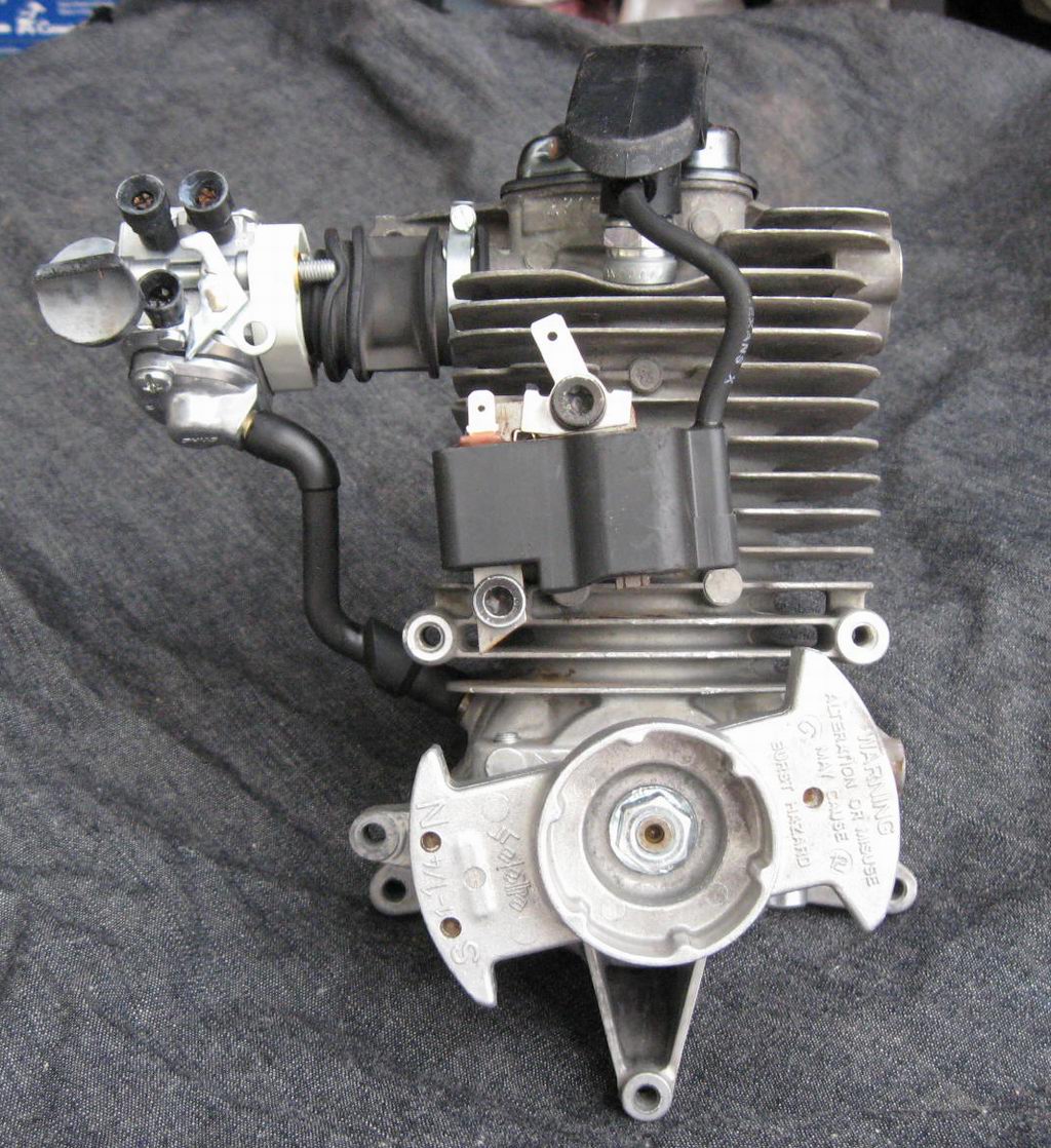

Old 03-16-2015 | 12:35 PM
av8tor1977's Avatar
Joined: May 2003
Posts: 7,245
Received 6 Likes on 5 Posts
From: Tucson, AZ
Those Stihl Four Mix engines are hard to come by, and very expensive to buy either the engine or the machines they come in. I have a bunch of Stihl 65cc Four Mix engines I would like to sell cheap because I have too many projects and am going in for back surgery soon and won't be able to work for a long time afterwards. I also may lose this place I am living in and a lot of stuff might have to be stored, so I am "cleaning house". If you are interested, send me a Private Message.
Here are a couple of videos of a guy flying a Stihl 65cc Four Mix he bought from me: https://scotplanes.shutterfly.com/pictures
The Stihl Four Mix engines are very powerful for a four stroke engine; almost the equivalent of the same size two stroke. They also can be mounted and flown in any position as they have no oil sump. (Makes them lighter too.)
