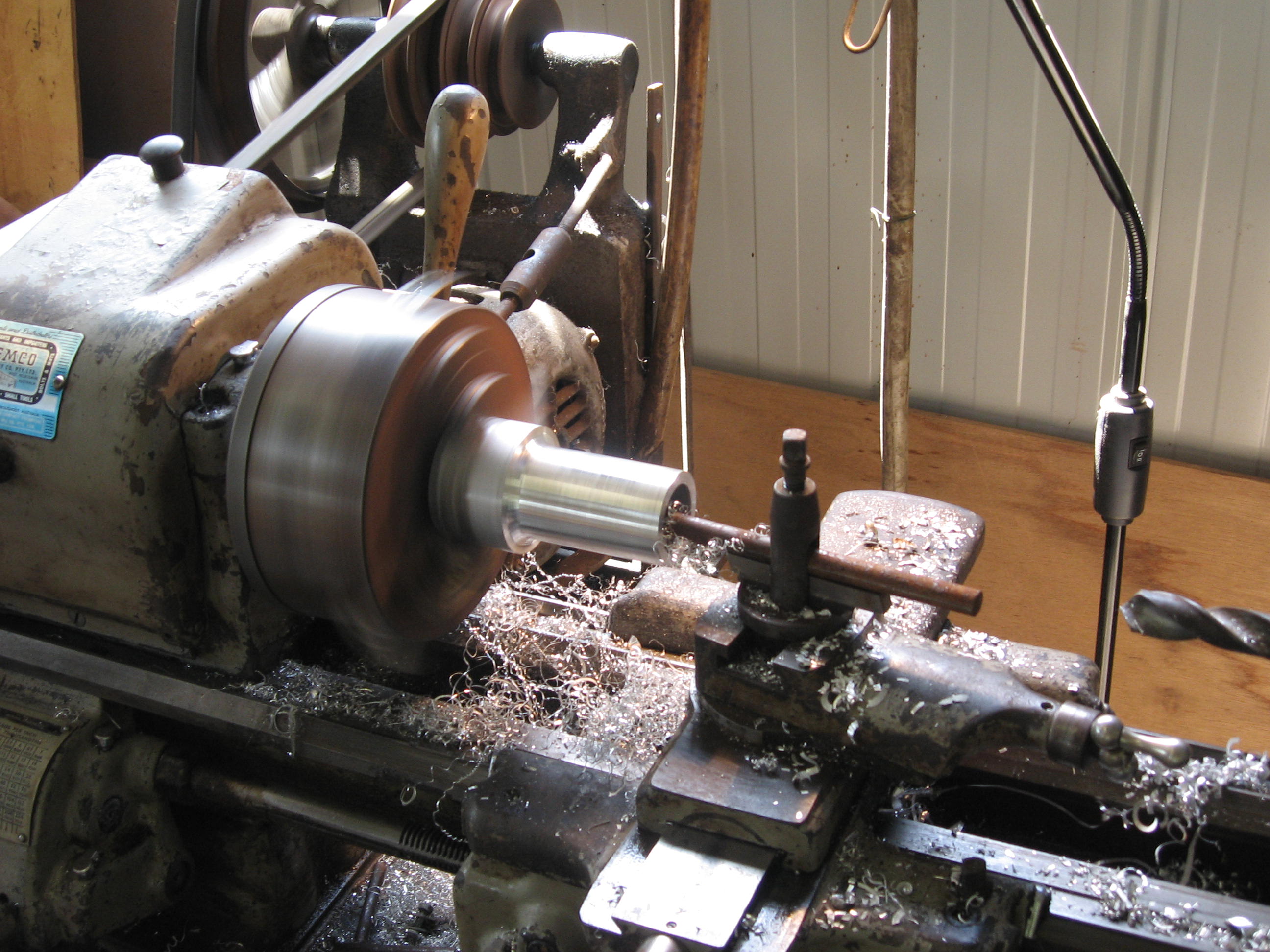

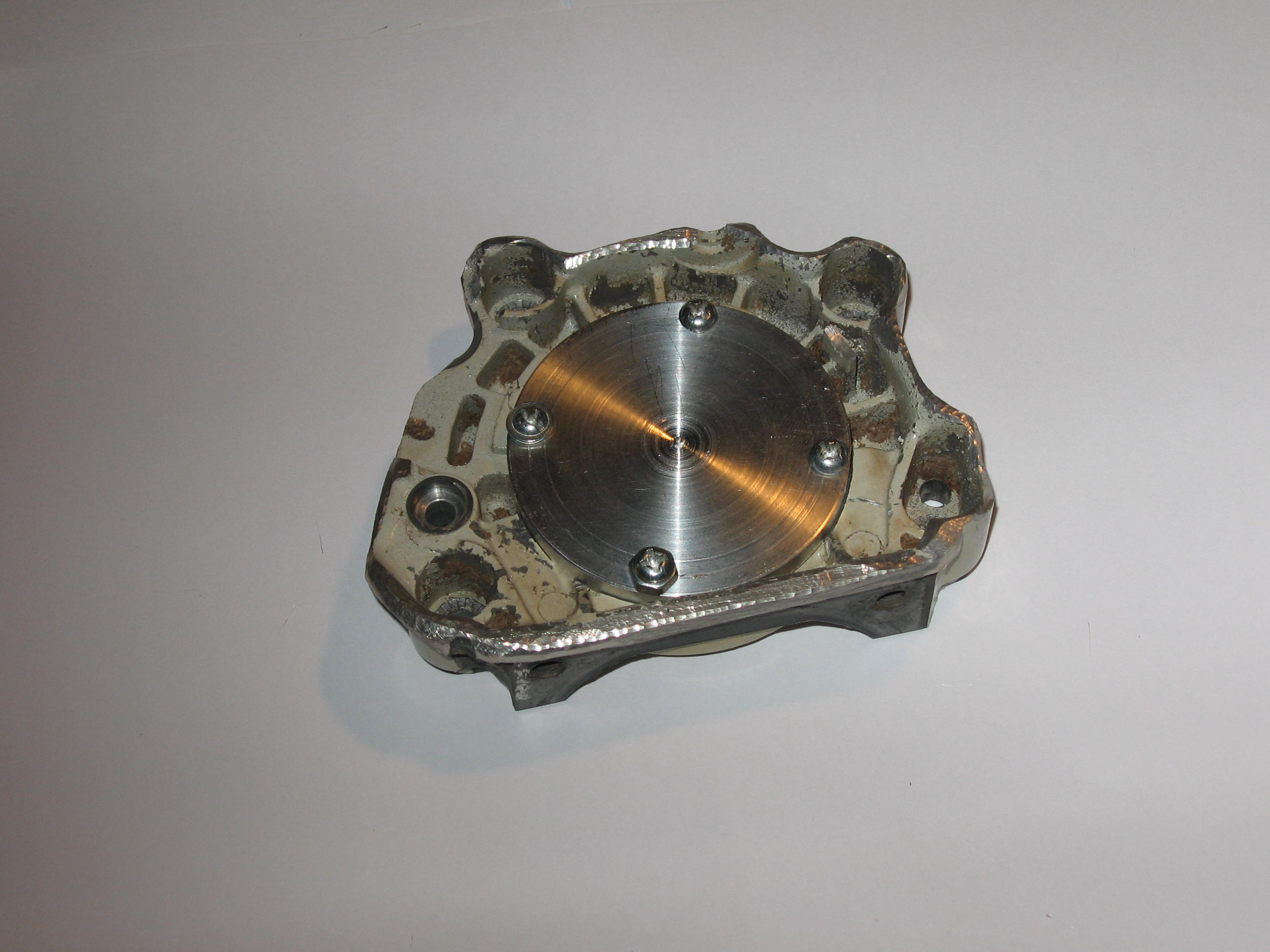

Default First engine part machined
I've started the machining work on our local Mens Shed lathe. It is an old Australian made lathe, made back in the Aus manufacturing heyday and is a suitable size for the kind of work I will need it for. I made my very first engine part; the bearing retainer and crankcase end cap. I just need to find some high tensile bolts to replace the soft ones I have in it temporarily. I also started to machine the intake manifold, but could not find a parting tool to cut the part off the bar stock.

Looks like an old prewar South Bend lathe common instuitional lathe of the era in the USA

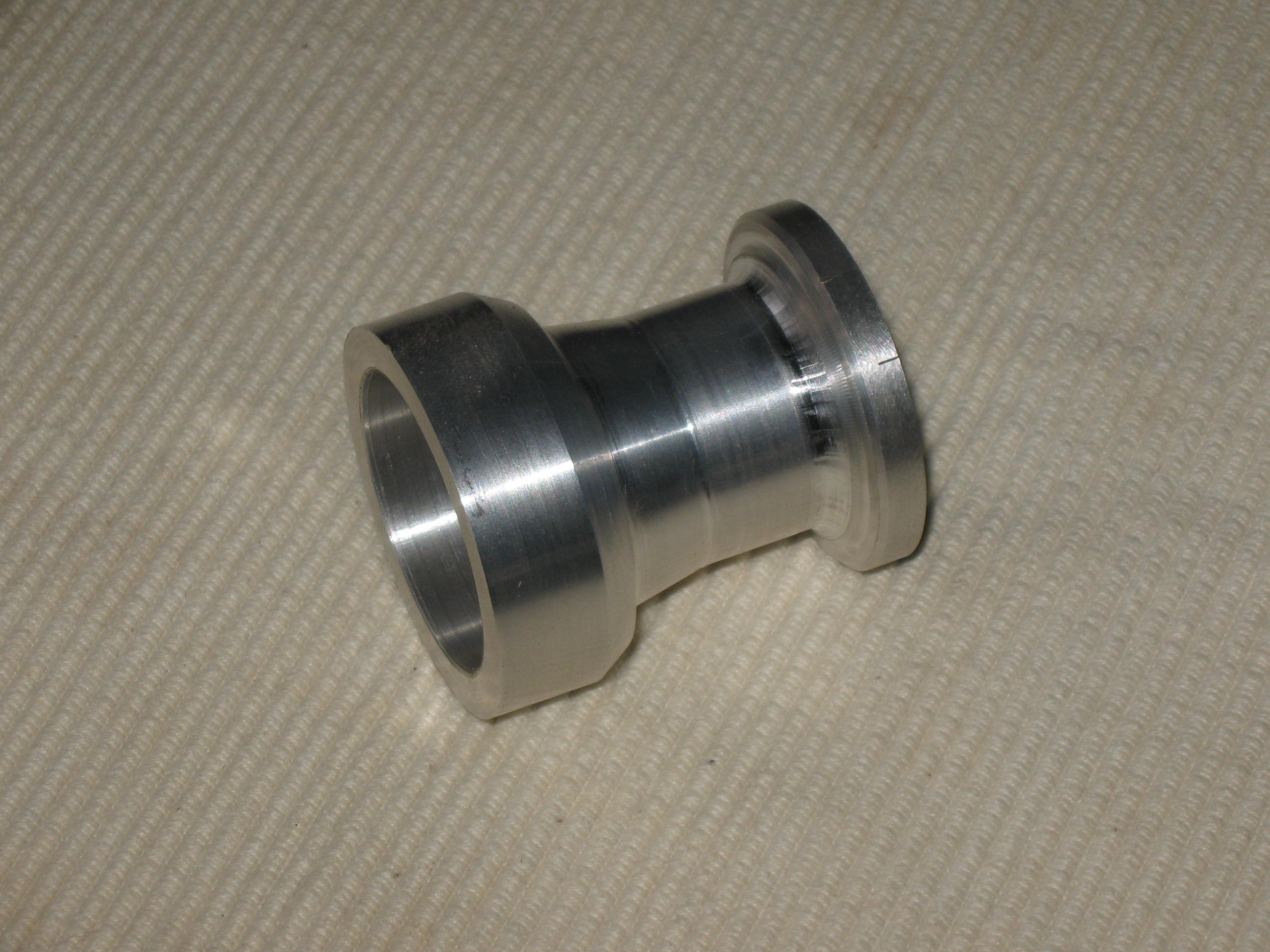

I finished machining the intake manifold yesterday. It's only second part to made on a lathe. The finish machining is a bit rough, but it will plenty good enough for the task. It's ready for drilling and tapping for the retaining grub screws and the carburettor bolts.
I need to find some suitable material to use as an insulator between the carb and the manifold.

for what you're doing a piece of 10mm G10 would work for the insulator. another material is that phenolic panel stuff often used as dividers in public restrooms....i imagine that might be easy to find at a recycling/junk yard.
