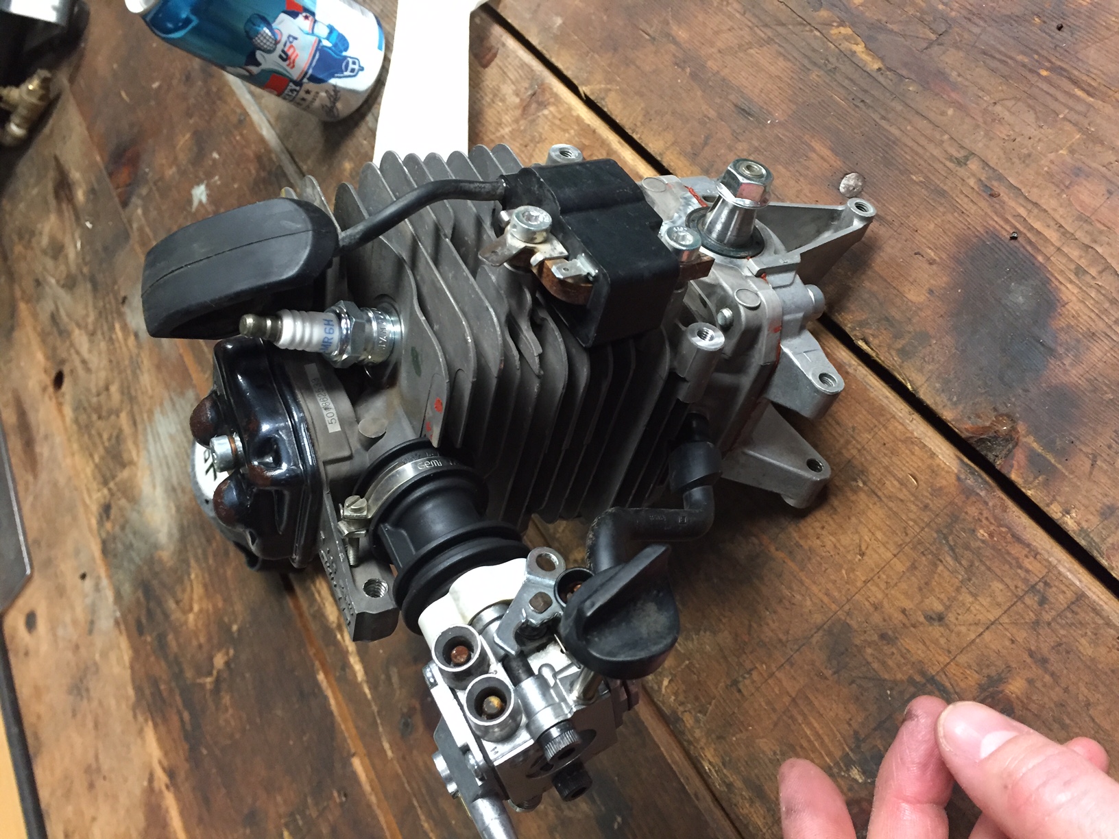

I need a prop adapter for a stihl 65cc 4-mix engine Anyone have one or want to make one to sell? Thanks Kevin
Old 12-23-2015 | 10:41 AM
  #82
Joined: Feb 2014
Posts: 87
Whats a 4 MIX engine? Does it have a 5/16" 24TPI thread? Post a picture of what your looking for. I can make you one.
Larry Kopecky
Conyers, Georgia
Old 12-23-2015 | 10:53 AM
  #83
Joined: Feb 2007
Posts: 82
From: Hilton, NY
Larry, It's out of a stihl br600 back pack blower. It's a 4 stroke engine that runs on mixed gas. I have not measured the crank thread yet, But I think its 11mm (odd ball). email me at this address. [email protected] and I can send you some pics. (I can't see how to add them here) Thanks Kevin
Old 12-23-2015 | 10:58 AM
  #84
Joined: Feb 2007
Posts: 82
From: Hilton, NY
Lets see if this worked (the first photo is where the flywheel goes)

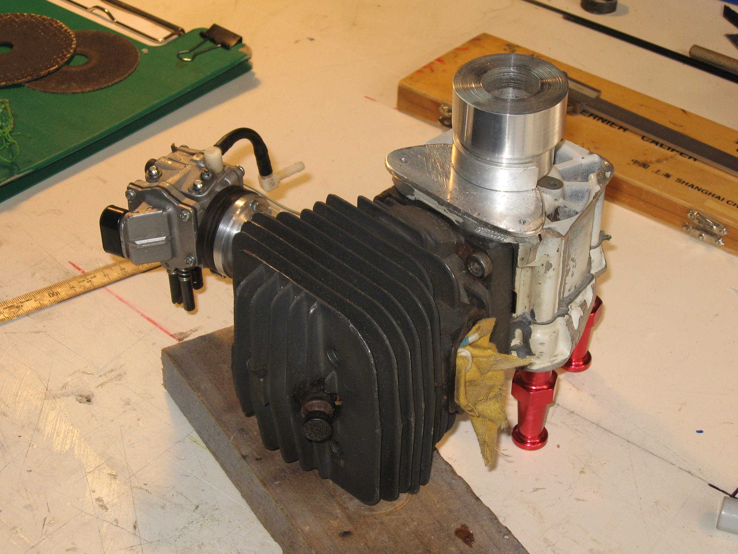

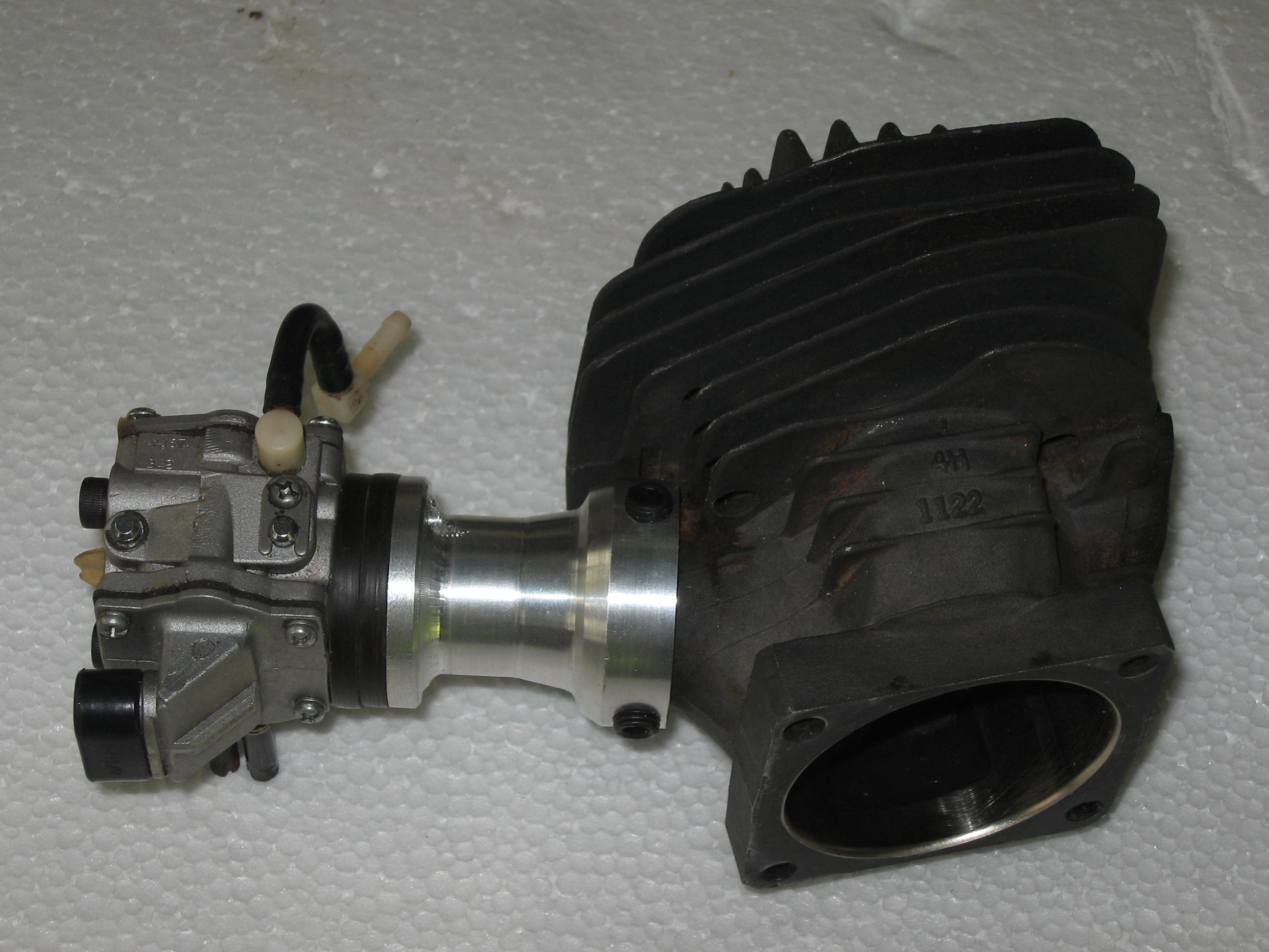

Hi Kevin. Do you realise what is meant by a thread highjack? I think your posts above constitute one. Try opening your own thread with a descriptive title and you will received more responses and I will have my thread back on the subject of this engine build. No offense implied.
Meanwhile I have made some progress with the machining of the engine parts. The pictures speak for themselves, so to say. The only one that has me a bit intimidated is fitting the centering spigot/plug to the prop drive. It fits very nicely for part of its length, but won't go in further without some force; I am reluctant to push it, as it might pick up the soft aluminium and create more of a problem. I did try spinning it in the lathe with a piece of 100 grit sandpaper on my finger, but did not seem to take out sufficient to alloy the plug to go all the way in. I am very reluctant to chuck it up again and machine more out of it, but cannot see an alternative at this stage. So far, all the machined parts I've made have been serviceable on my first attempt. I've surprised myself with the good results!
Any ideas for this?
It seems like my internet link is not working well enought to accept pictures; I will post them later, maybe in the morning.
Name:	Engine mountings.JPG
ID:	2137533   Click image for larger version
ID:	2137534   Click image for larger version
Name:	Stihl intake manifold.JPG

maybe removing the hub from the mandrel put a scratch inside? air not escaping due to oil on the parts? that would feel spongy and not a hard stop though.
is the plug steel or aluminium?
and what wall thickness do you have on the rear end of the hub where it was turned down?
Old 12-27-2015 | 12:57 PM
  #87
Jim.Thompson's Avatar
Joined: Sep 2015
Posts: 444
From: Bellingen NSW Australia
The plug is aluminium. The same grade as the prop hub.
The wall thickness of the hub is 3.5 mm.

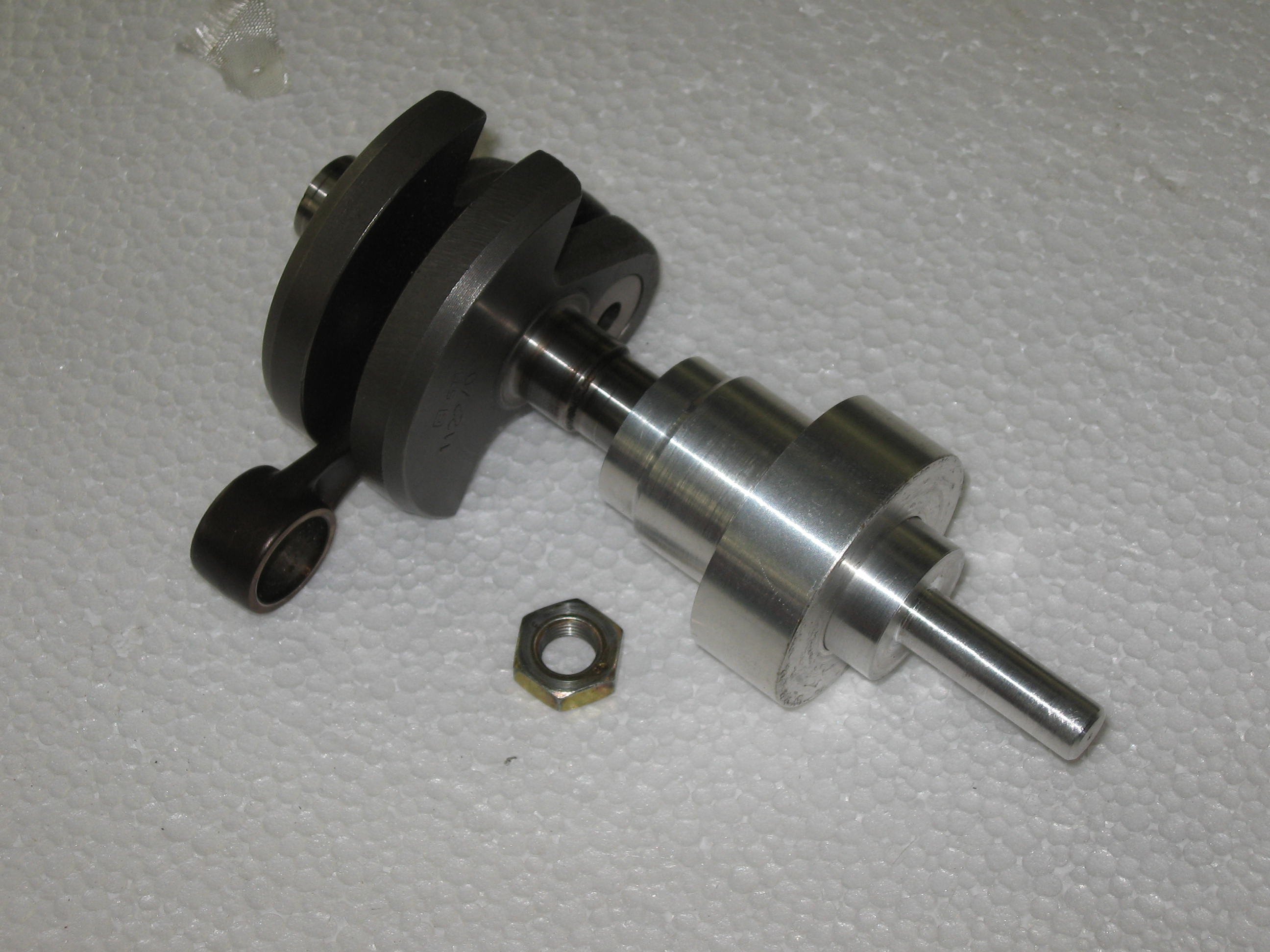

The crankcase has been assembled with the new bearing and seal. The engine mounting standoffs (ex Hobbyking!) seem to be good and are now fitted on the crankcase studs. Locktight on all threads.
I have to machine up a mounting disc on which to mount the CDI hall sensor. Also, I have to machine up a prop retaining plate to go on the front of the prop through which the retaining screws will pass.
Getting close to completion now. Might be ready for a bench start up in a week or two!
Question:
Is cheap vinyl tubing suitable for the line from the crankcase to the carburettor?
Name:	assembled crankcase.JPG

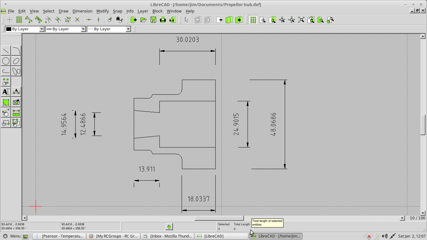

I will try to post a screenshot of the revised drawing. I'm not sure it will work, as I have a file permission problem currently in my operating system.
But here goes:

there have been quite a few hub failures with the cheap RCGF engines where the wall thickness was around 2mm. these are smaller engines from around 20cc to 45cc and no idea what alloy was used.
it's not all about the power being transferred but HOW it's being transferred....a sharp hammering pulse every revolution.....constantly accelerating and decelerating. if the carb is out of tune that hammering can get much worse. and then on the other end a big stick that will never be perfectly balanced statically or dynamically and constantly fighting gyroscopic forces as well. a good comparison is how the sockets designed for use with impact wrenches have a much thicker wall even though the final torque being applied might be much less than with a regular ratchet handle.

You have convinced me Zagnut. I will machine another one.
However, the only thing I would question is your comment @ post #89 regarding leaving the hub at full diameter for its length. That seems a bit excessive to me, but I welcome further clarification and comment. I might get access to the lathe again tomorrow and if I have enough stock left, I could machine another one then.

if you neck it down to 40mm then you're only saving ~40g....and then you have to worry about where the holes for your prop screws are going to end up.
with the rear of the hub at 32mm like it is now you would not want to drill past your 18mm thick flange and that means messing with blind holes.
easy way to avoid the mess of tapping blind holes for the prop screws is to go all the way through (front to back) with the 5mm hole and then from the back of the hub counterbore with a 6.5mm bit leaving about 15mm of 5mm hole at the front for tapping for your M6 screws. to do this with a 35mm bolt circle you would need the hub to be no less than 44mm......may as well leave it at 48mm for the whole length.

I was able to get back to the lathe and machine up a good hub following the drawing above. Half way though machining the taper, I realised why I was having such difficulty with the taper changing each time I did a very slight cut. The transverse slide on the tool carriage was wobbling! It has a good .5 mm slop from side to side which made the angle I was setting (and constantly changing), variable and somewhat arbitrary. I became aware of this just in time to save this hub (attempt #3) and to machine the taper with a clamp on the cross carriage to hold it in the same place each cut. In hindsight, this is why attempt #2 was a failure.
I am assuming there might be some kind of backlash adjustment on the slide for this sloppy carriage. If not, we will have to investigate some repair or other.
I have been working on a mock up of the pickup hall sensor mount. Alternatives are to make it out of welding grade aluminium and get a proffessional to weld it for me, or to make it in steel and weld it myself. I need extra weight up front anyway.
This is purely an academic question: Could the propellor hub be made out of steel? This model will need more weight anyway, so if it would be suitable, and I was doing it again, I would do it in steel.
I'll post a picture later; the site is not cooperating at the moment.
Name:	Hub and hall sensor mount.JPG
