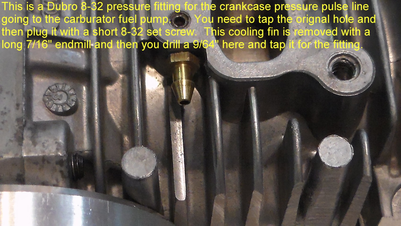

Ultimate 42CC Wildthing Conversion
Old 12-30-2016, 10:42 AM
Larry882
Join Date: Feb 2014
Posts: 87

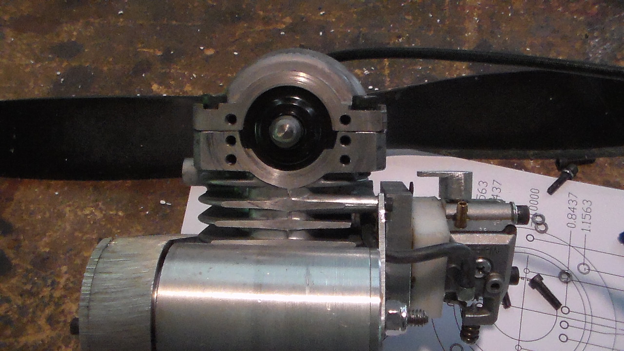

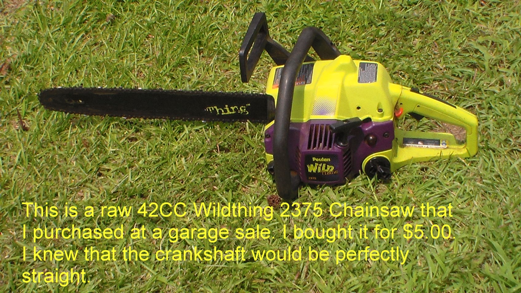

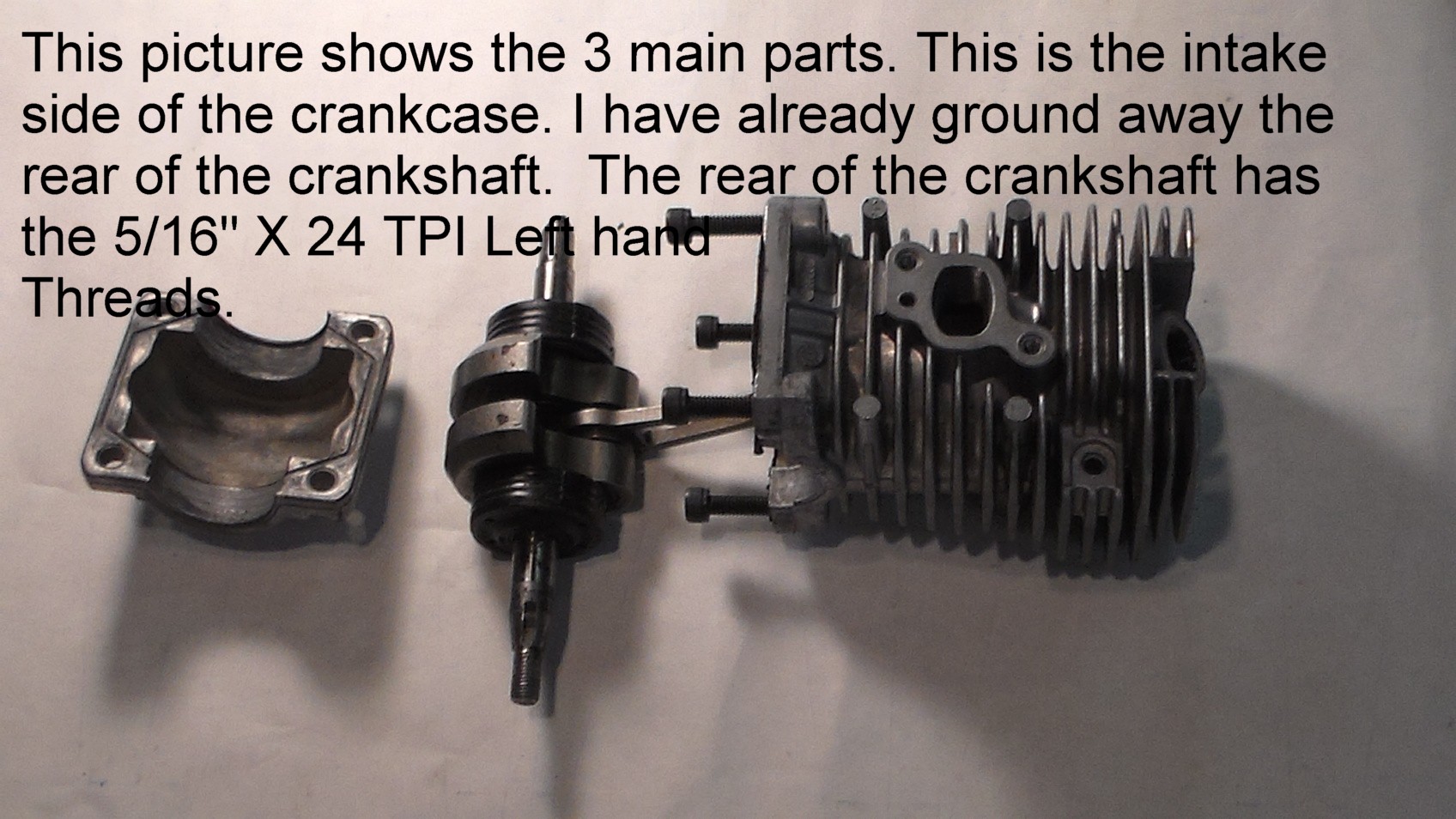

Default Ultimate 42CC Wildthing Conversion

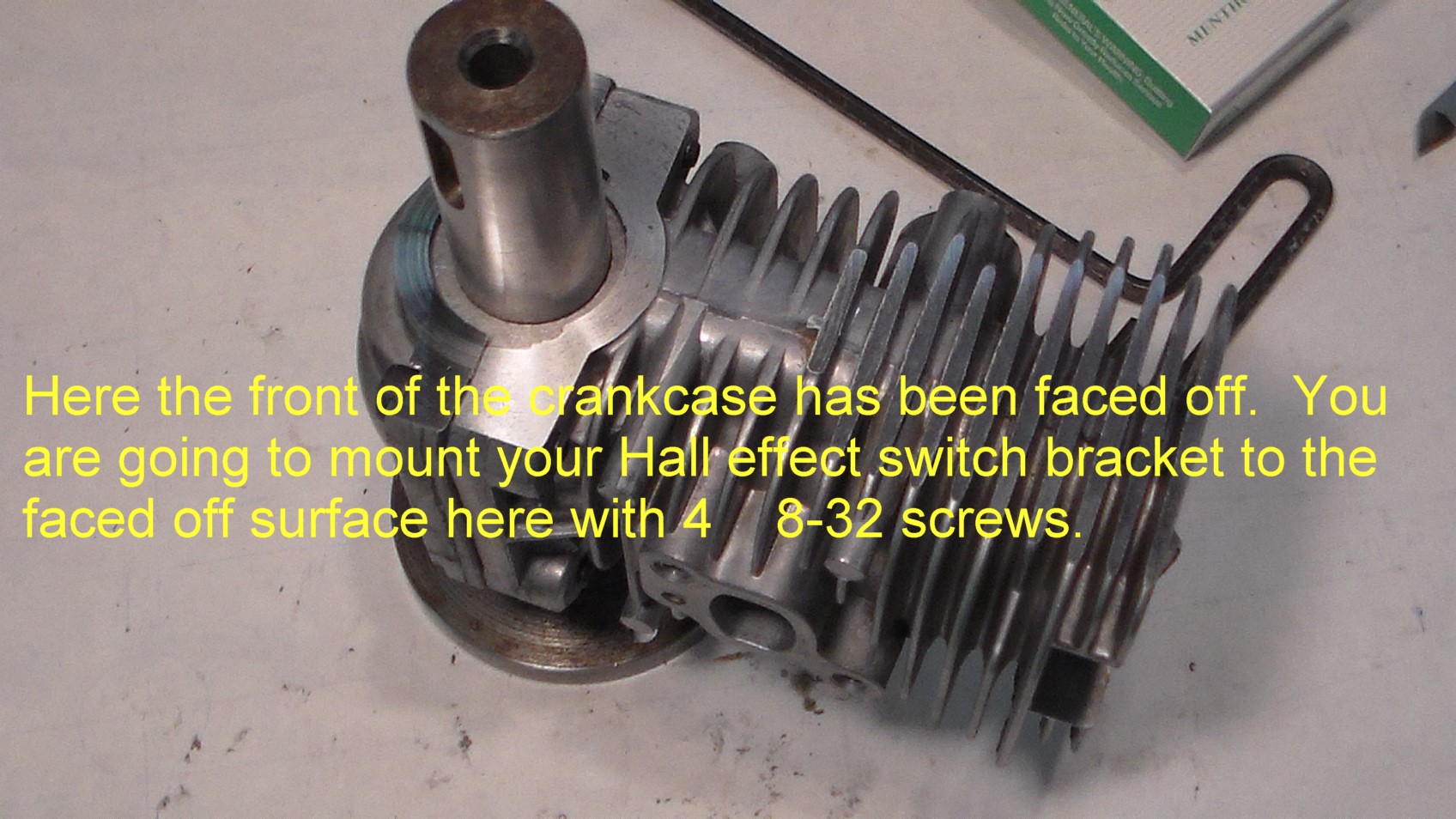

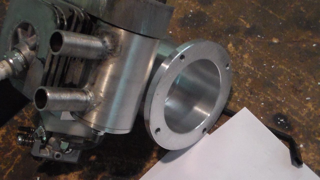

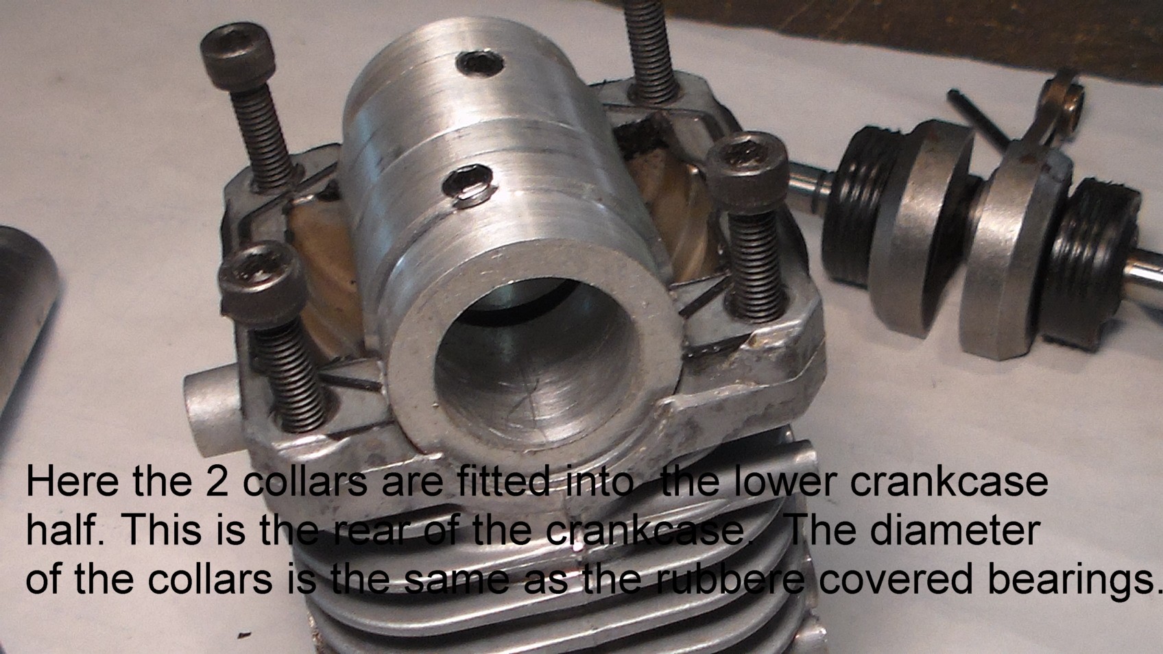

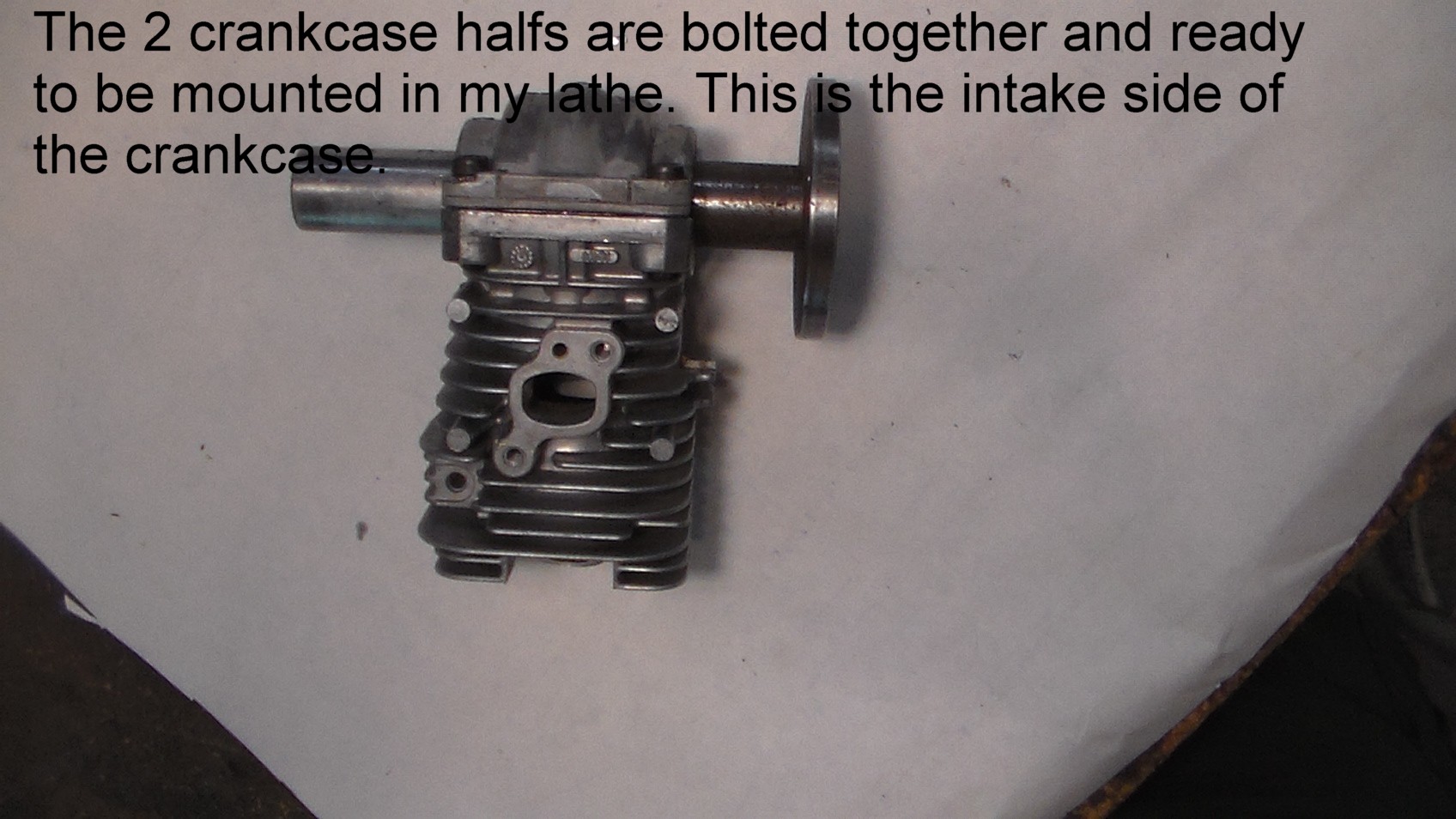

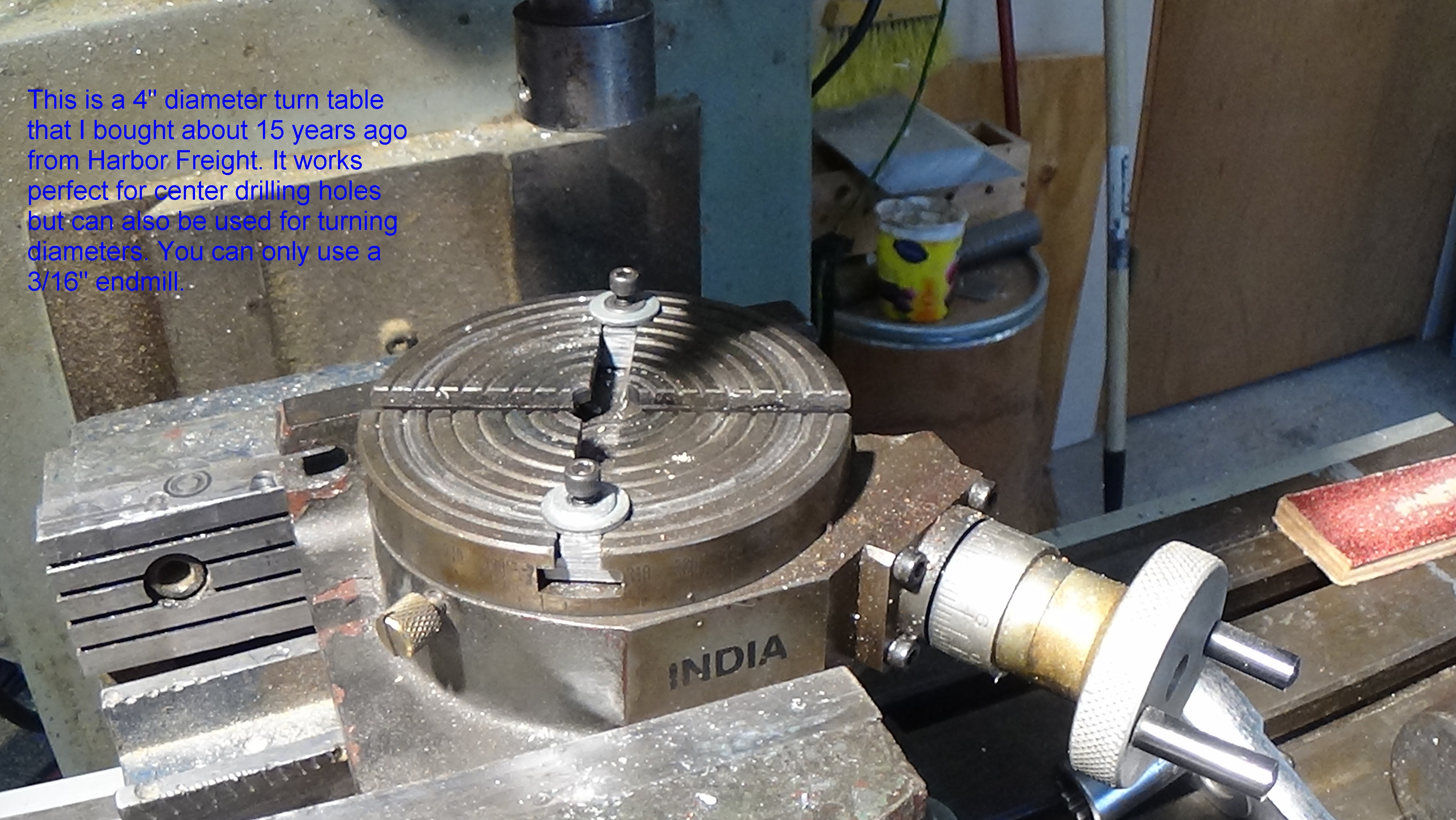

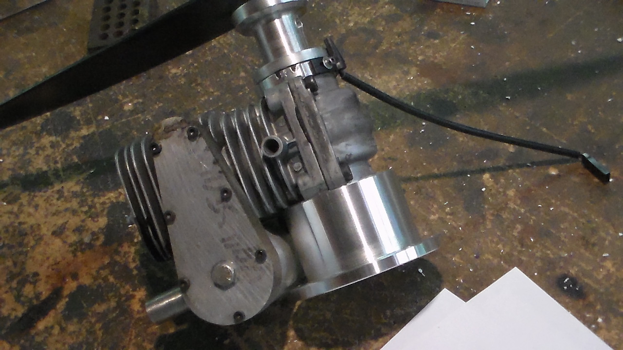

This thread shows all the steps and setups needed to convert a Pouland 42 CC engine for Rc use. I'm pretty sure that this information can be used on a 33 and a 46 also. I have also don a Stihl 64 CC the same way.

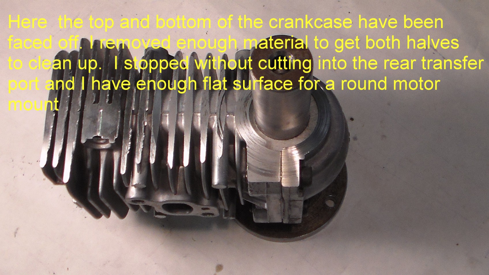

Old 12-30-2016, 11:20 AM
Larry882
Join Date: Feb 2014
Posts: 87

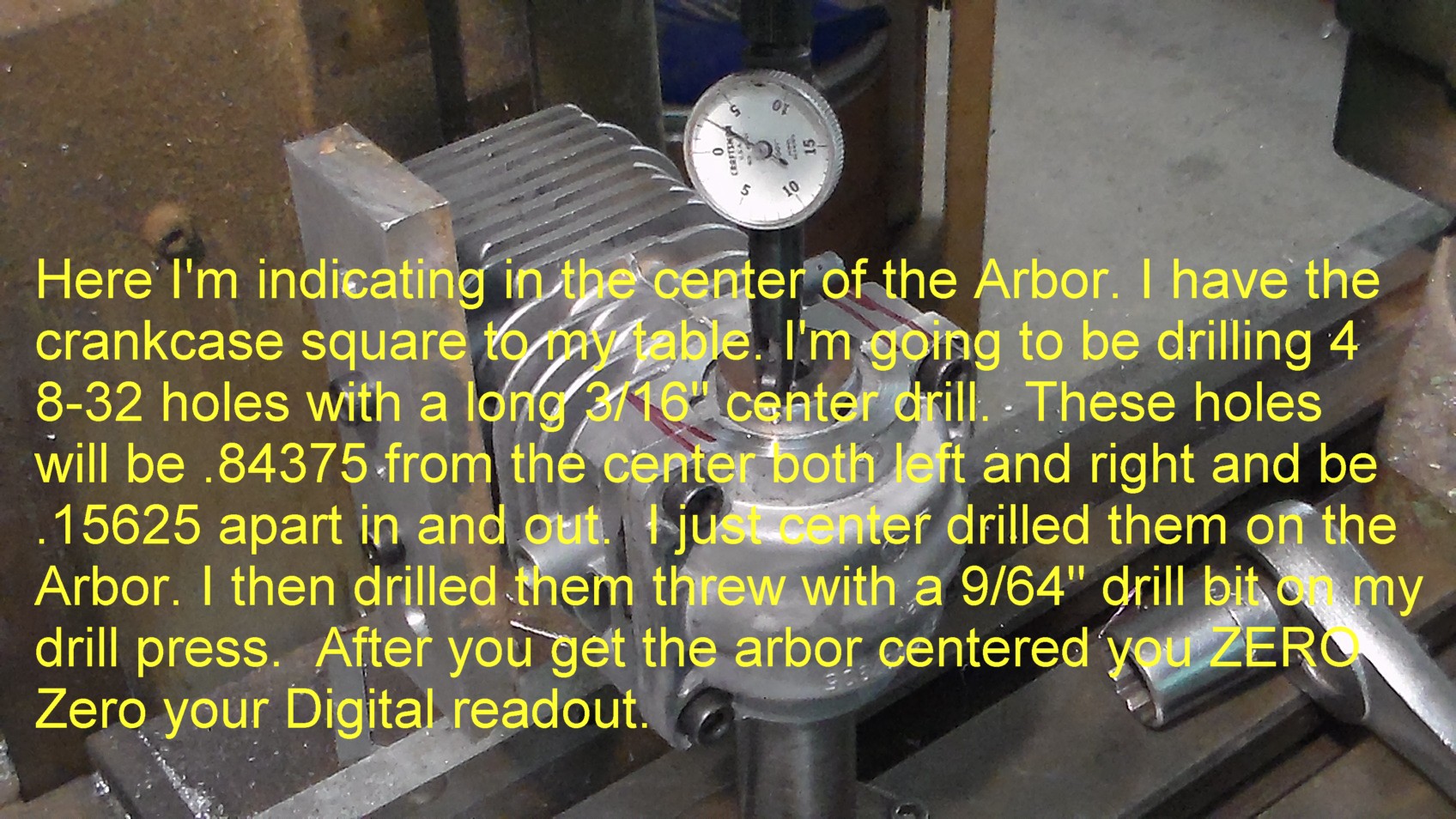

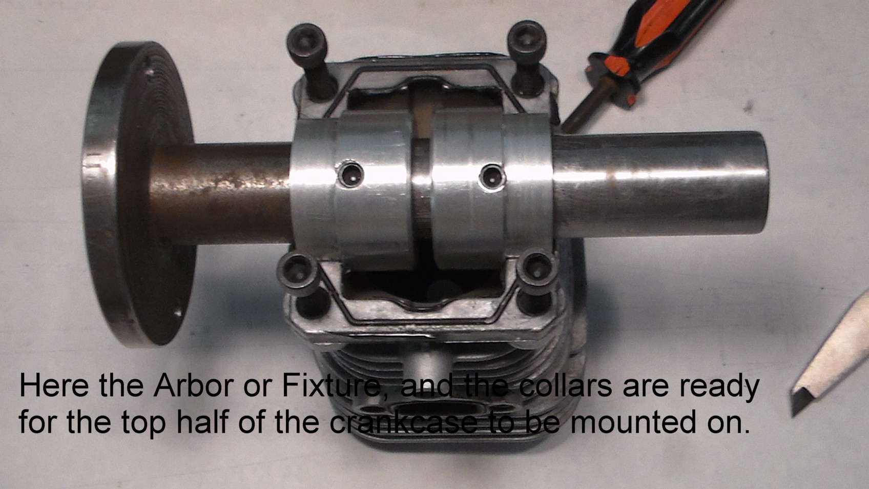

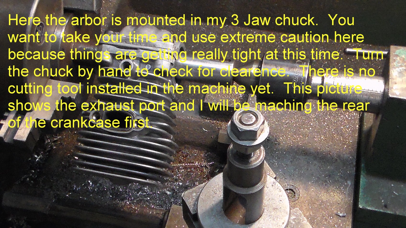

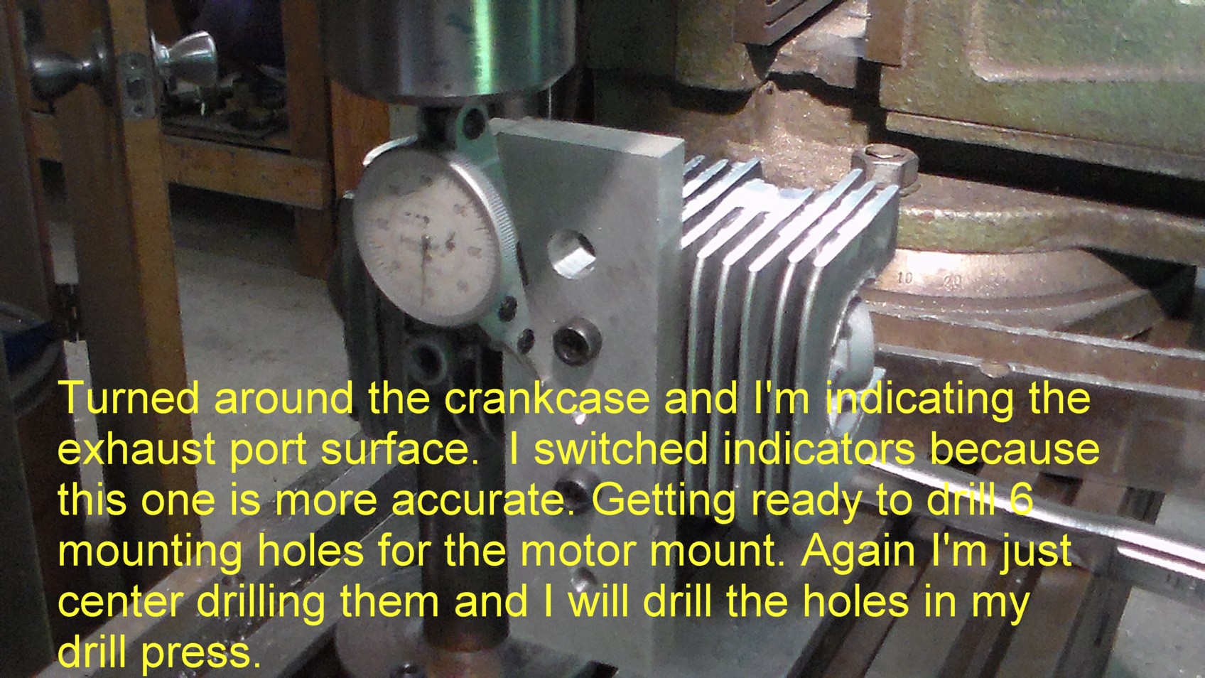

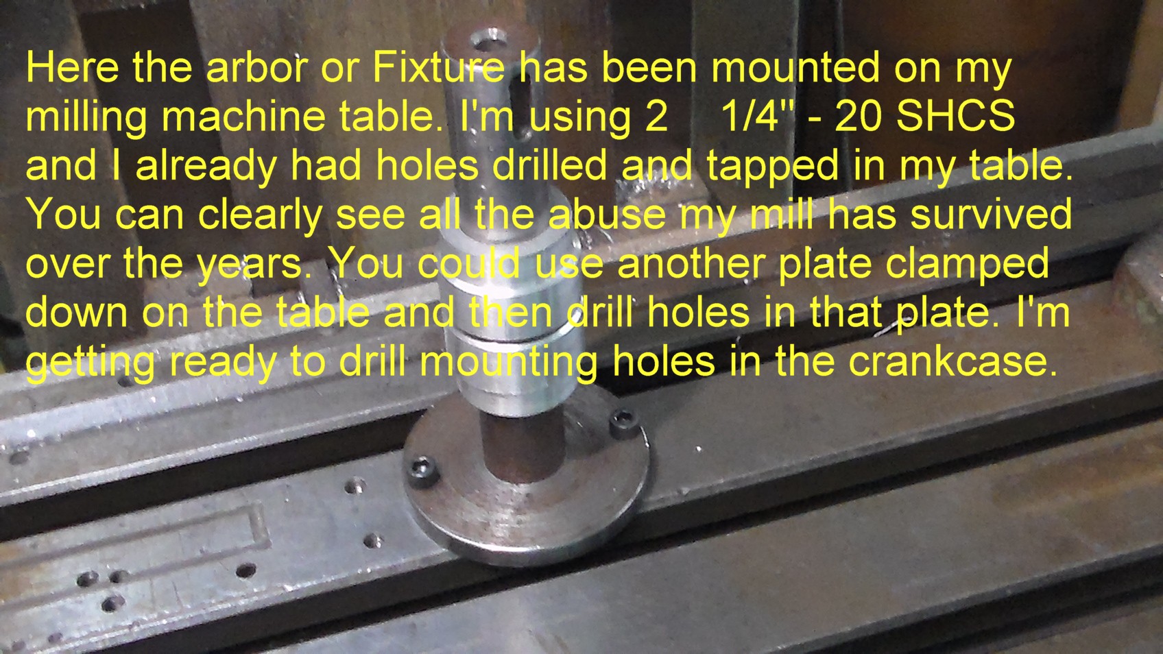

Never started a thread before so I really had no idea what was going to happen. I'm going to start by facing off the front and rear of the crankcase. This will provide a smooth machined surface to mount your motor mount and hall effect switch to. Your going to need a small engine lathe and some fixtures to be able to do this. I have a Auto-Cad drawing of all the parts that your going to need and I'll be happy to send anyone a copy of it for free. I'm not trying to make any money from this. This drawing will open in Draftsight or Auto-Cad. [email protected]

No comments. I can see a bunch of guys looking but no Comments.

Old 01-05-2017, 11:44 AM
Larry882
Join Date: Feb 2014
Posts: 87

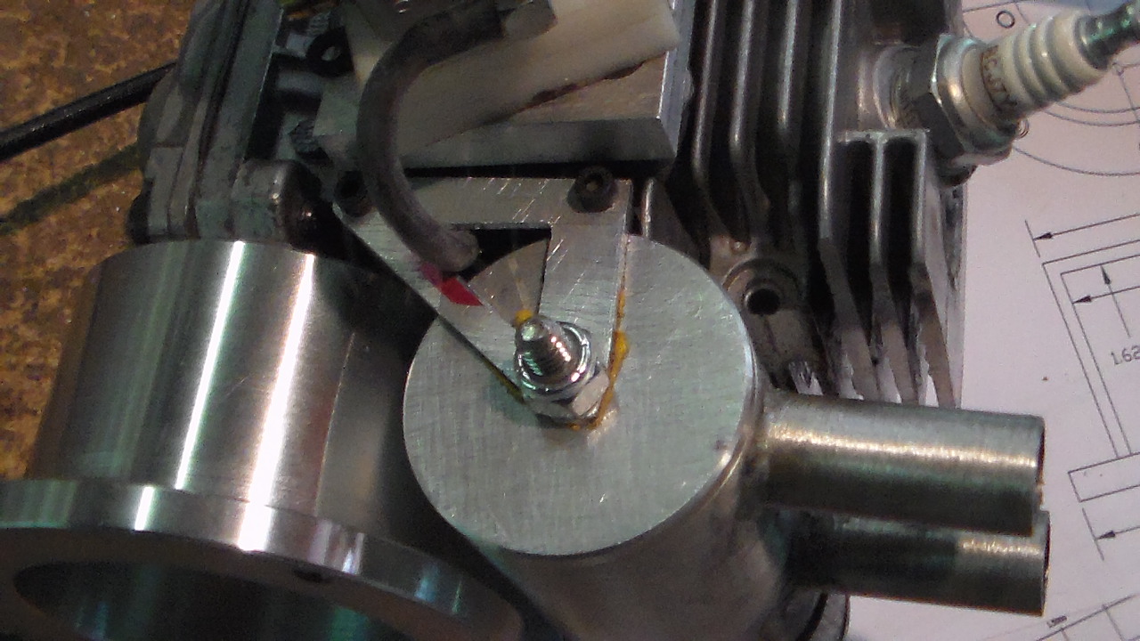

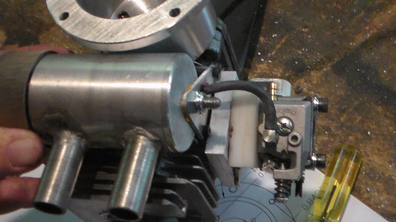

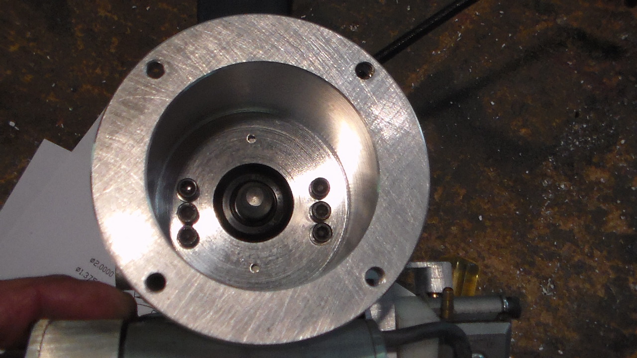

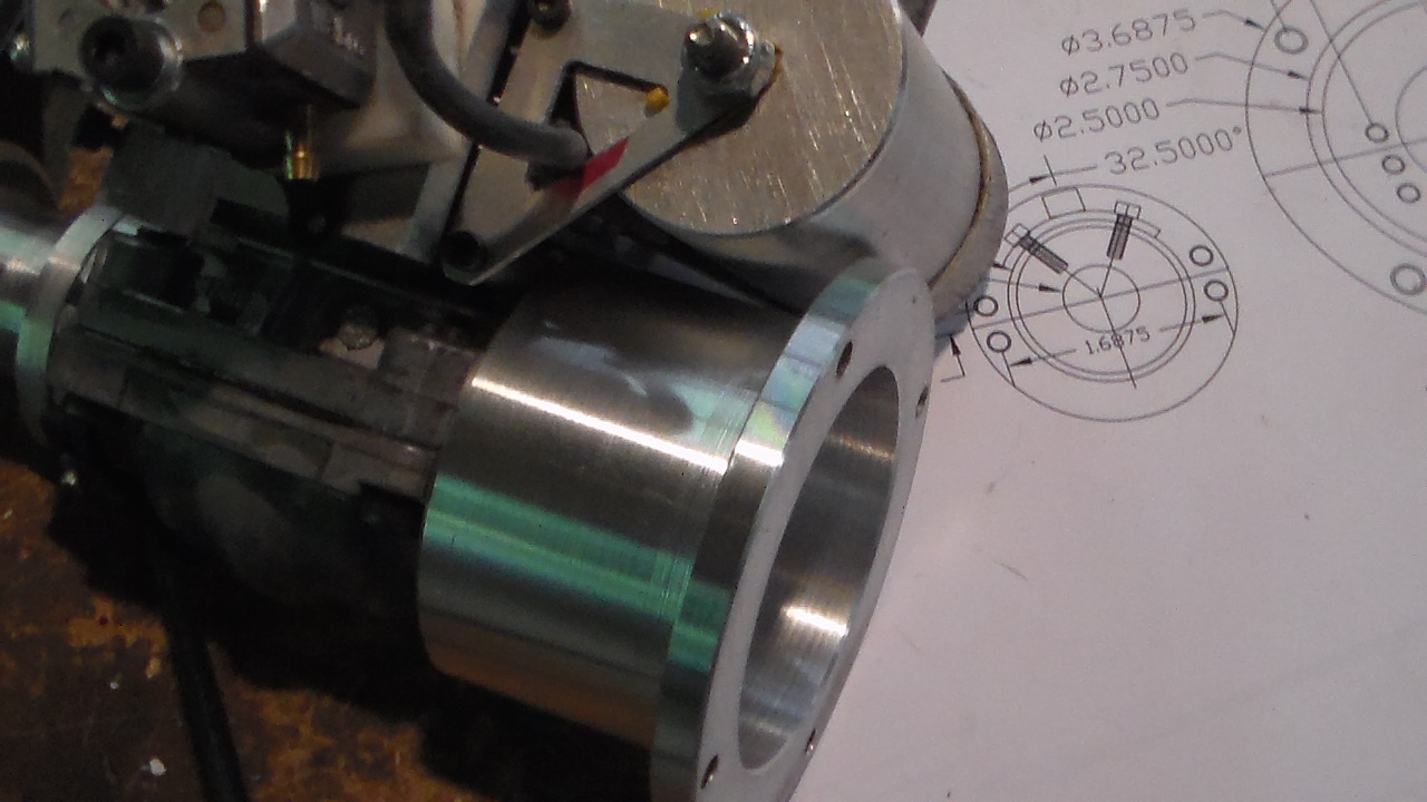

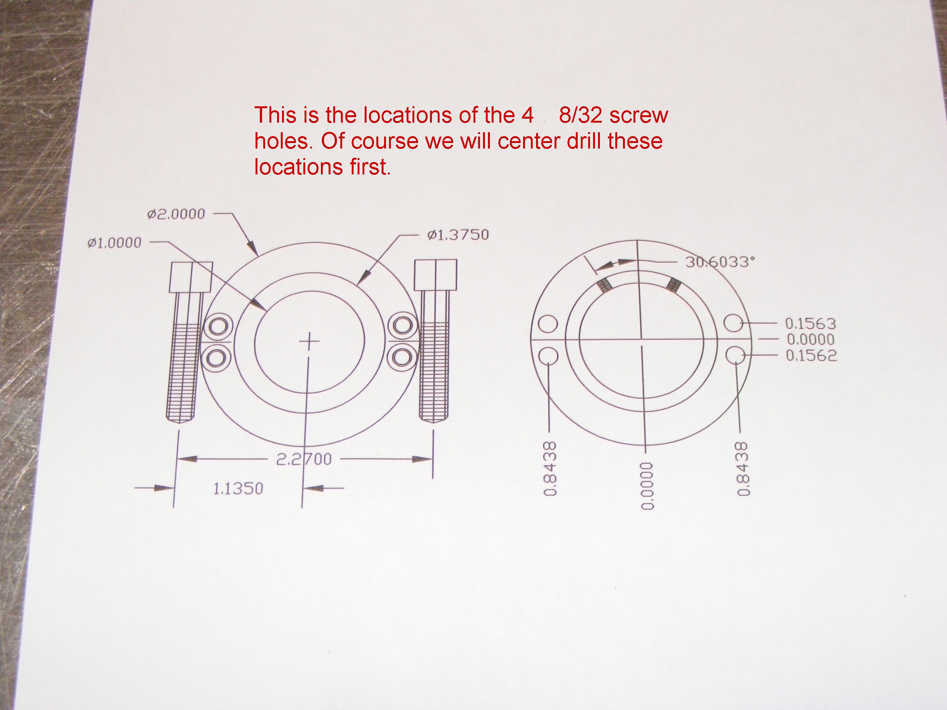

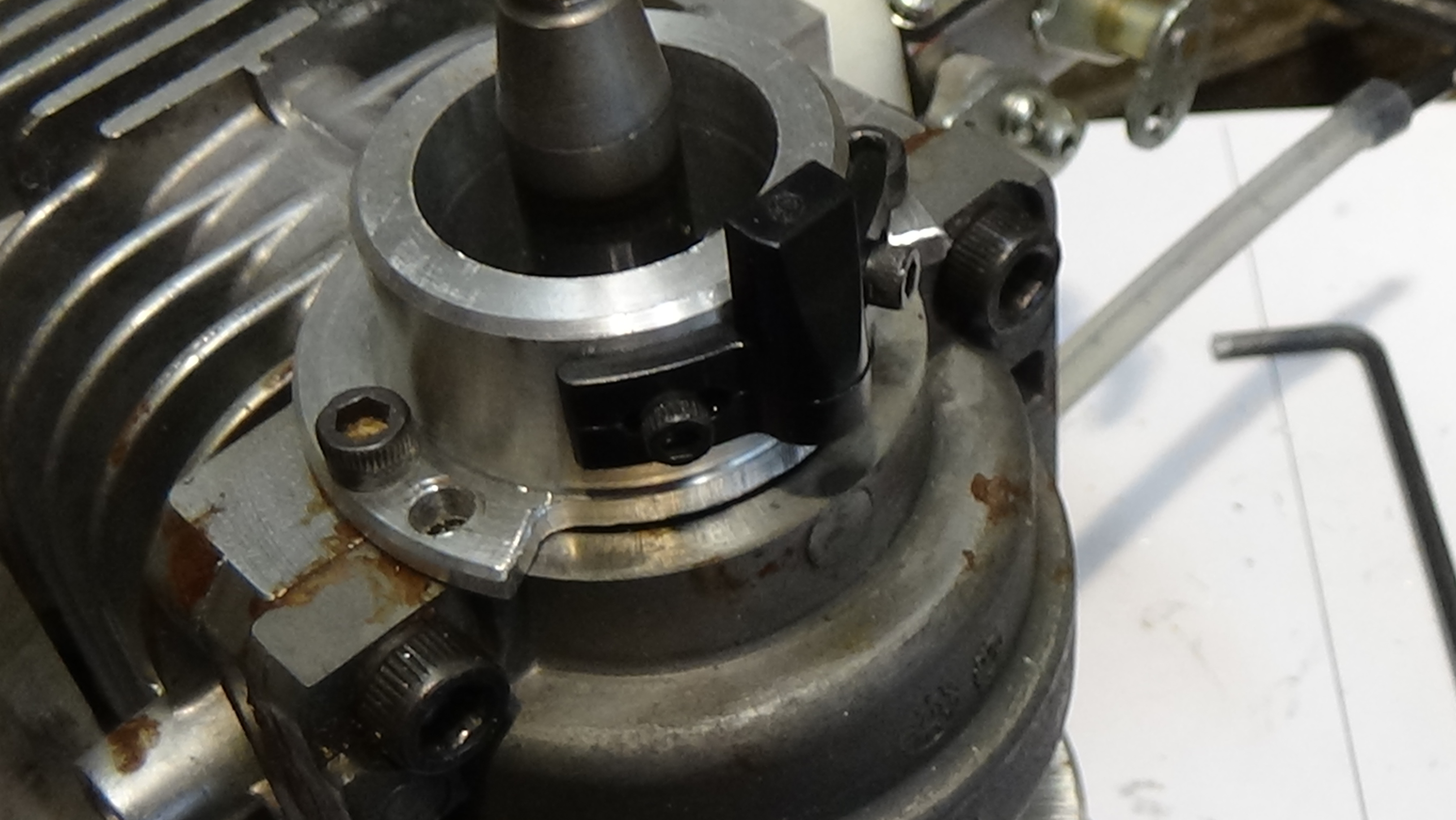

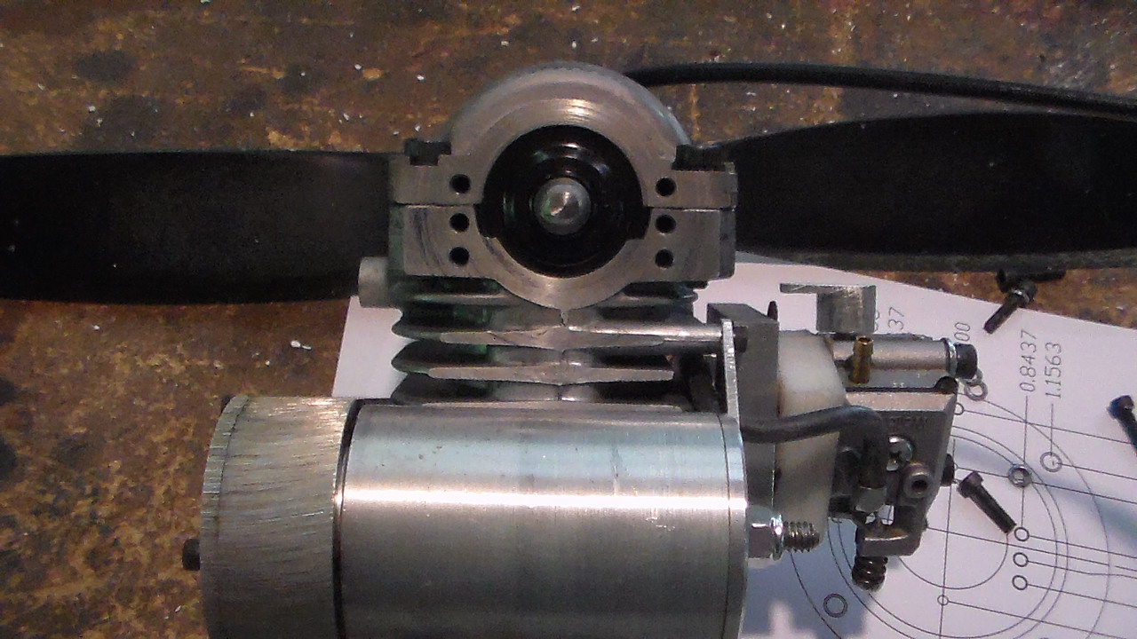

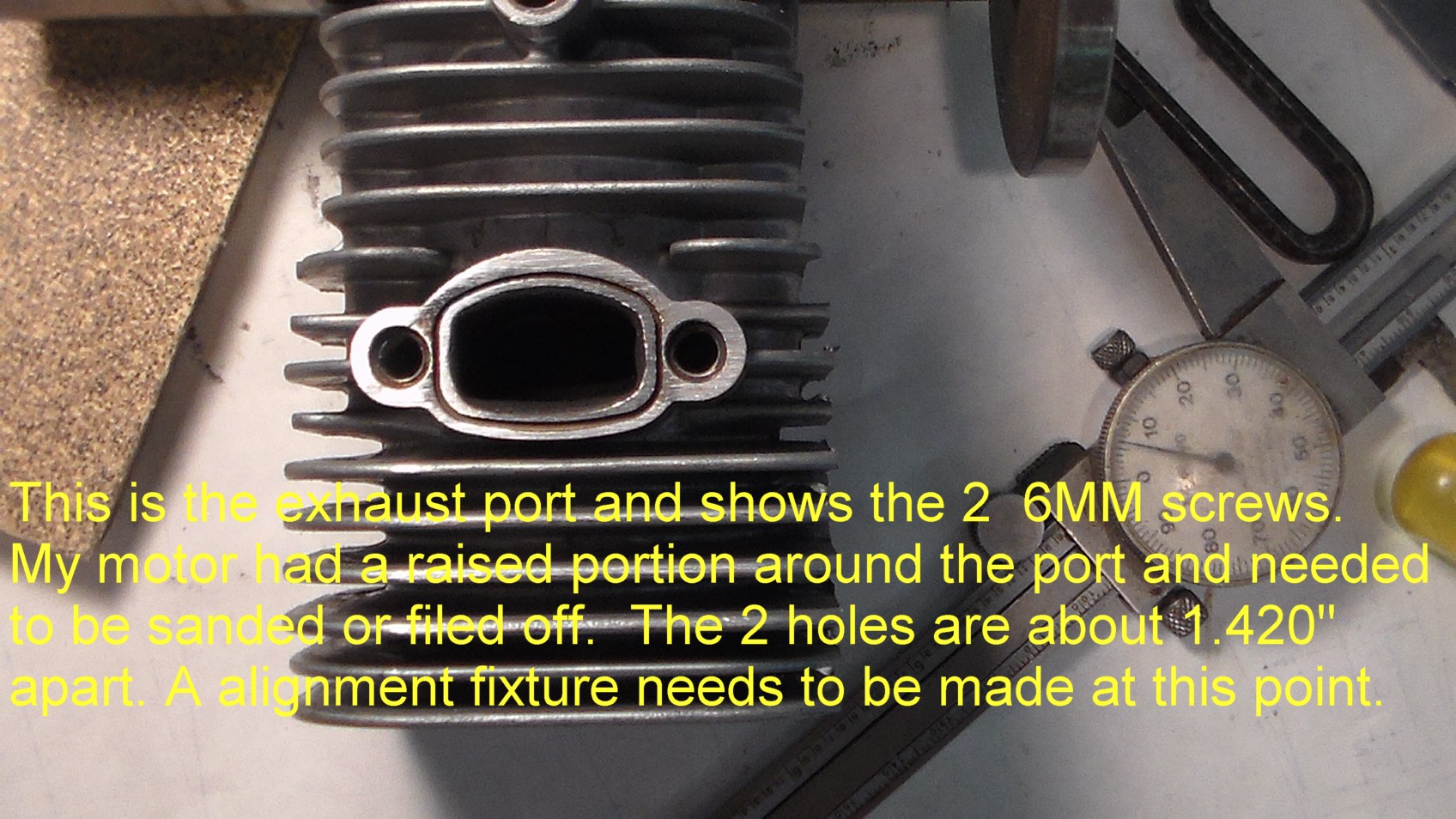

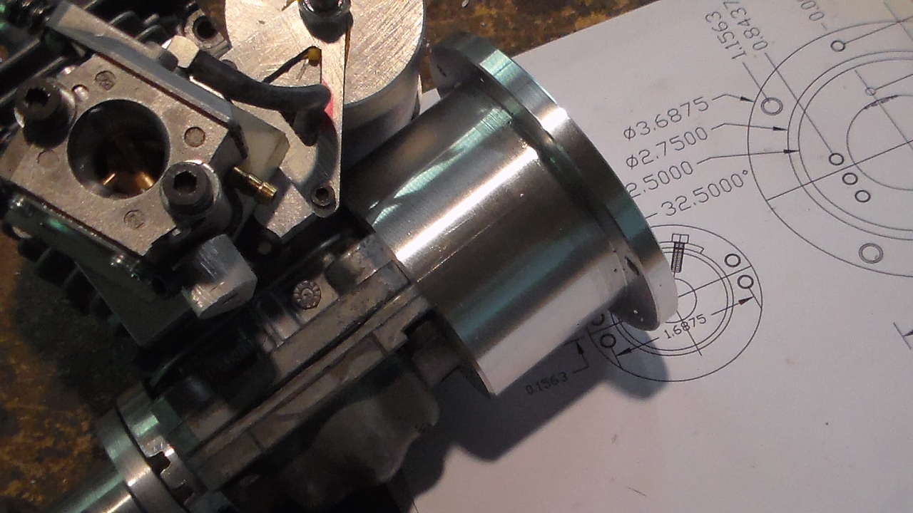

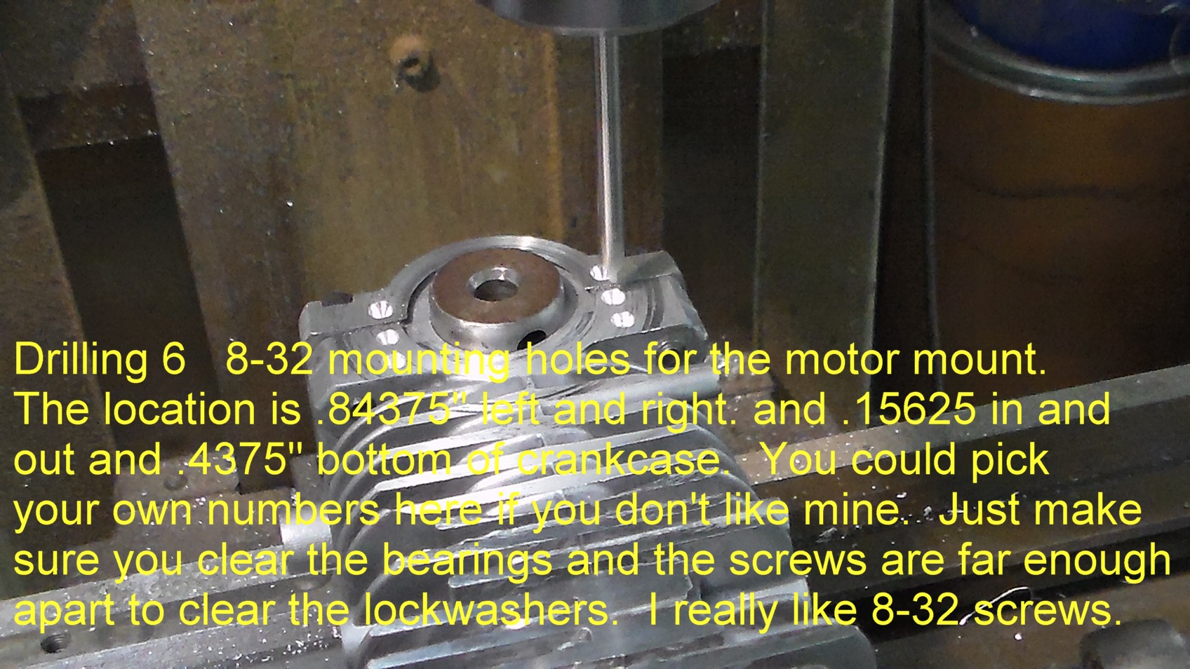

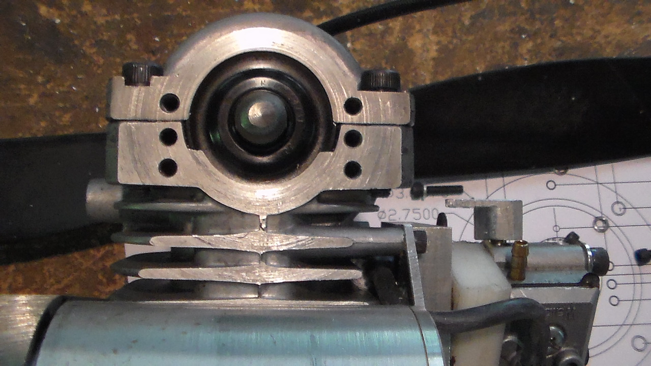

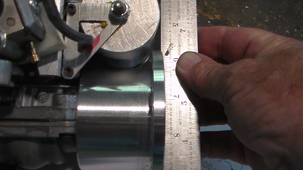

Now we start getting the motor mount on the motor. I'm using 6 8/32 X 5/8" long socket head cap screws to bolt it in place. The mount is turned from a 2" thick piece of 2024 aluminum. It is 3.812" in diameter. It needs to be 2" thick because the muffler is mounted directly below it. The mount has 4 1/4"-20TPI screw threads for the firewall.

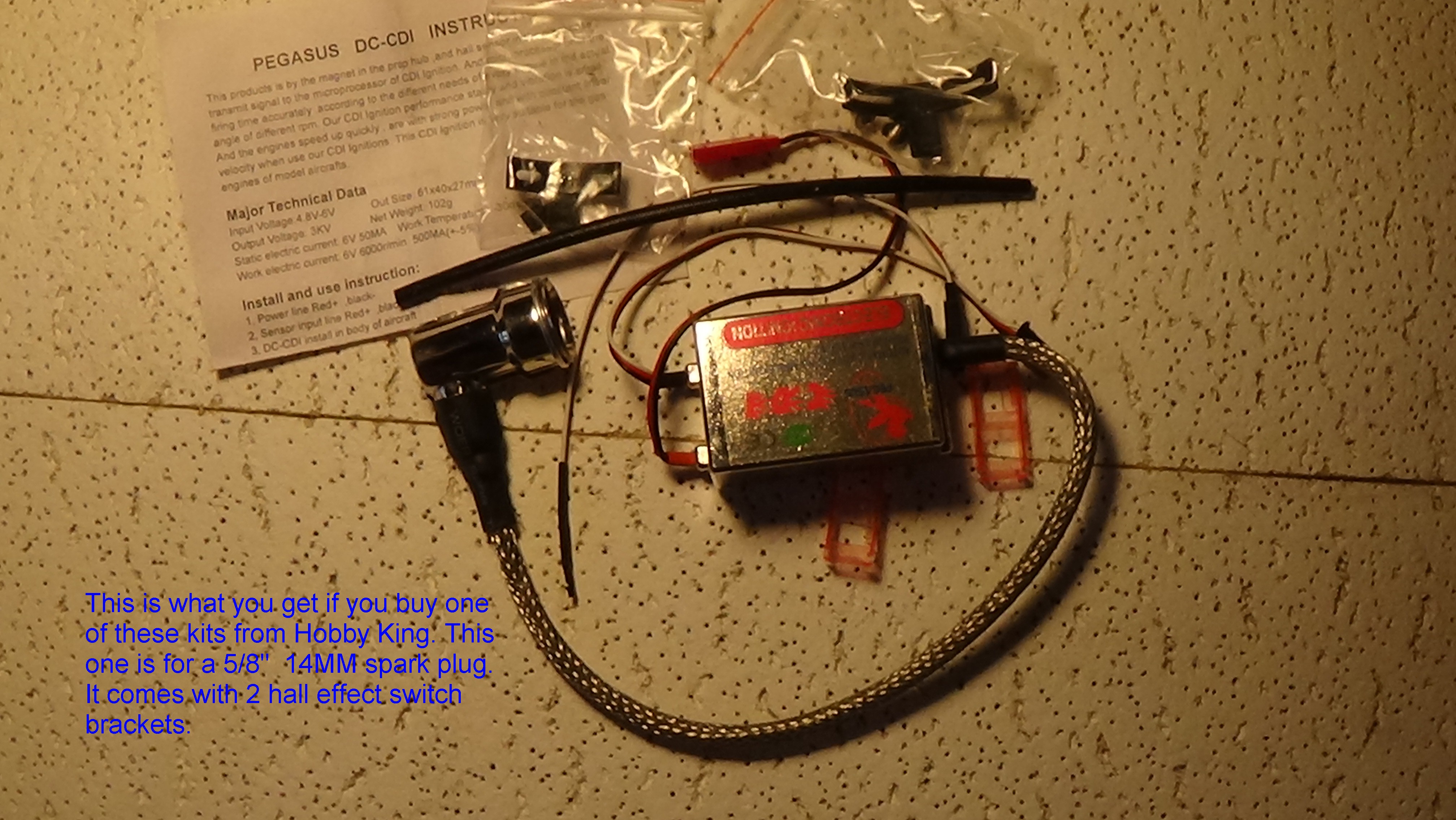

On many conversions, I use a round sensor. You can buy round sensors made up by Adrian at www.ch-ignitions.com. Sometimes l buy them ready made, but I also have a stock of bulk hall effect sensors and I make up my own sensor unit by soldering the wires and then gluing the sensor and wires into a short length of aluminum tube. I then hand form a bracket that looks like an Adel clamp, and mount it to the front of the engine using a single 8-32 serrated, socket head screw and Loctite. Works very well. Then I machine up a collar which is a sliding fit onto the prop hub. This collar has the magnet for triggering the sensor, and a set screw to secure it. This is used to set the ignition timing. I have this setup on dozens of engines and it is fairly easy to do, reliable, and durable.
Once again, I will try to find some pics to post. Keep up the nice work!

The commercial kits they used to sell for converting the Poulan 33/42cc engines just used a piece of aluminum flat stock that bolted to one of the crankcase half screws. (Along with a spacer). It had a hole in it to glue the round type sensor into, then once again, a sliding collar with the magnet that fitted onto the prop hub.

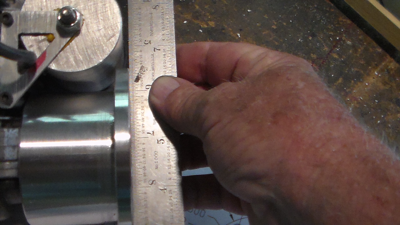

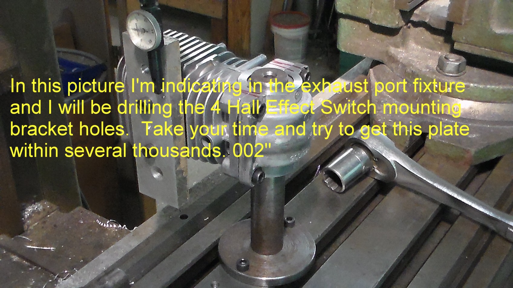

Old 01-28-2017, 12:37 PM
Larry882
Join Date: Feb 2014
Posts: 87

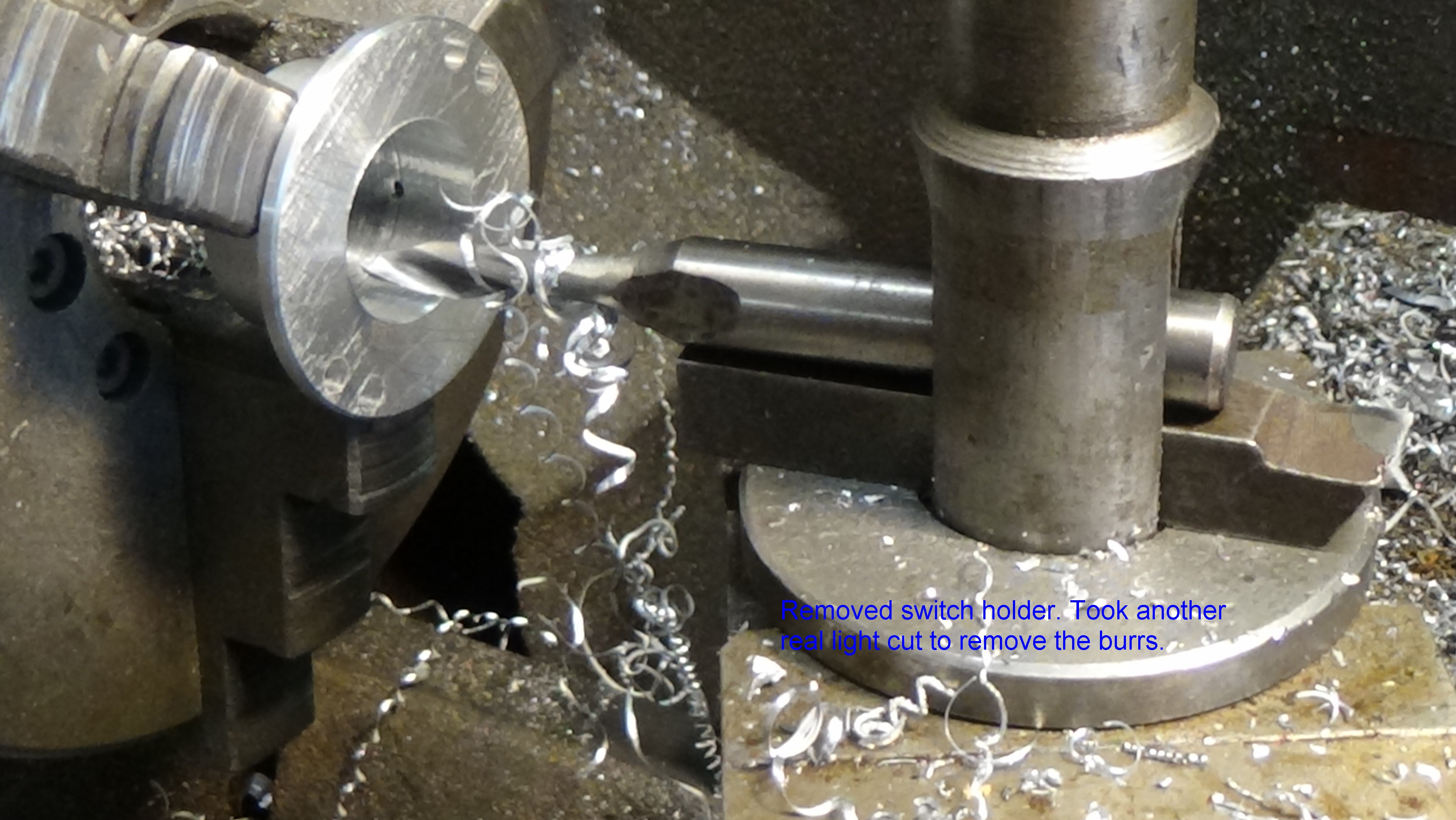

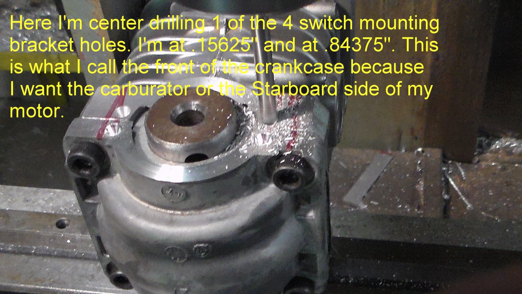

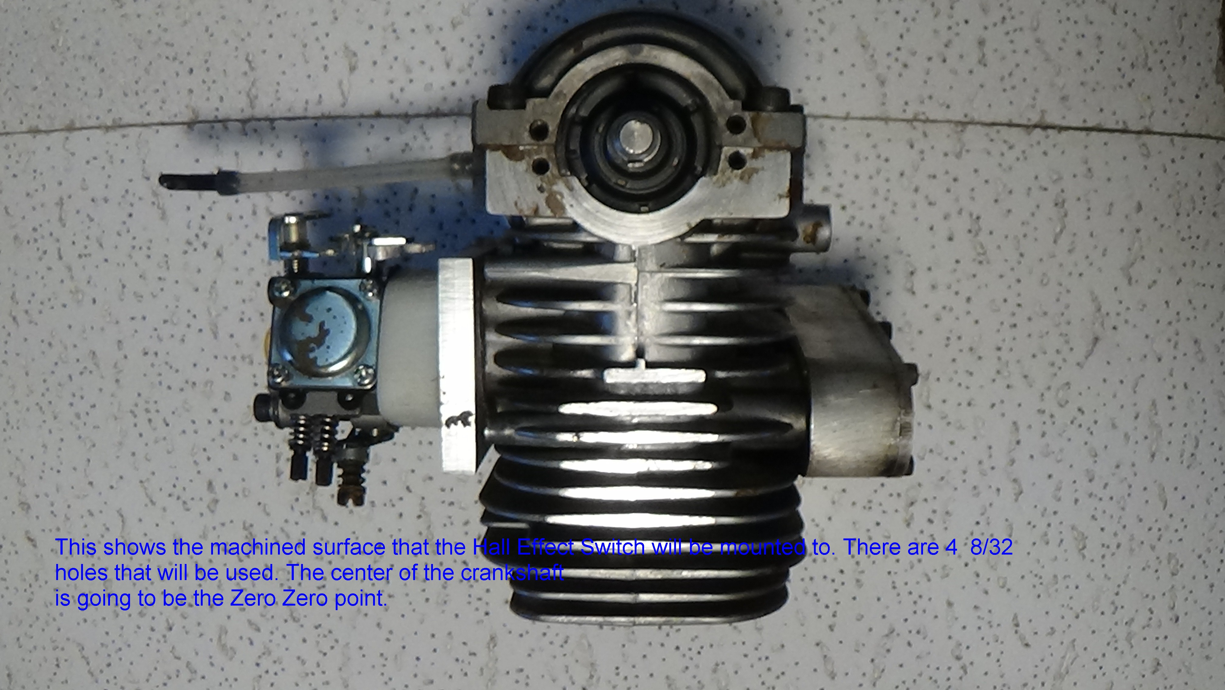

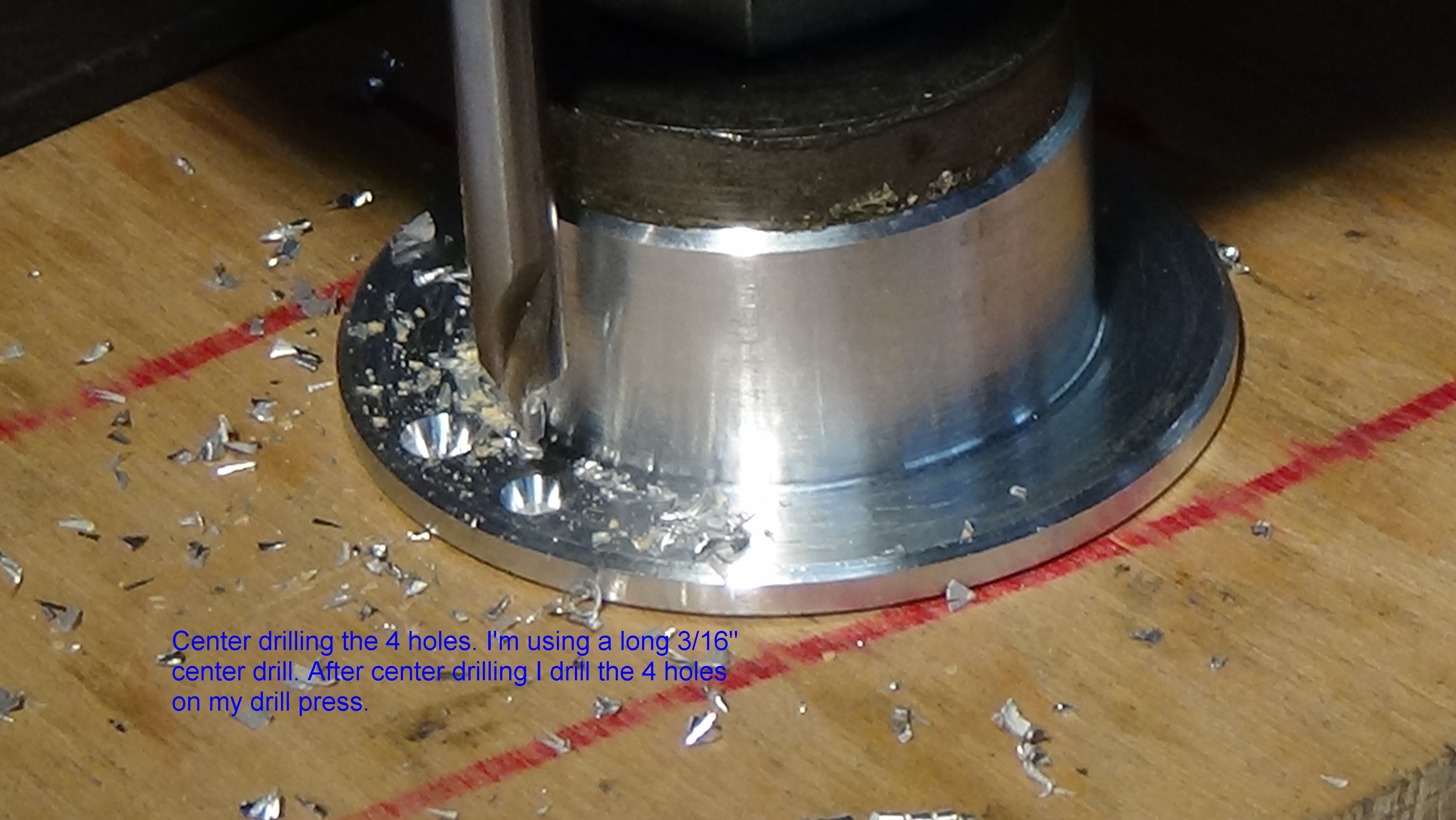

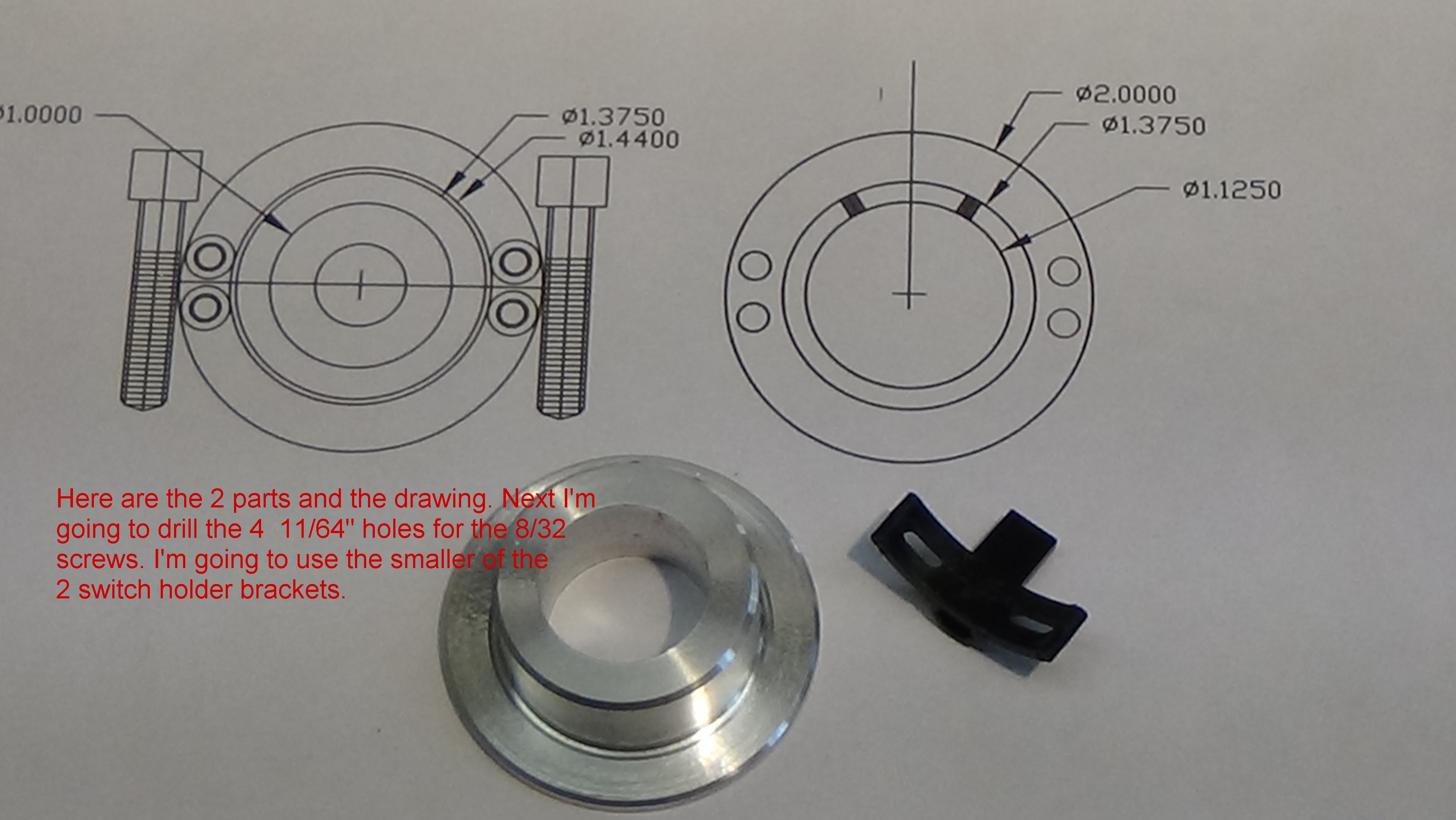

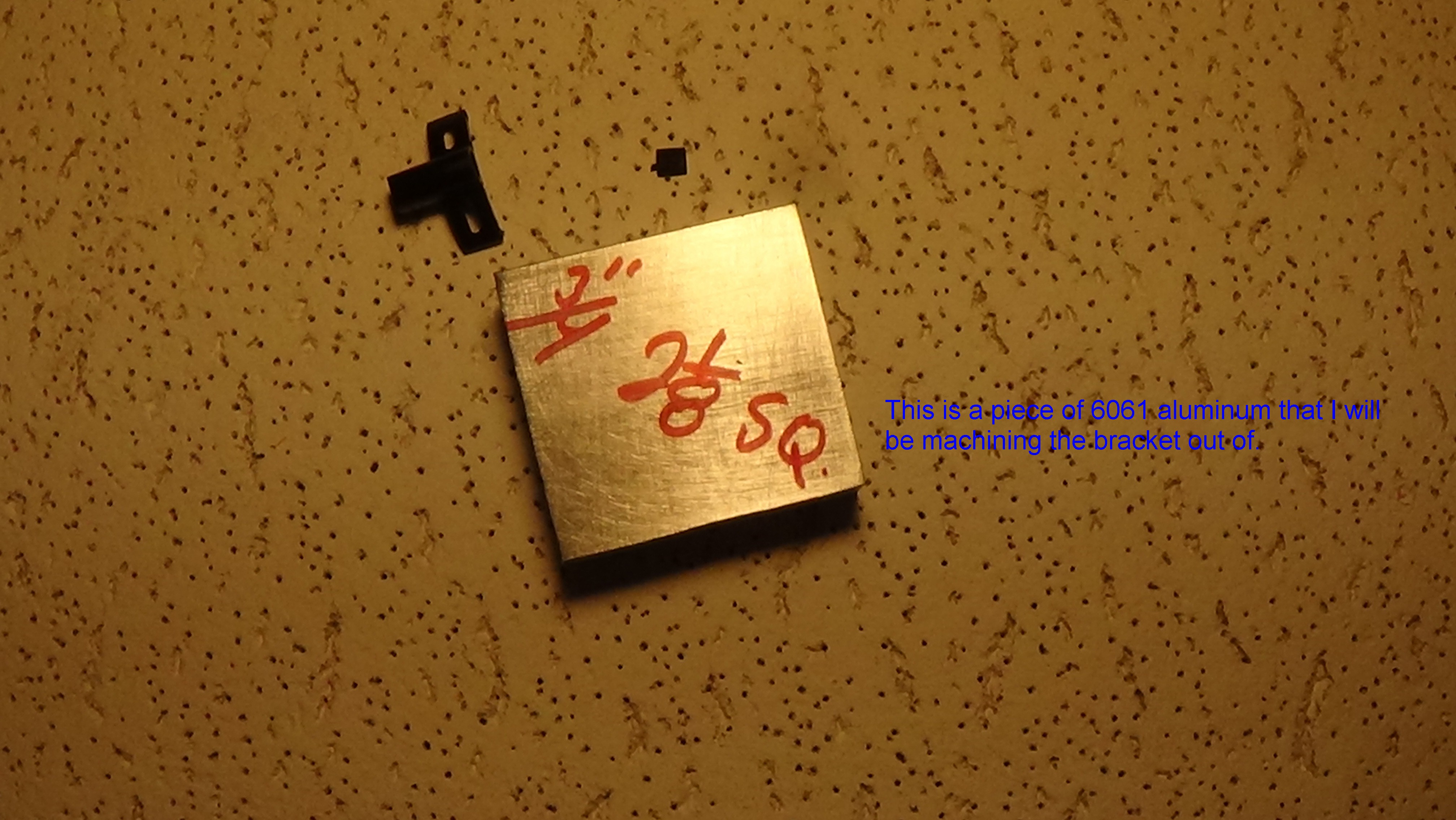

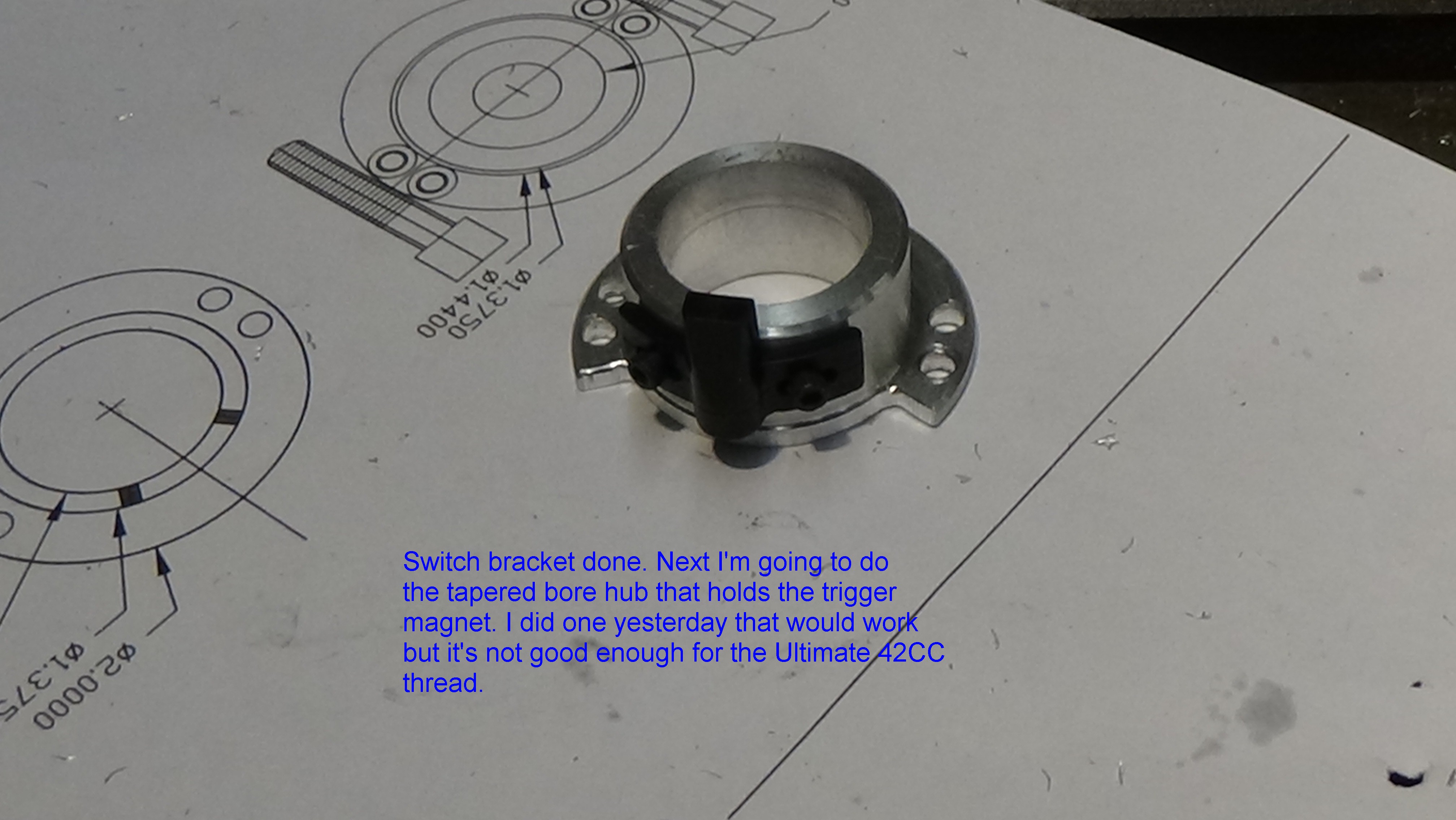

Made the Hall Effect Switch bracket today and took lots of pictures while doing it. Got to add text to the pictures before I post them. Took 30 pictures.
Larry

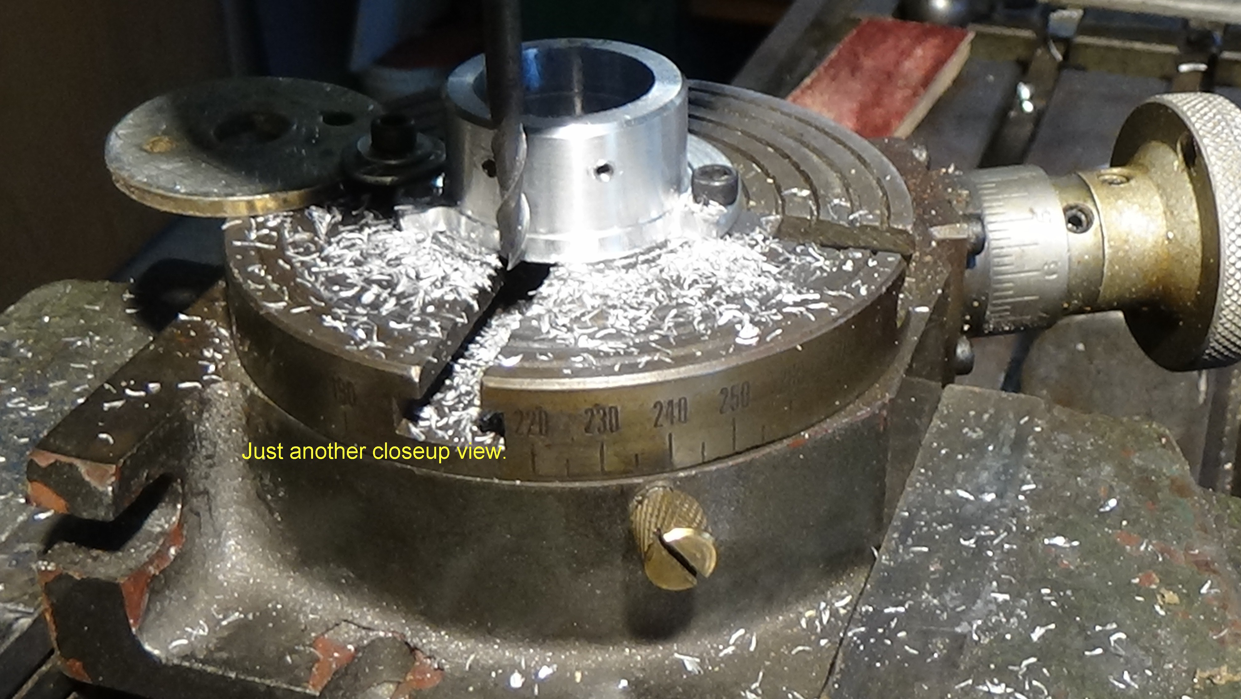

Old 01-29-2017, 08:27 AM
Larry882
Join Date: Feb 2014
Posts: 87

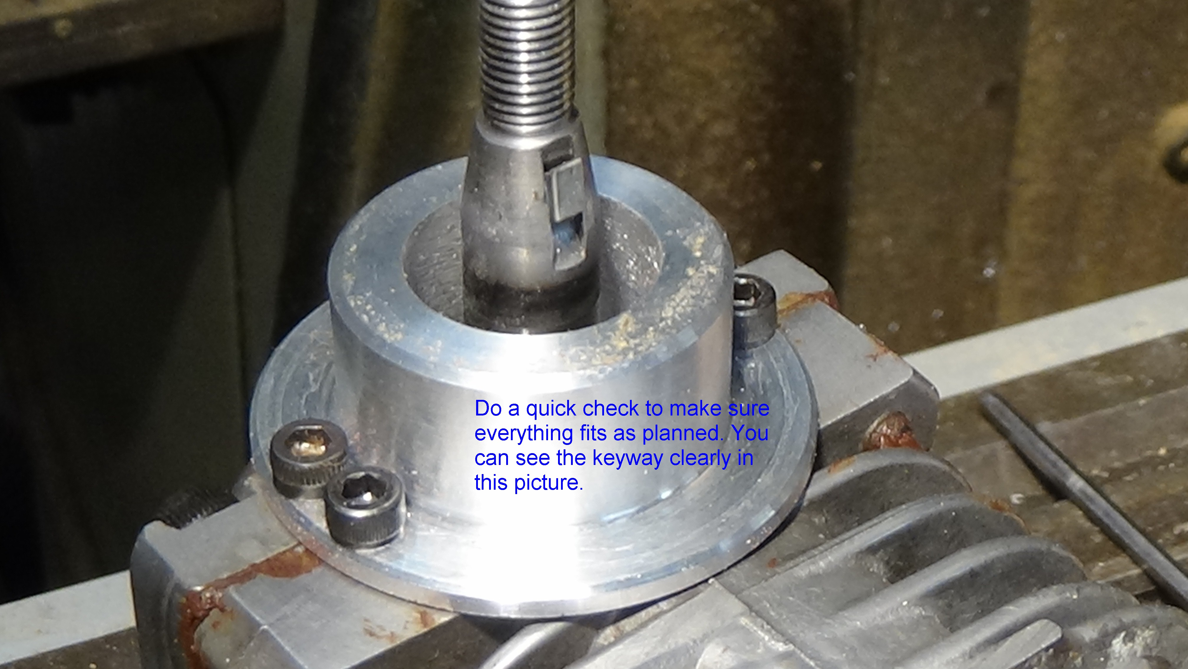

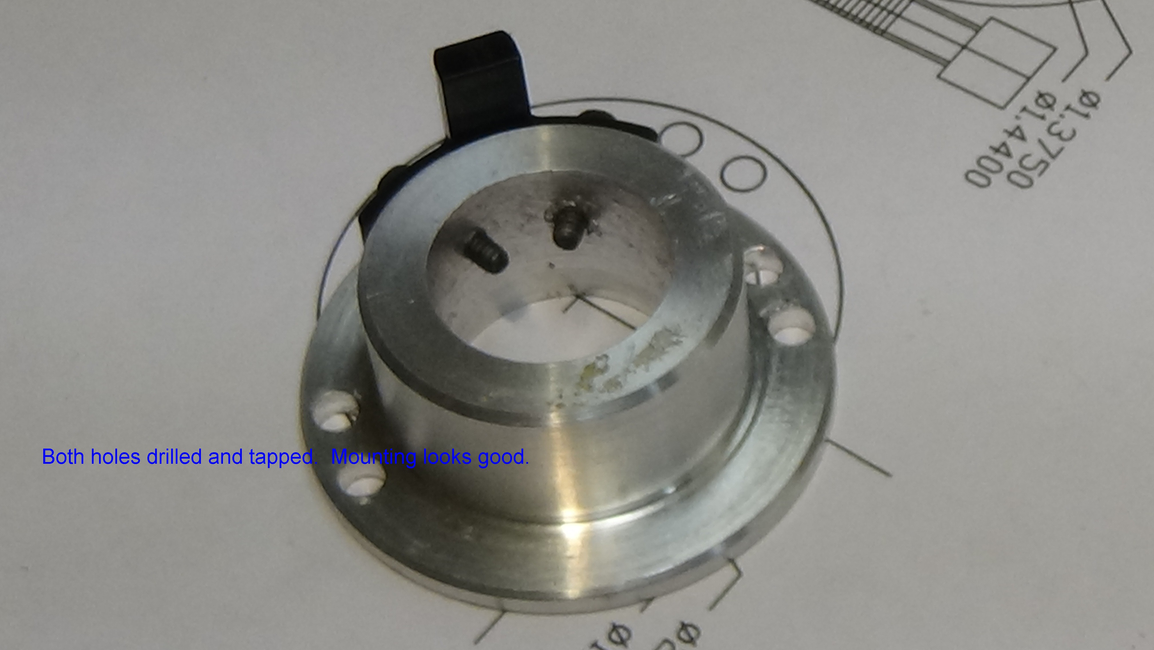

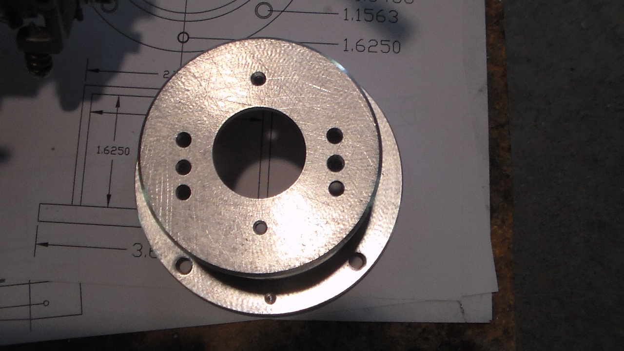

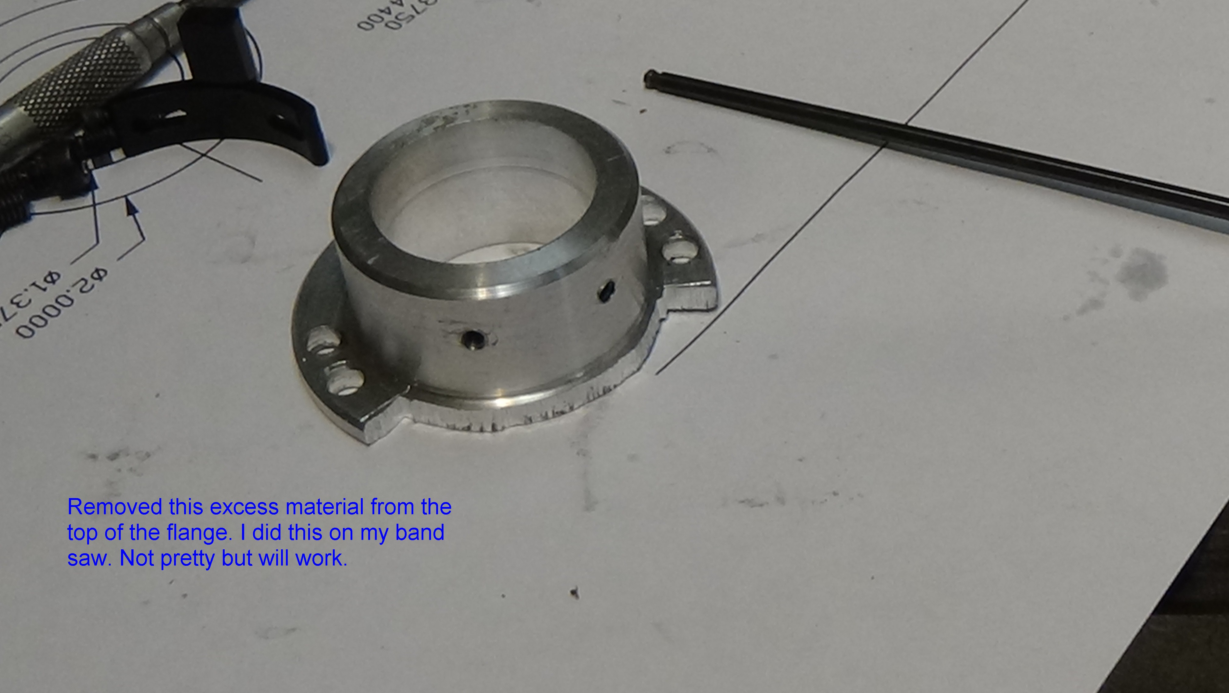

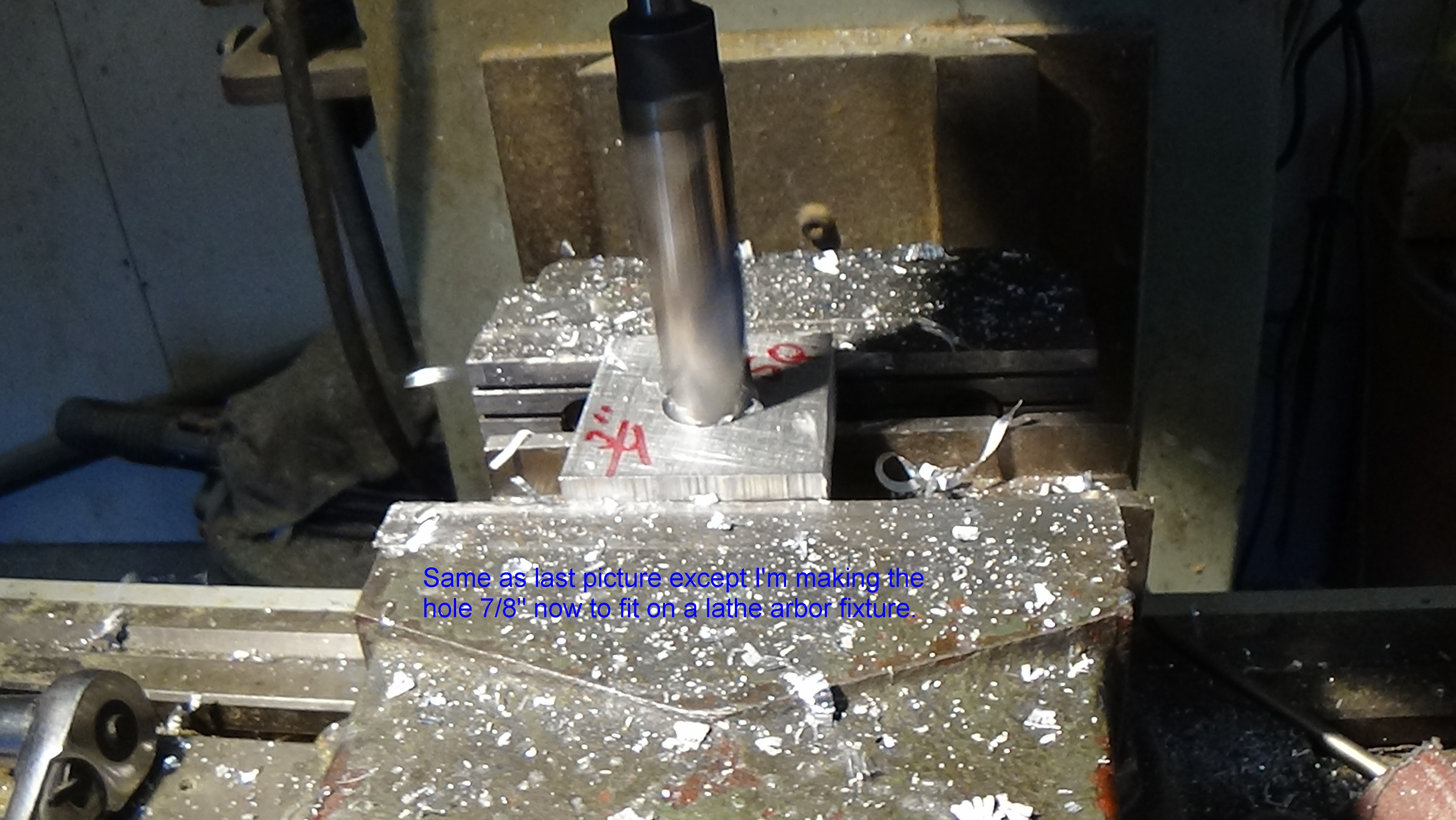

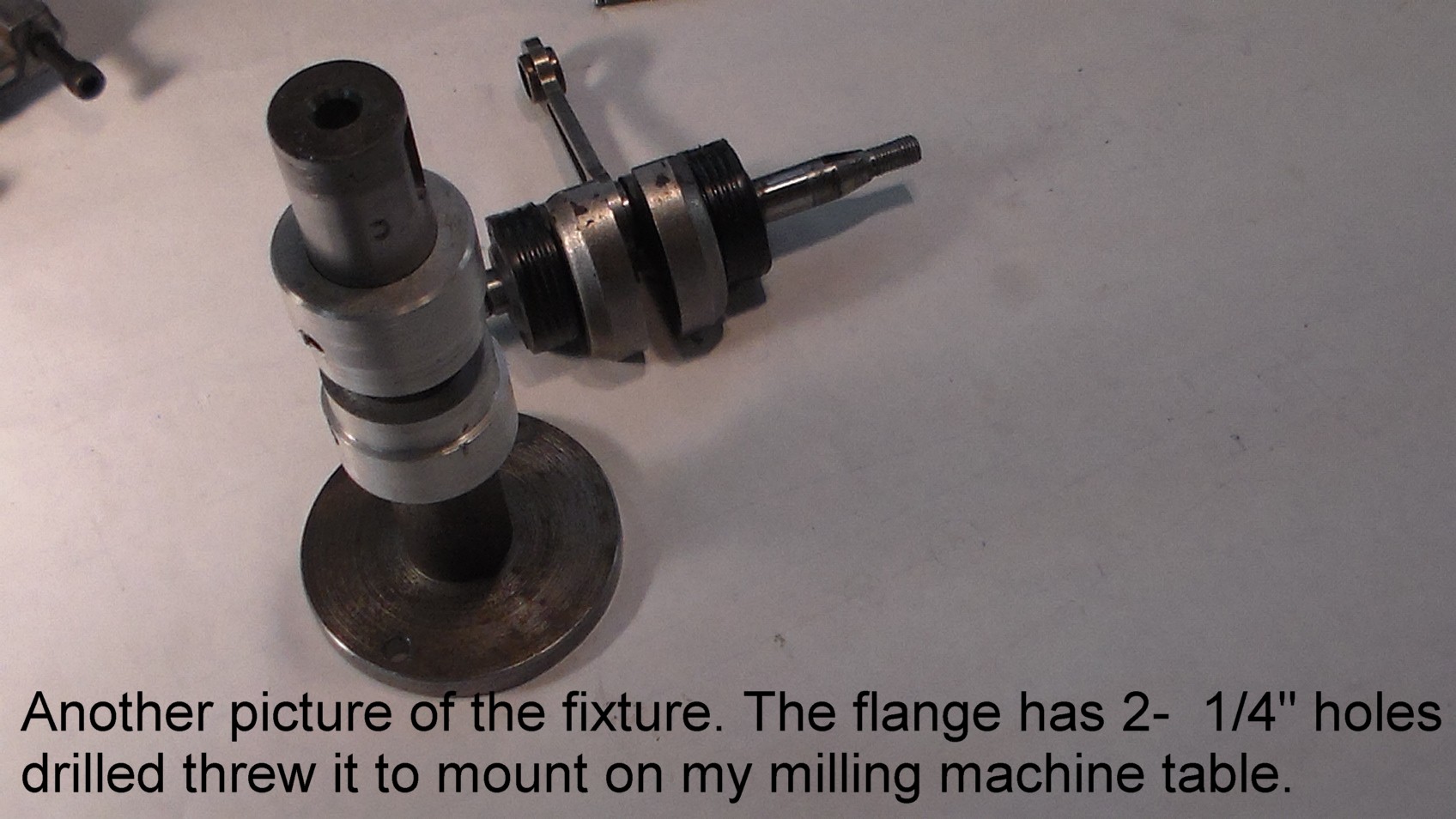

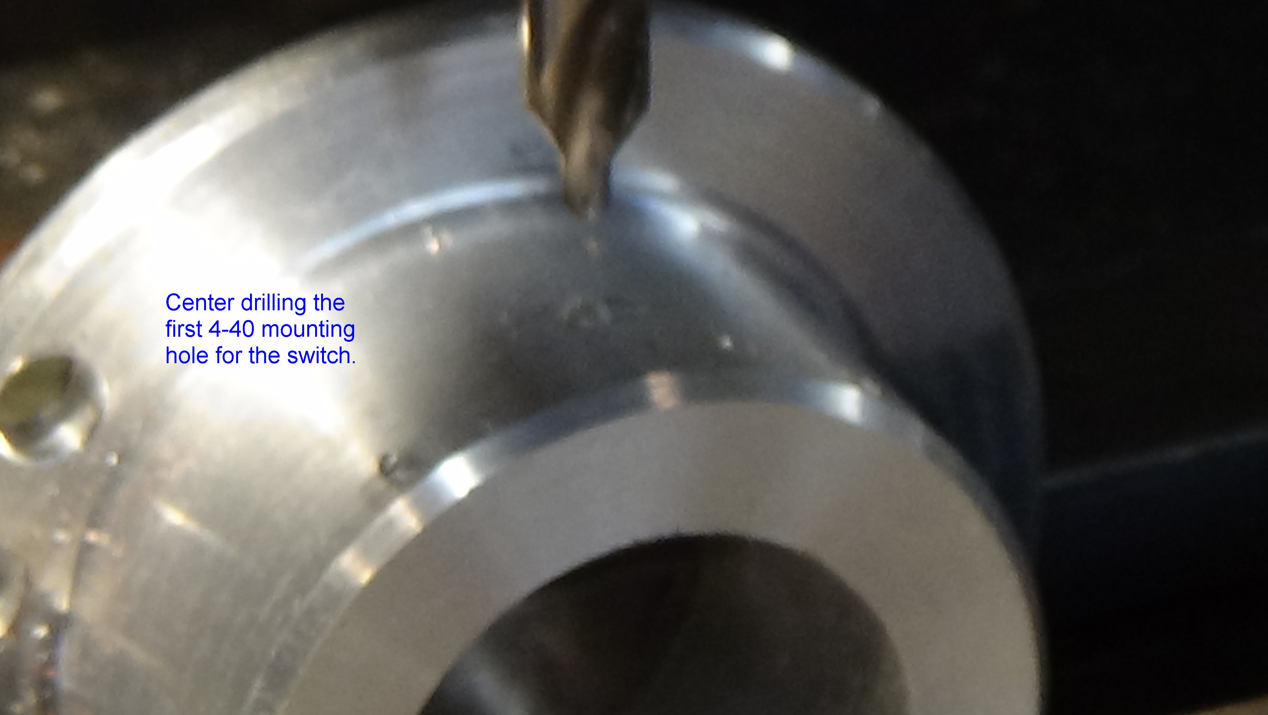

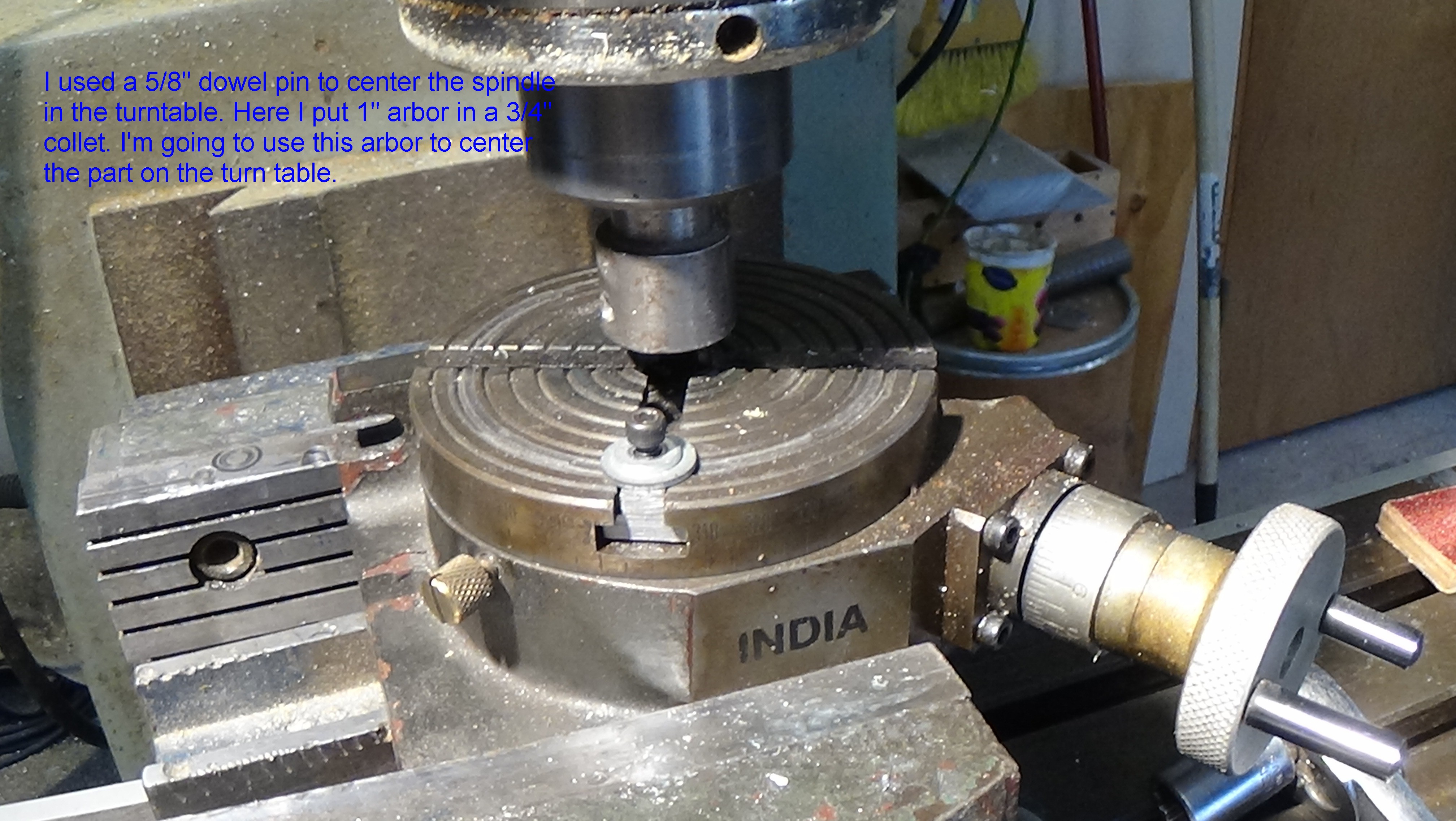

Spent yesterday making this part and took lots of pictures doing so. This afternoon
I'm going to make the tapered bore Magnet holder hub.

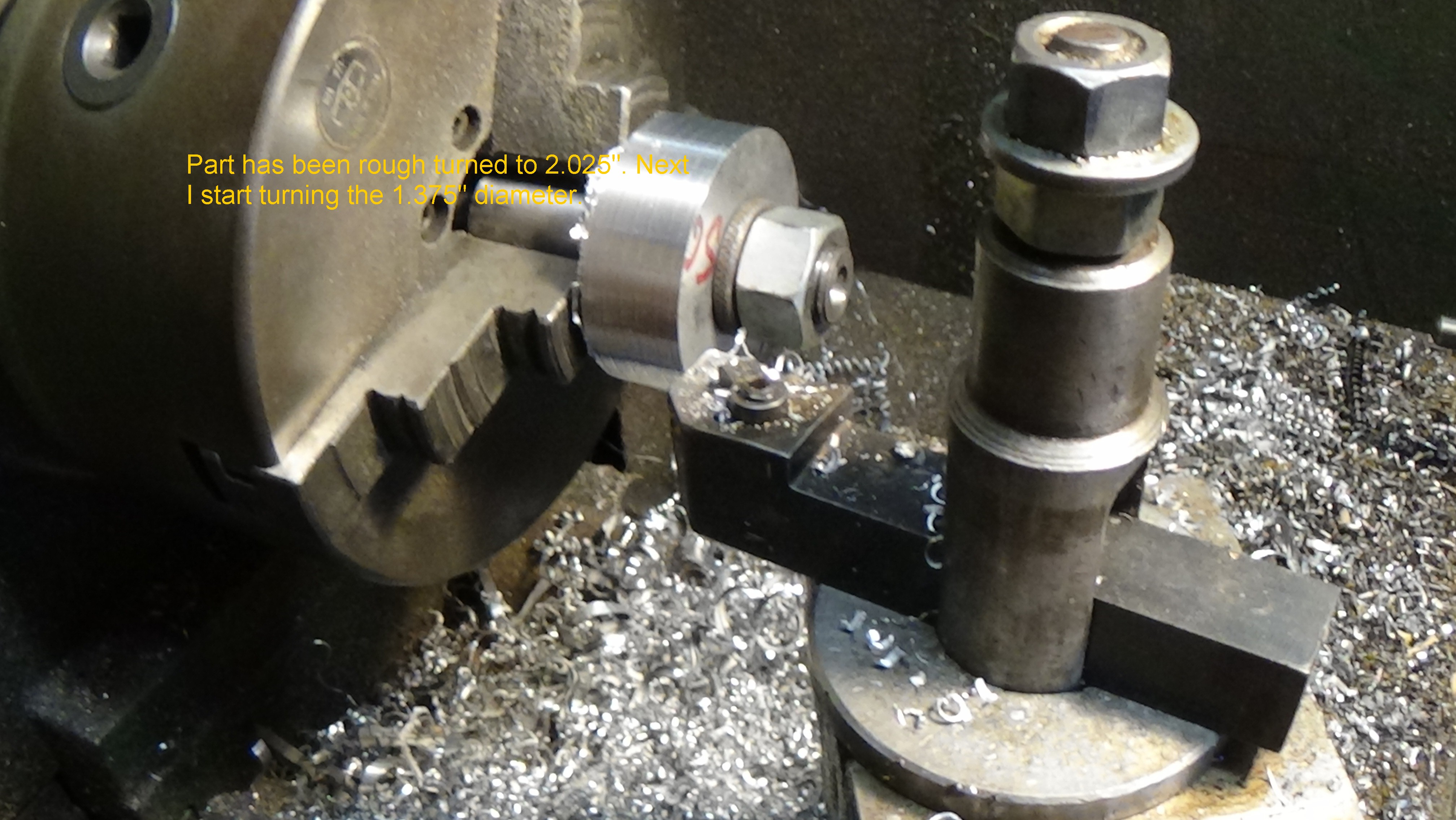

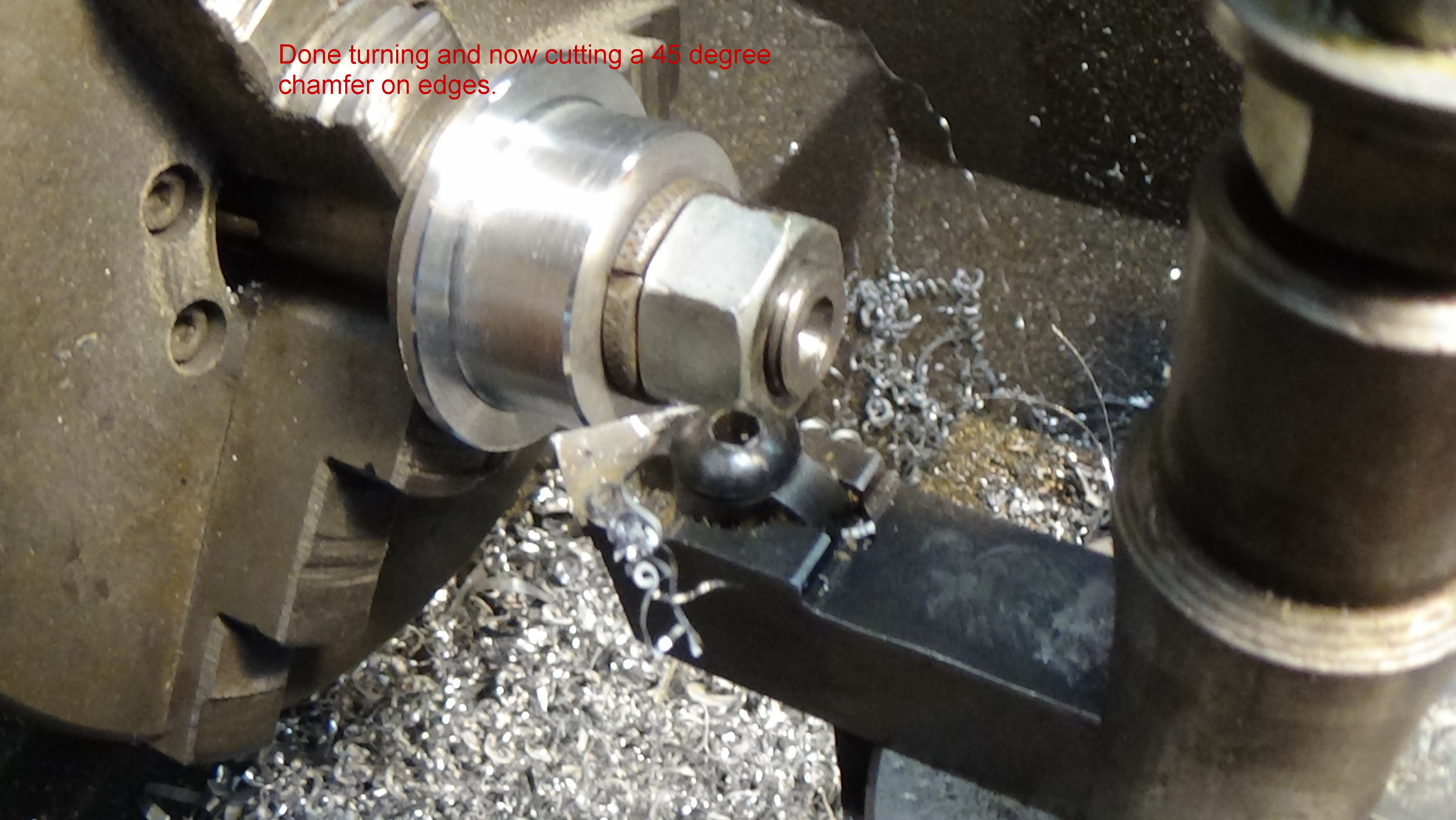

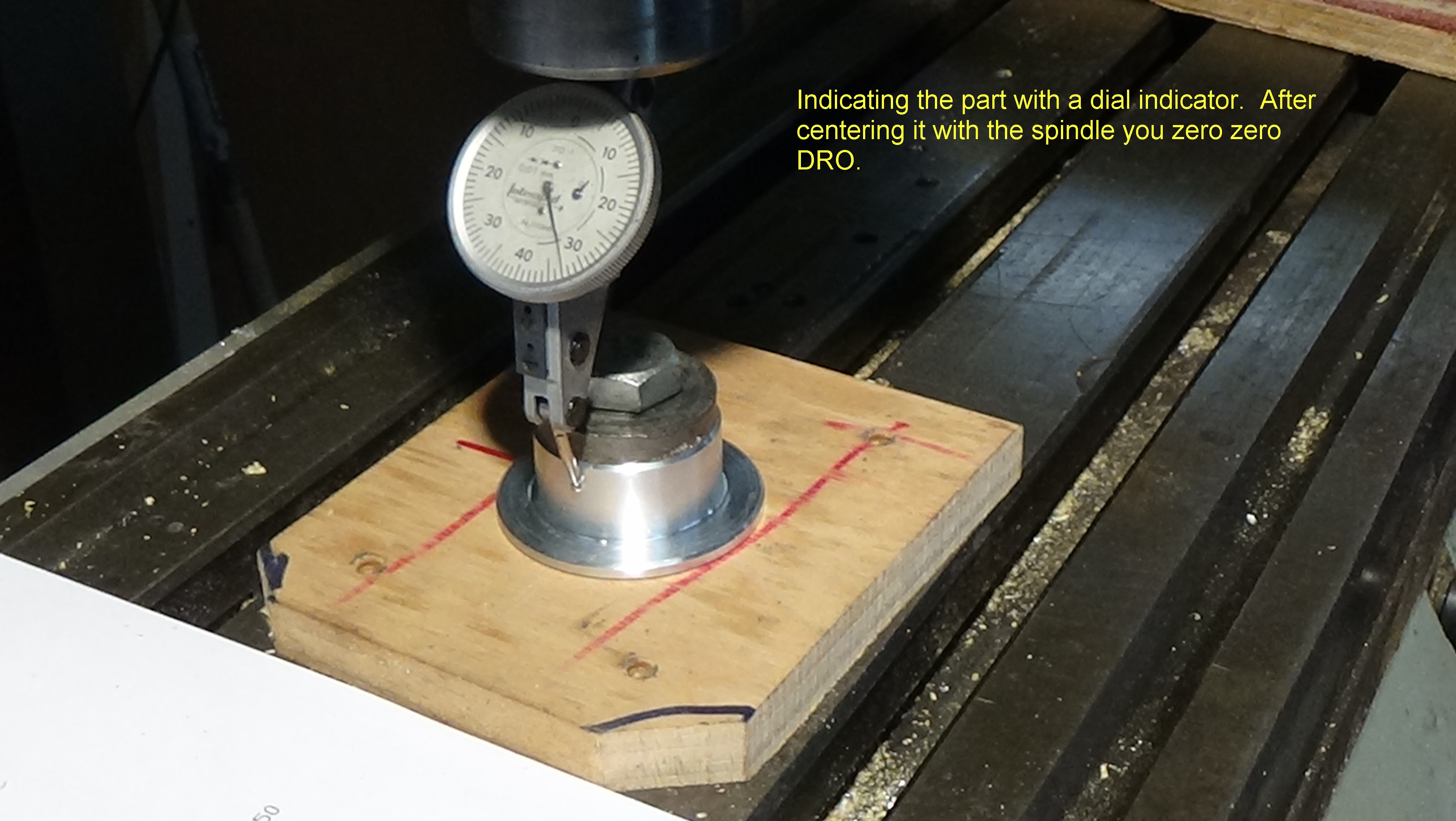

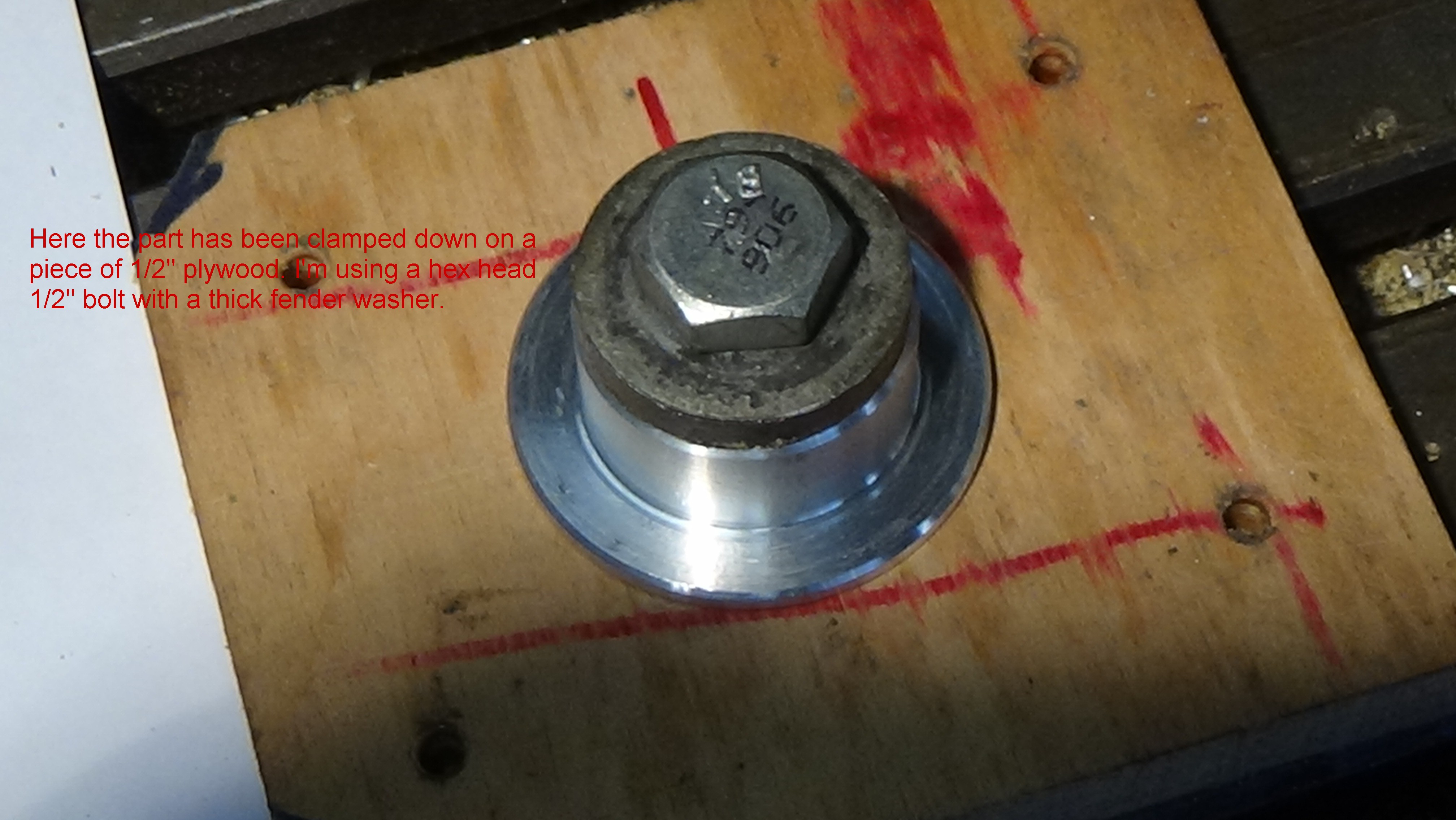

Old 02-06-2017, 03:39 AM
Larry882
Join Date: Feb 2014
Posts: 87

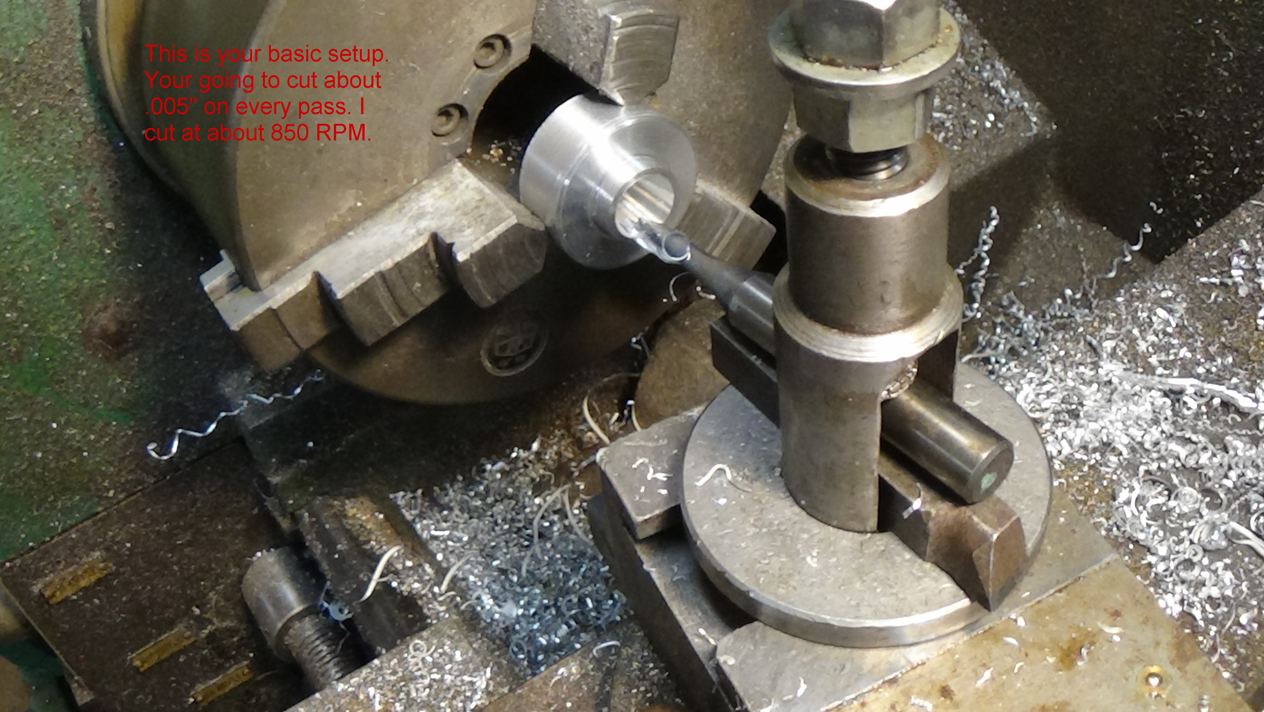

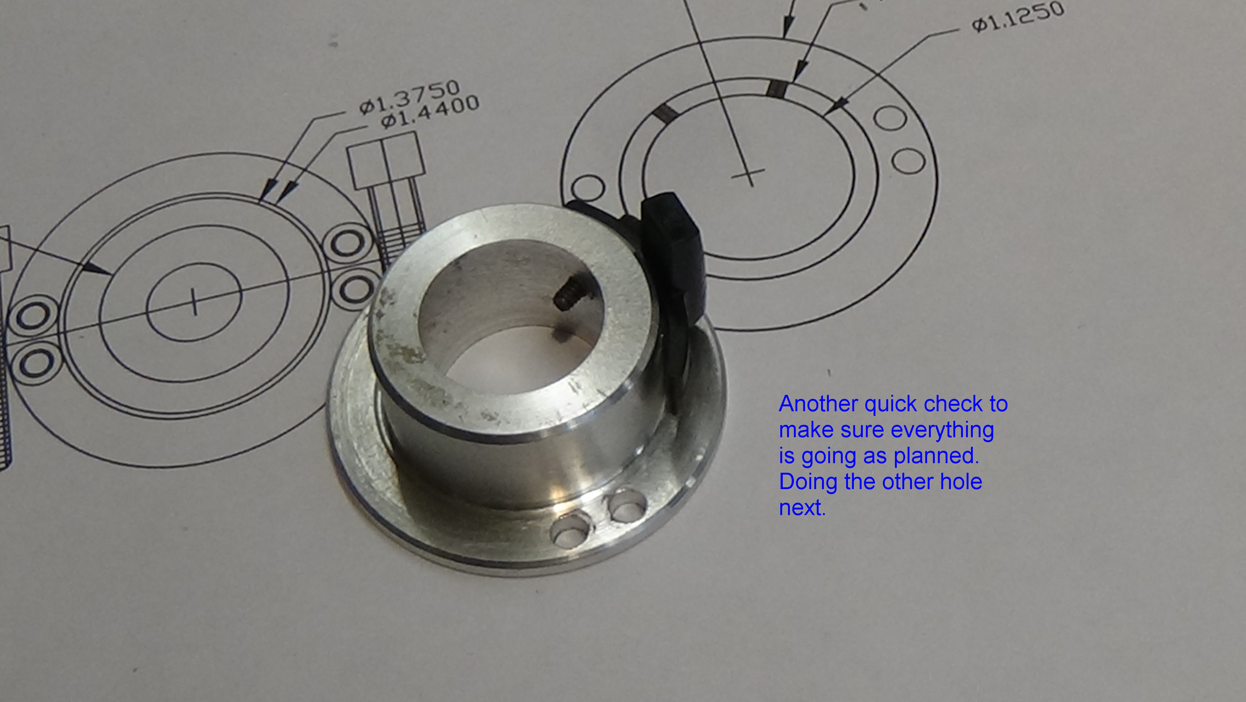

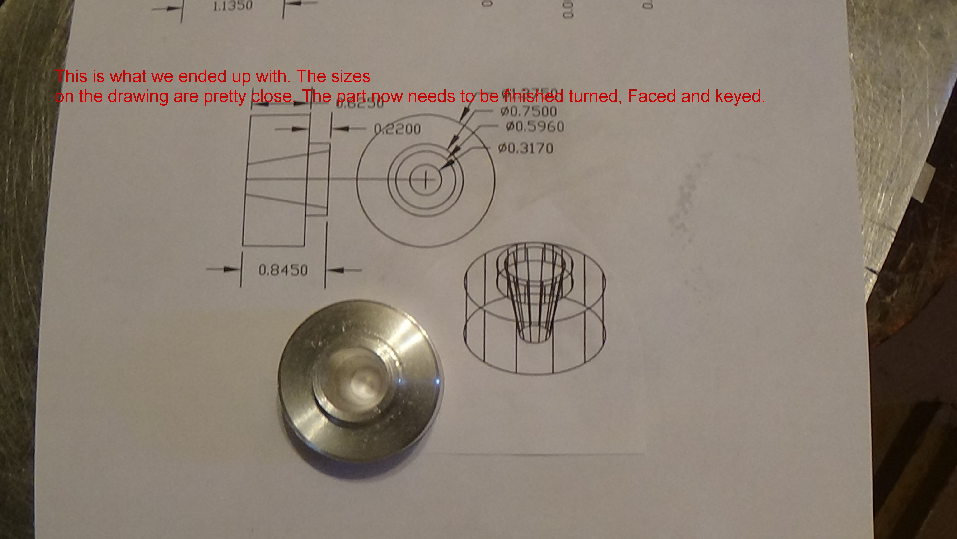

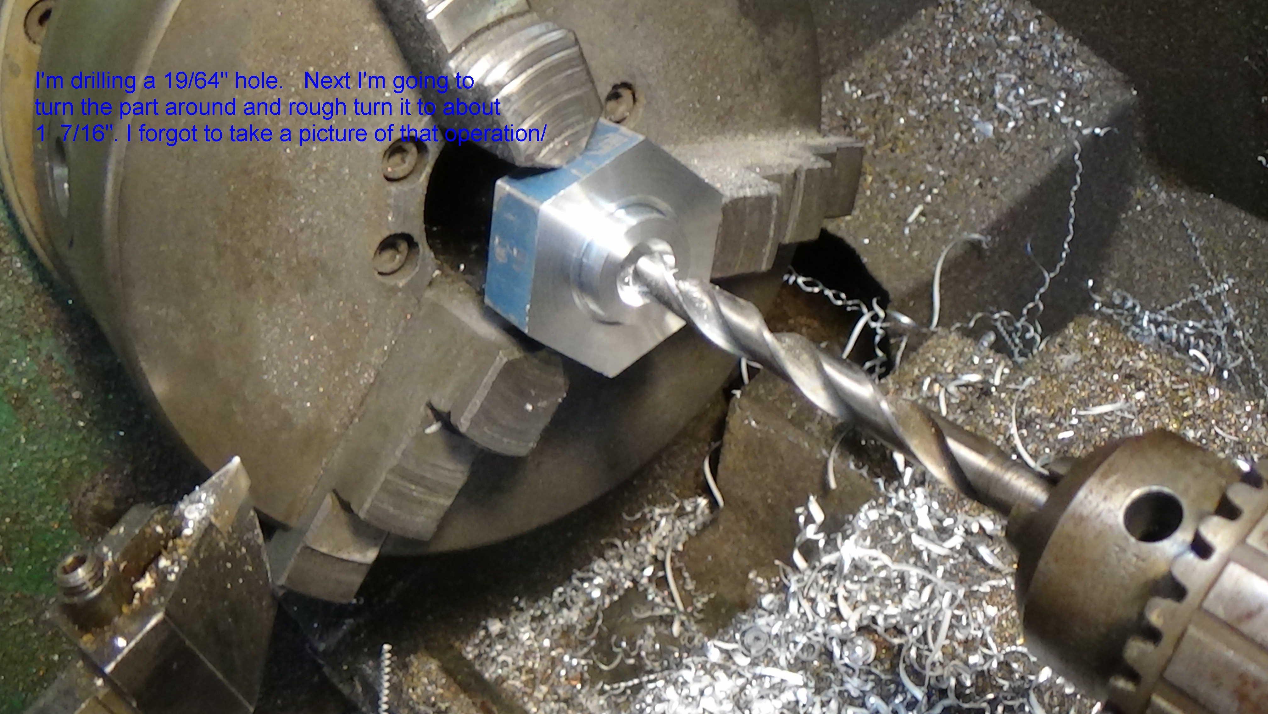

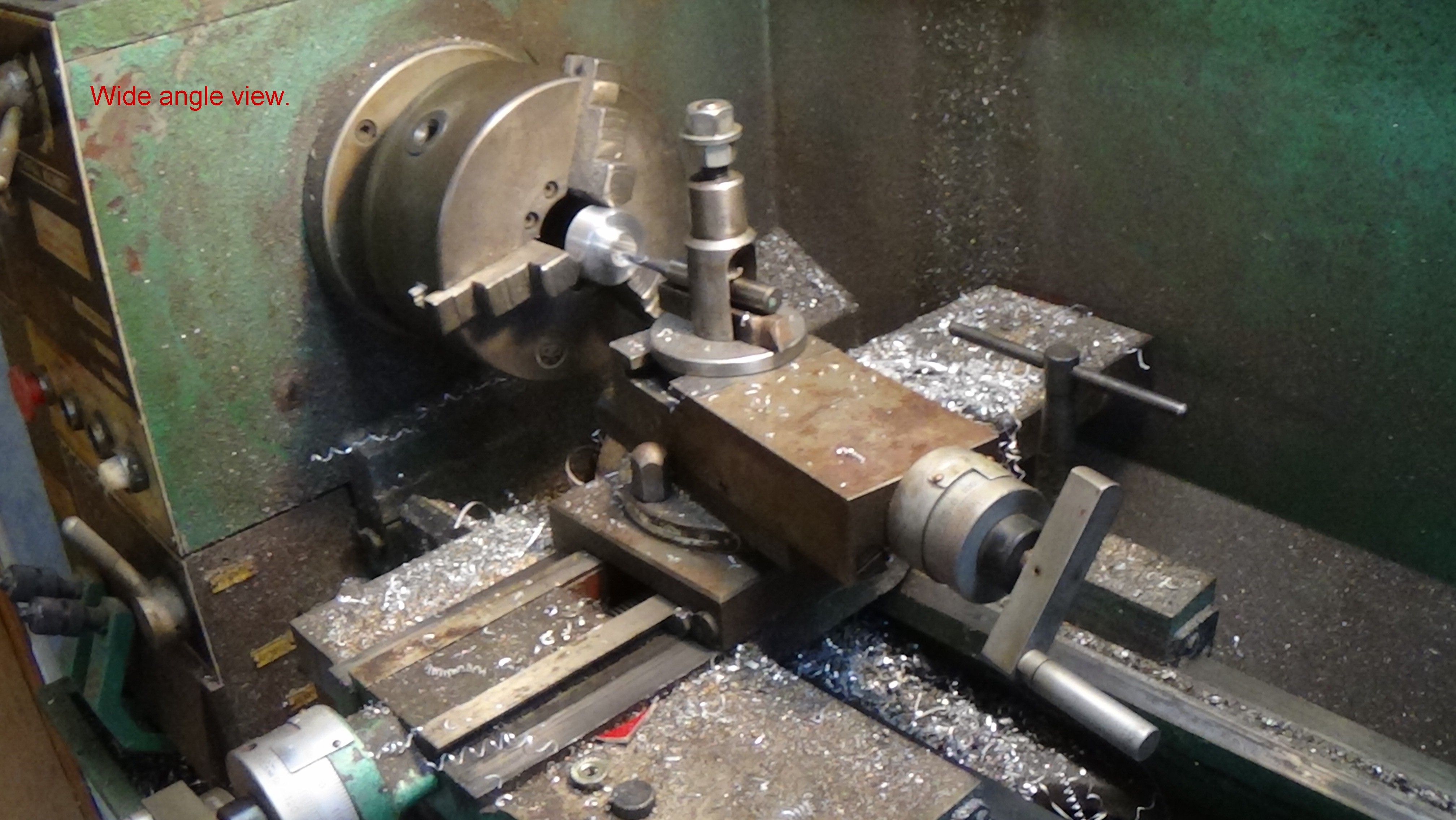

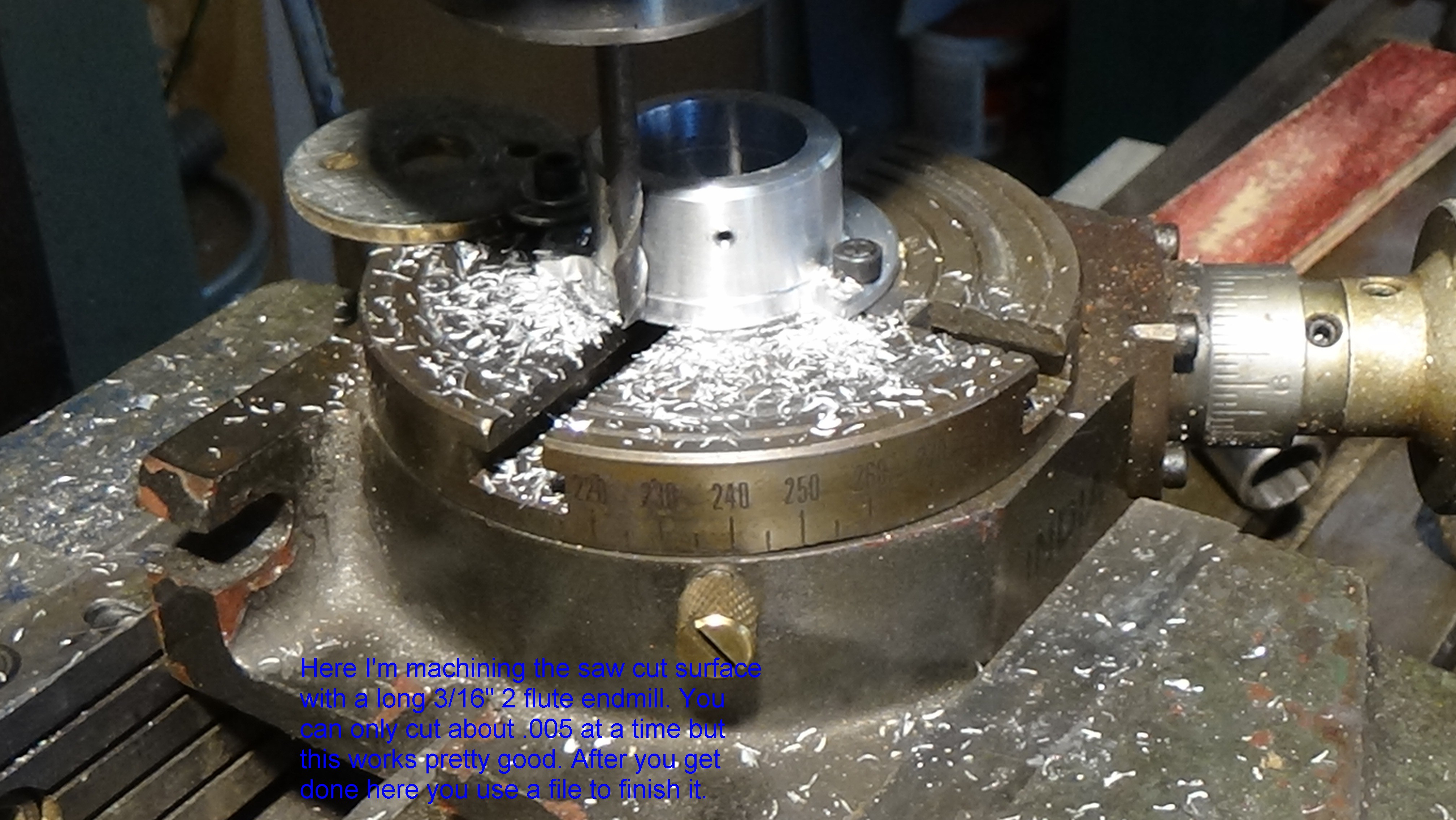

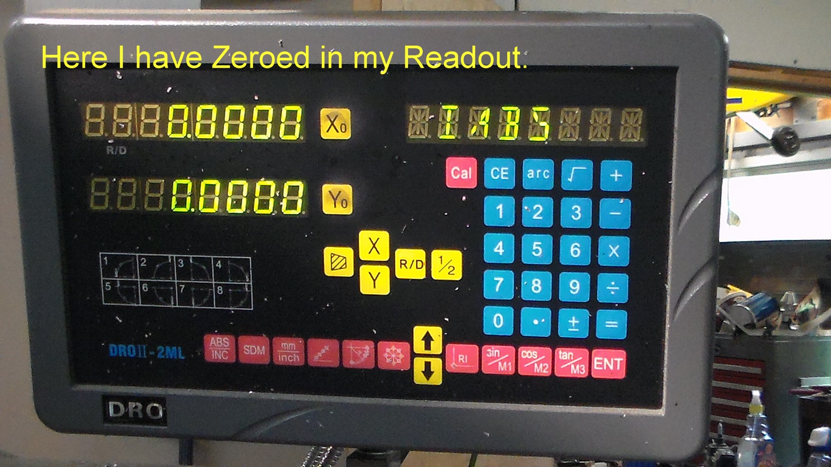

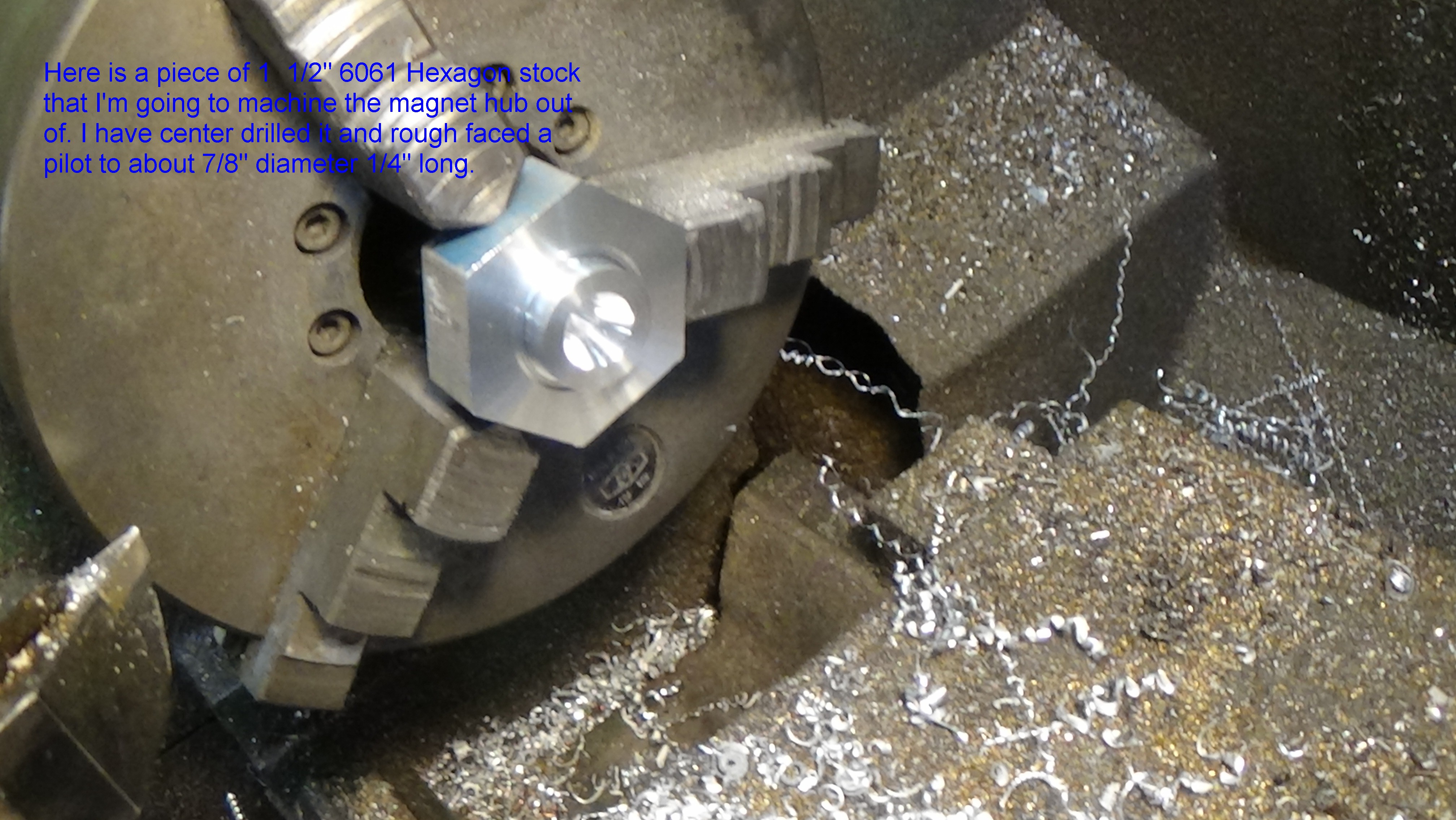

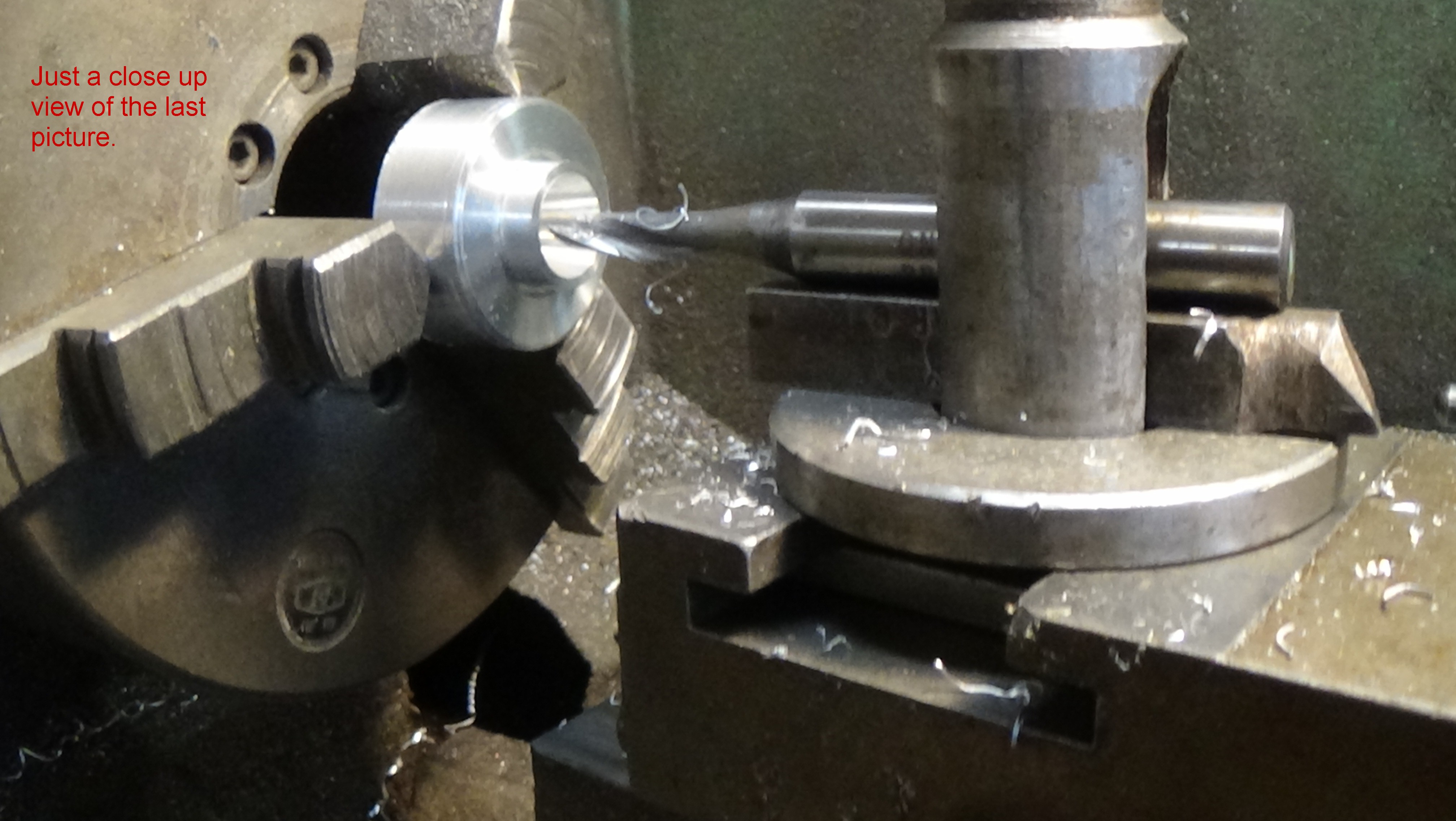

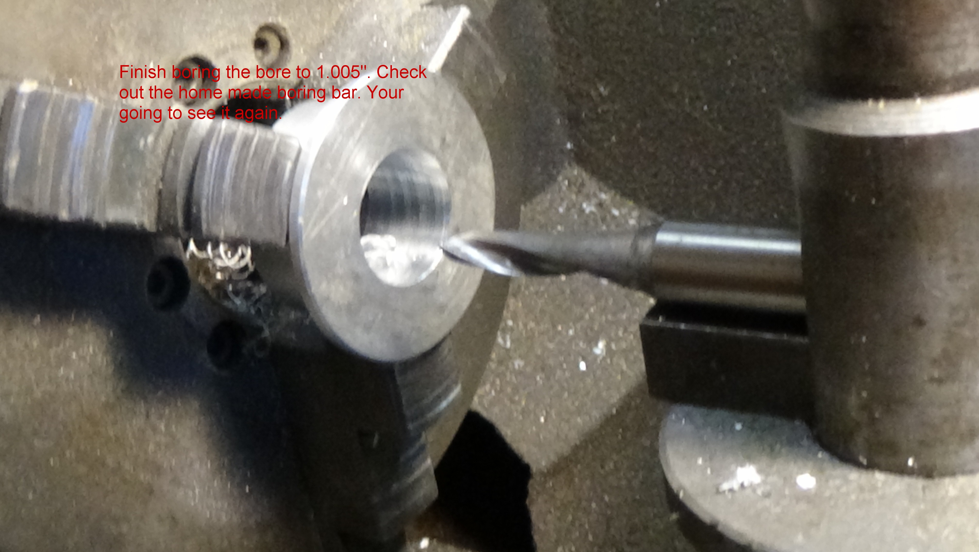

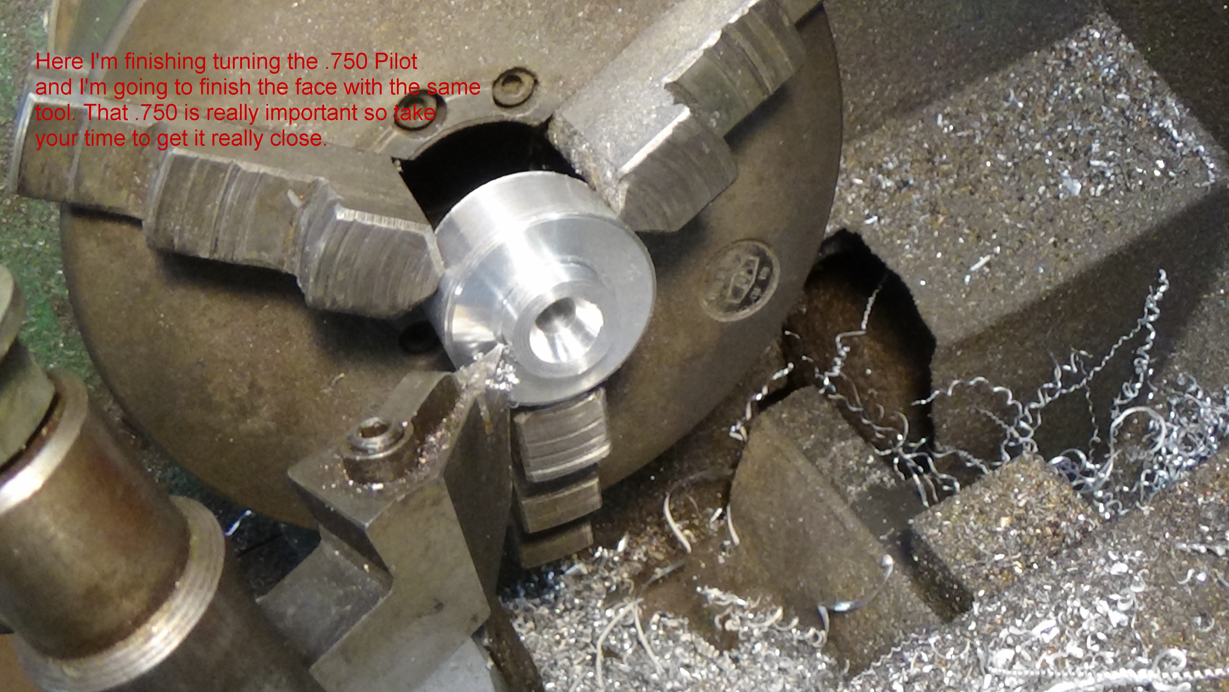

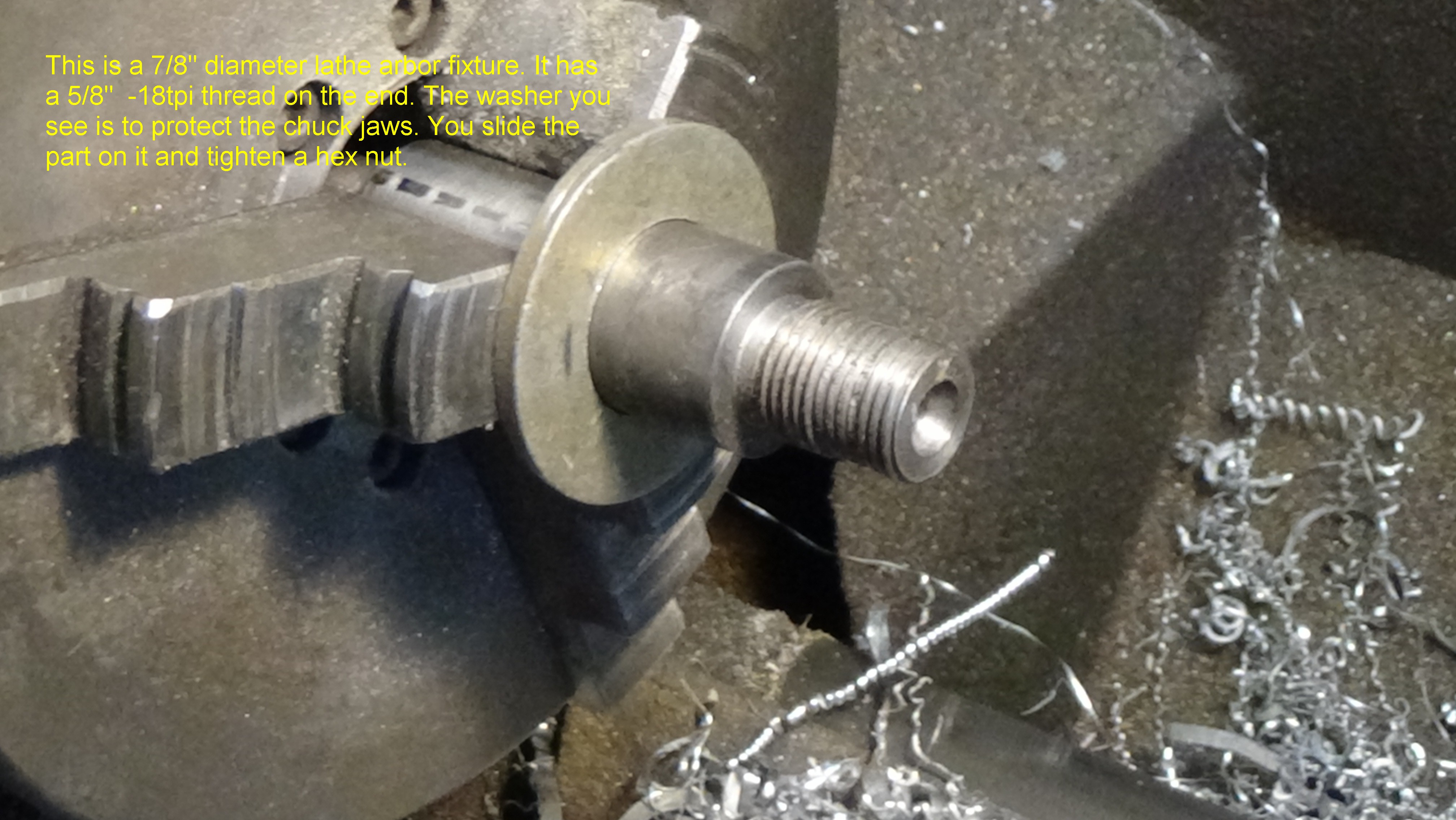

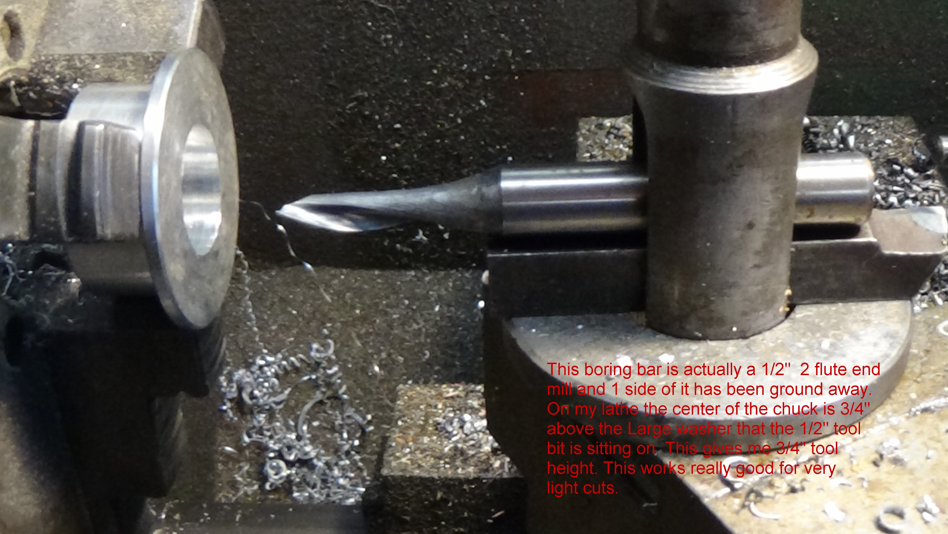

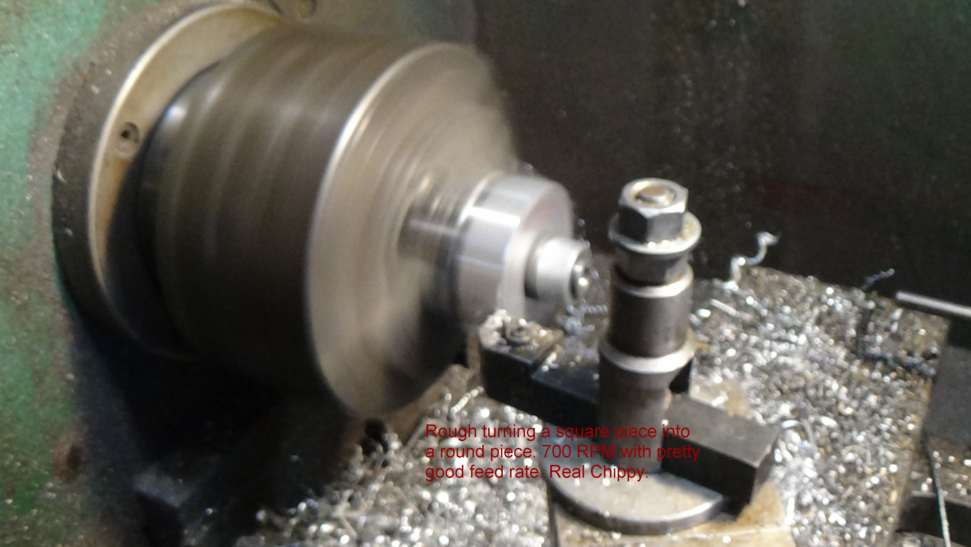

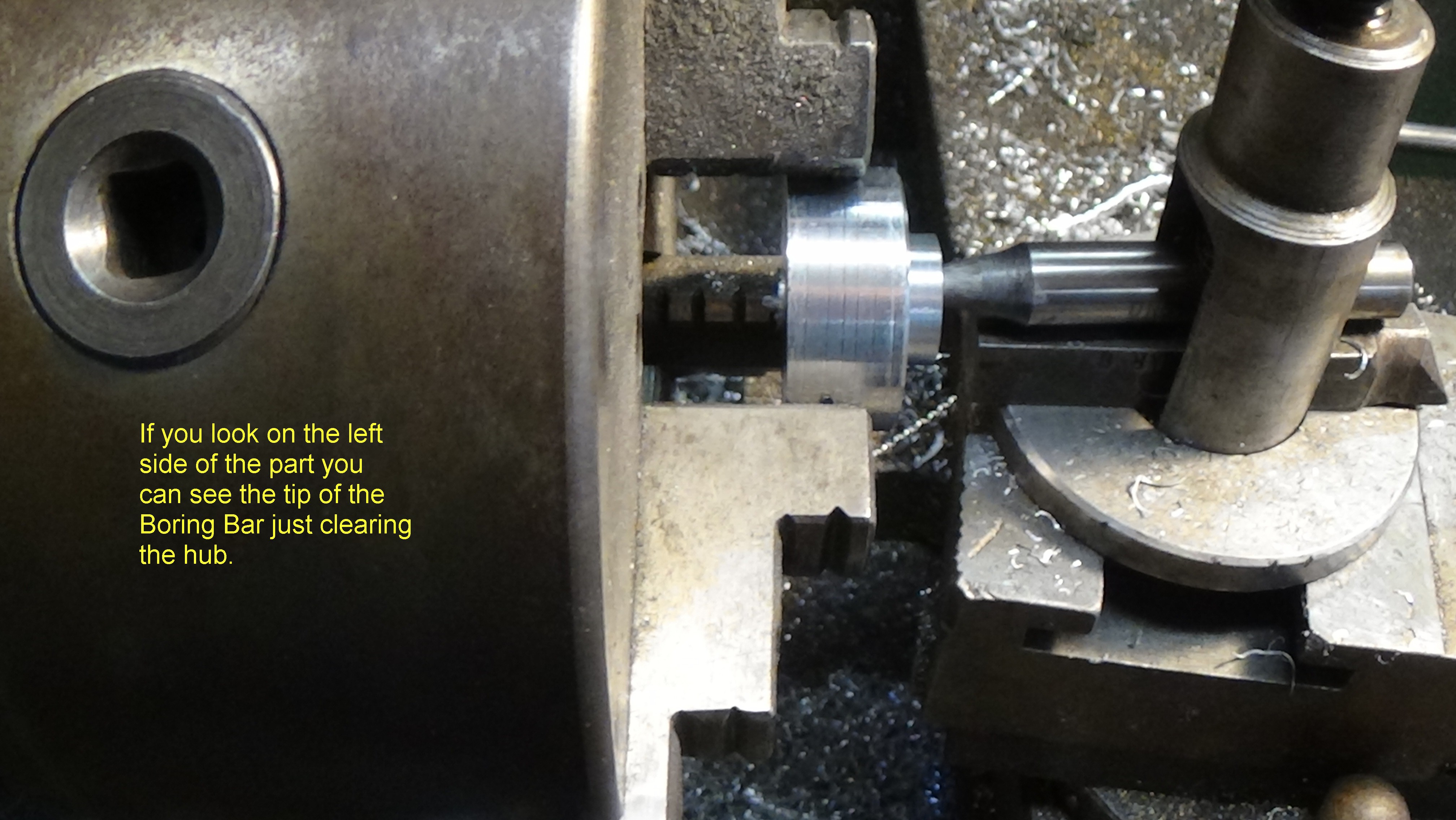

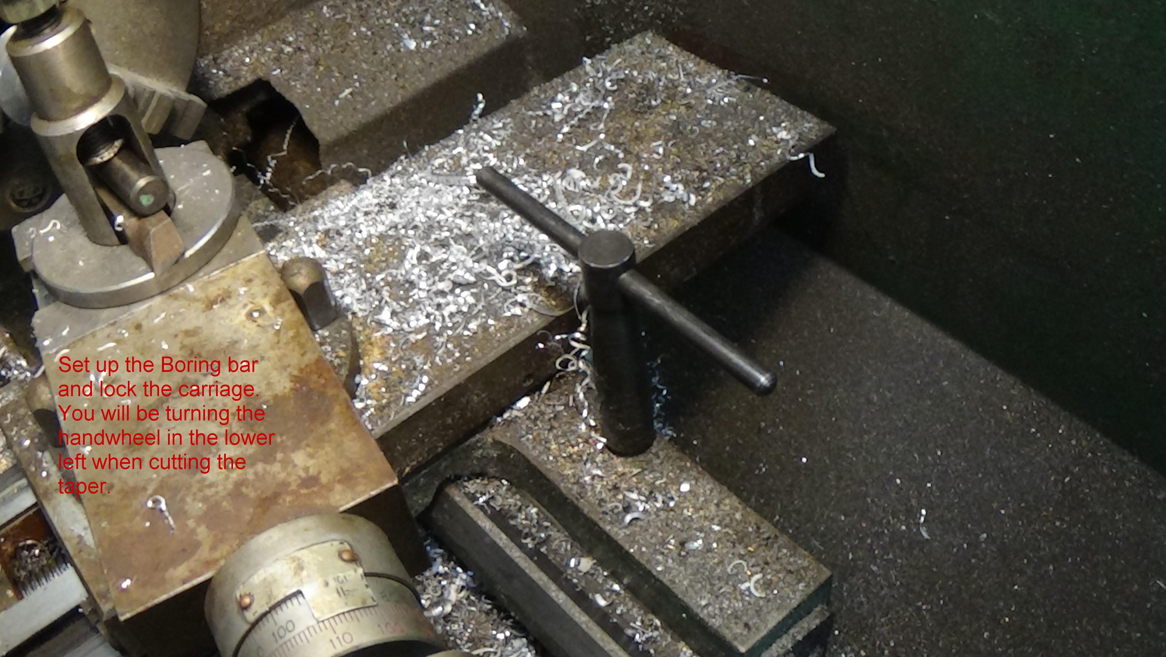

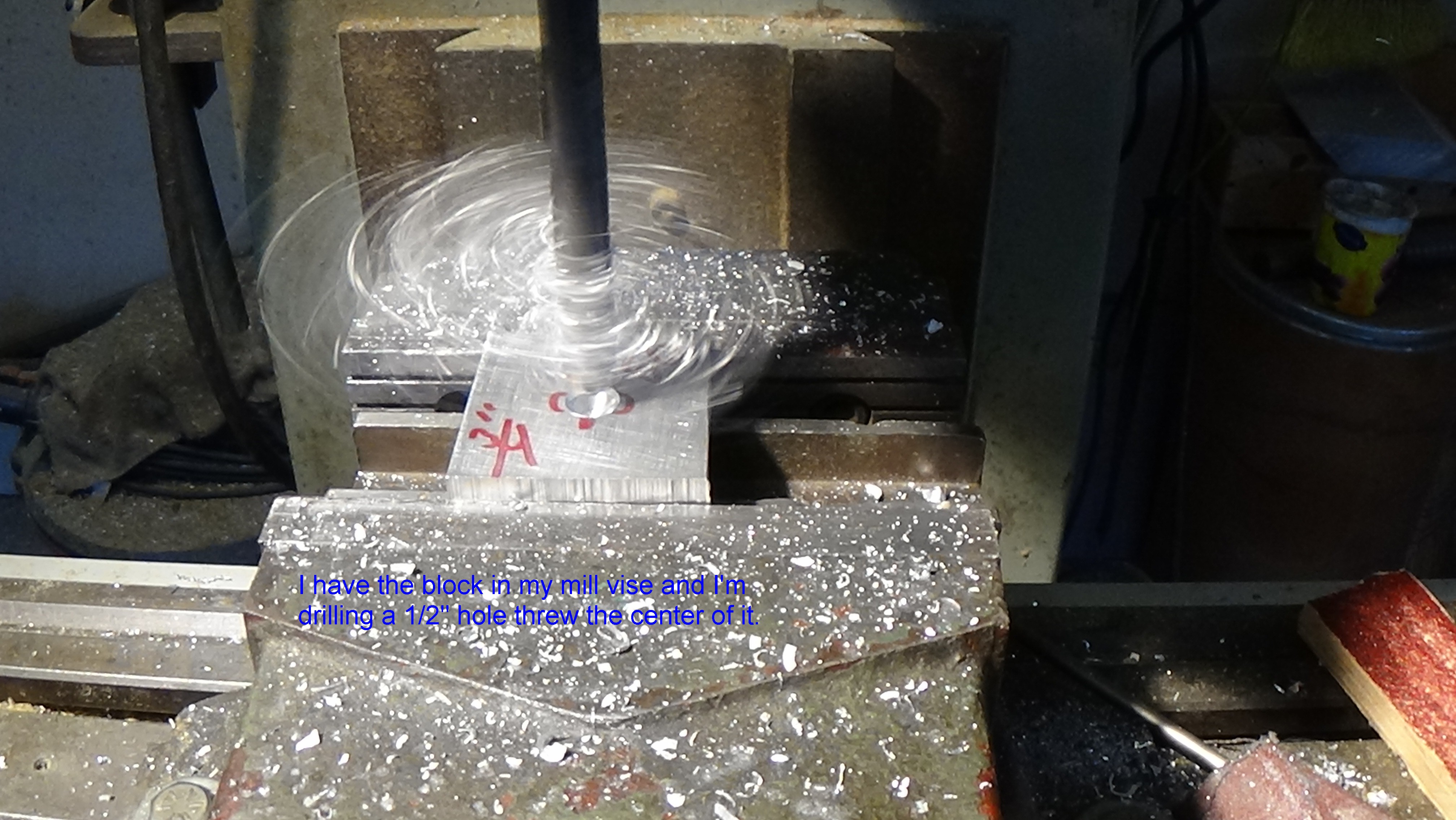

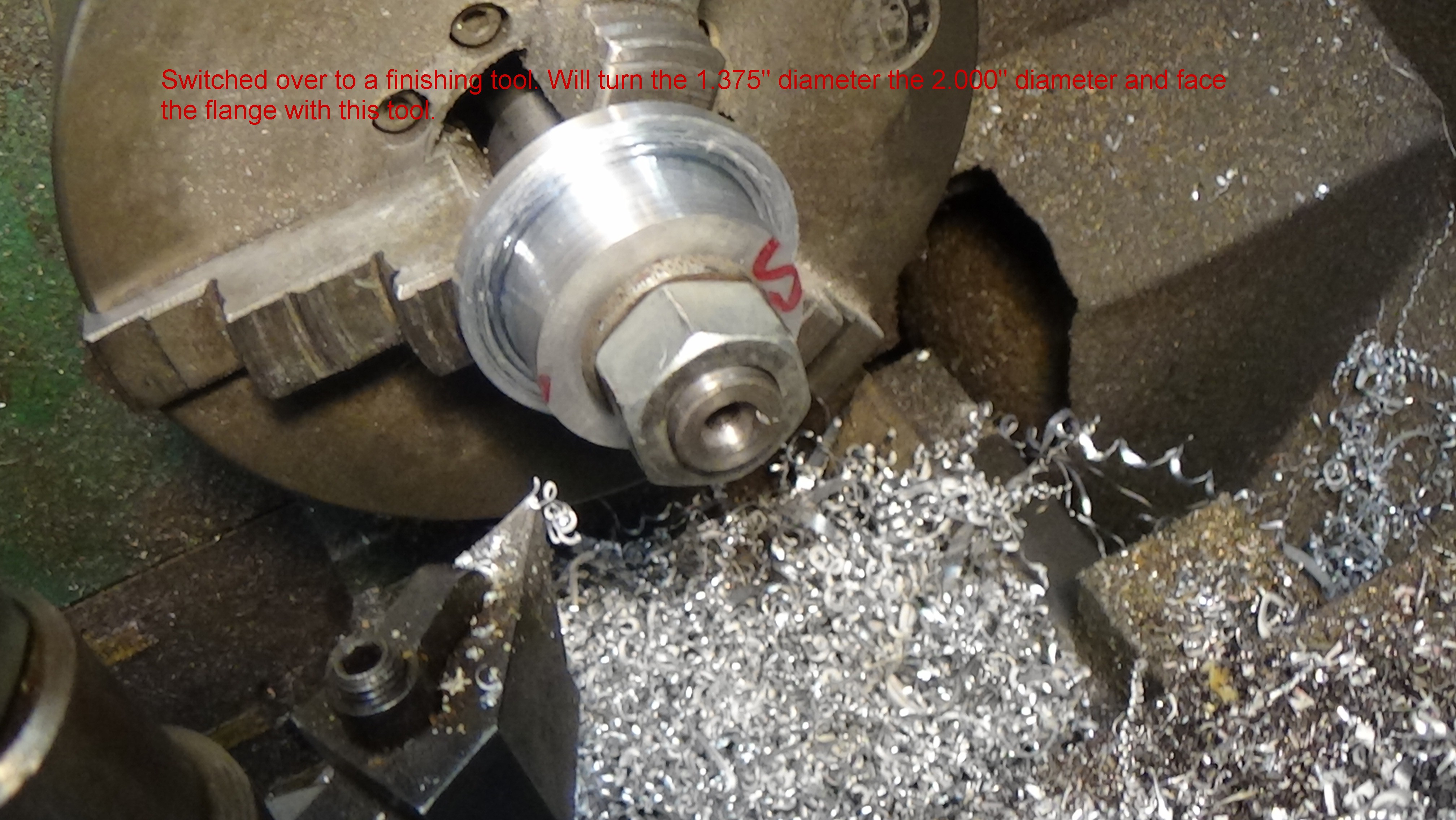

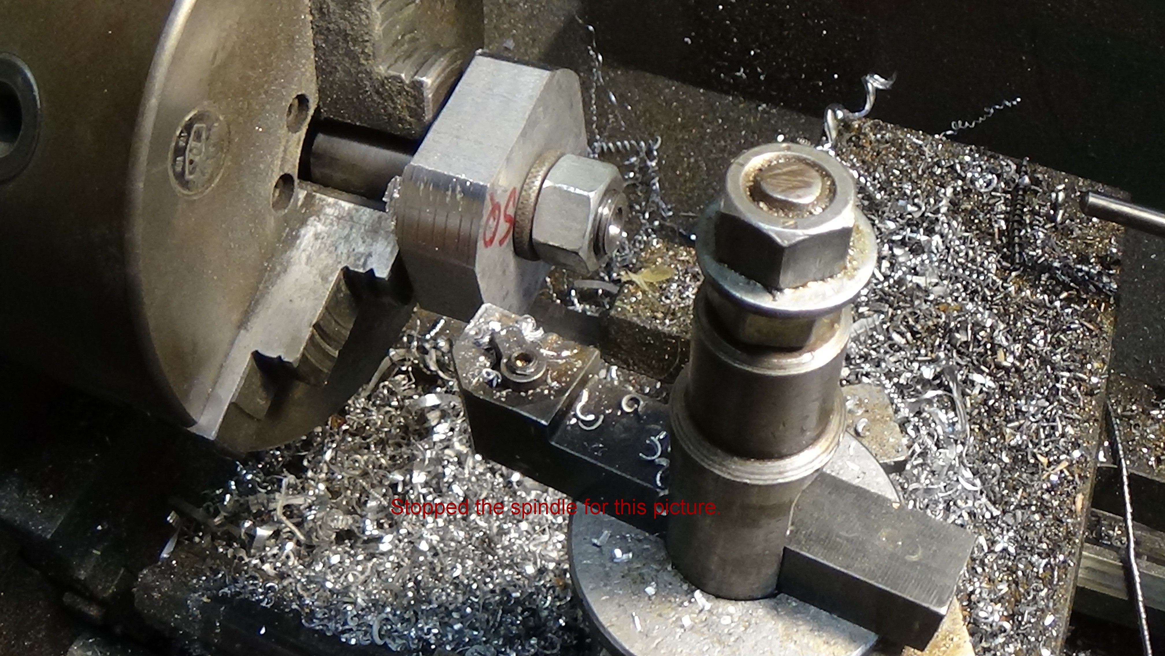

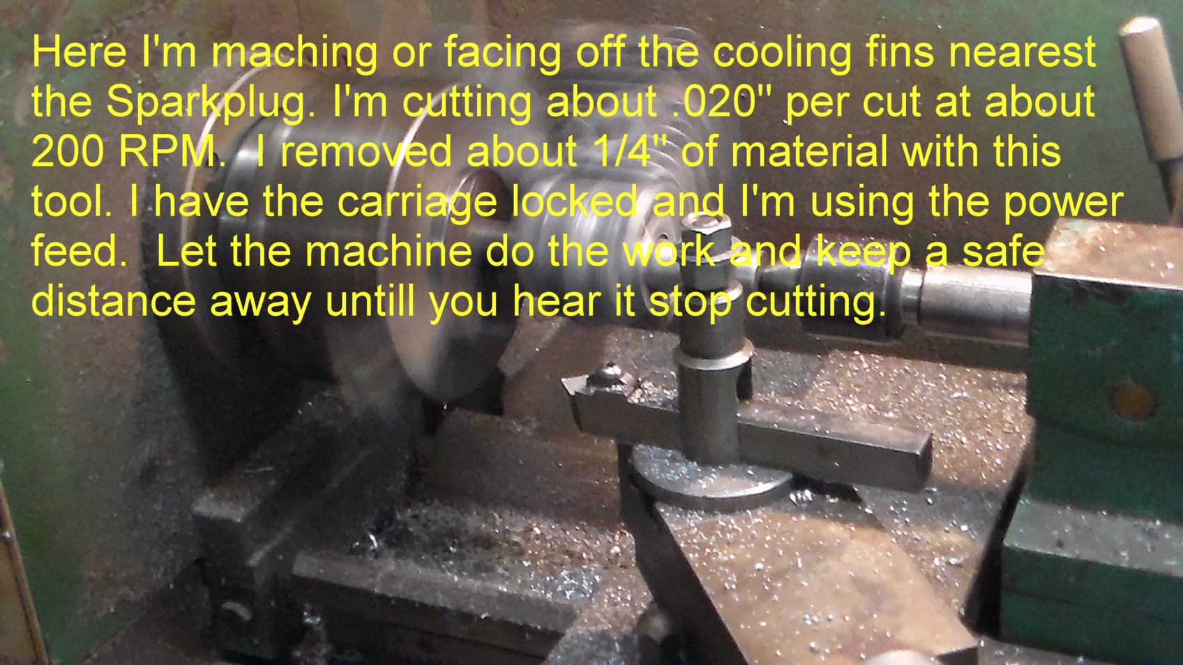

This next group of pictures are all about machining the Tapered bore hub that the trigger magnet is mounted to. For
the guys that have never done anything like this I suggest you get several pieces of 1 1/2" diameter X 7/8" long 6061
aluminum because your going to need them to get the angle set on your compound rest. It's about 10 degrees and
you just need to keep adjusting it until you get it set right.
