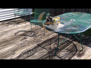

Default Homelite 30cc Break In?
How much break in should a Homelite 30cc require
before seeing normal throttle response and decent idle?
Thanks.

You can absolutely and without doubt trust anything "TIRED OLD MAN" says. He has probably more experience on a professional level than all of us put together.
Having said that, I do sometimes throw a new engine on the test stand for just one tank of fuel to get it sorted and give it one heat soak. Many engines "loosen up" and start to seat the ring quite a bit during that first tank. Plus, if you happen to find something wrong, it's a lot easier to deal with than having the engine on the airplane.

Plus I find it much easier to set the timing and set the mixtures standing up with the engine on my test stand rather than bending over the plane. My back is trashed enough as it is!!

Excellent.
Screams like a banshee on the top end.
Purrs like a contented kitten on the low end.
Waiting on a new tach to compare with the old cylinder and head.
Thanks again for your help.

Good deal! Great work! Don't you just love it when research and hard, careful work come together to create a successful conclusion?
What are you going to put it in? I seem to remember you were using a 16 x 6 prop correct? You might experiment with an 18 x 6 and an 18 x 8 prop. That's a more common size for this engine and you might like it. The 18" prop will provide MUCH more static thrust, and you can choose the pitch depending on the plane and whether you want more speed, or more acceleration/climb. Also, if you were experiencing mid range "burbling", the larger prop will help with that.
