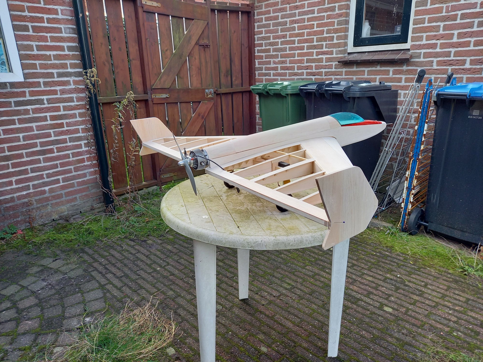

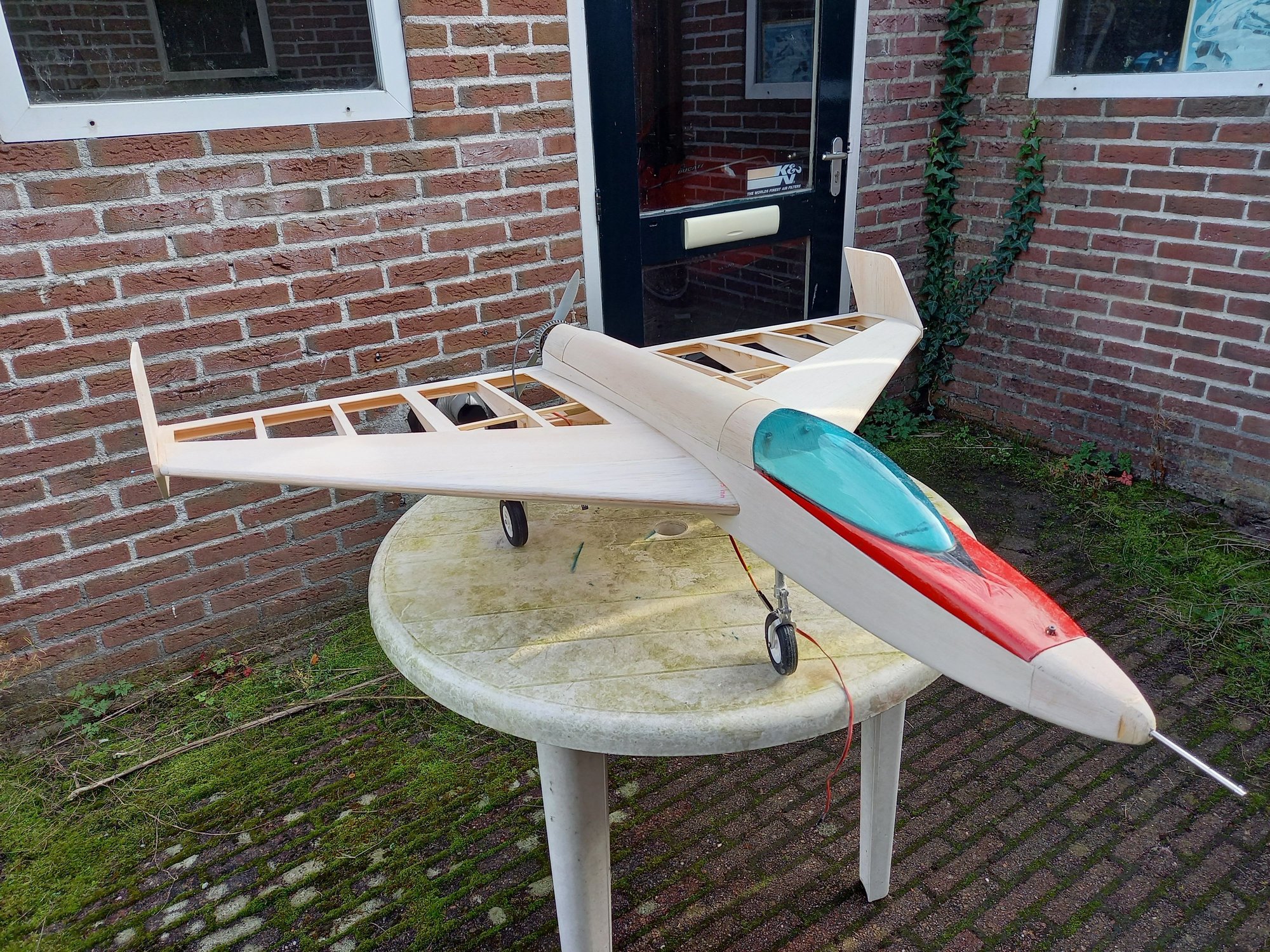

Originally Posted by 1967brutus
A plane build specifically for this engine is underway, but it most likely won't fly before spring next year.
Proudly presenting the M1200:

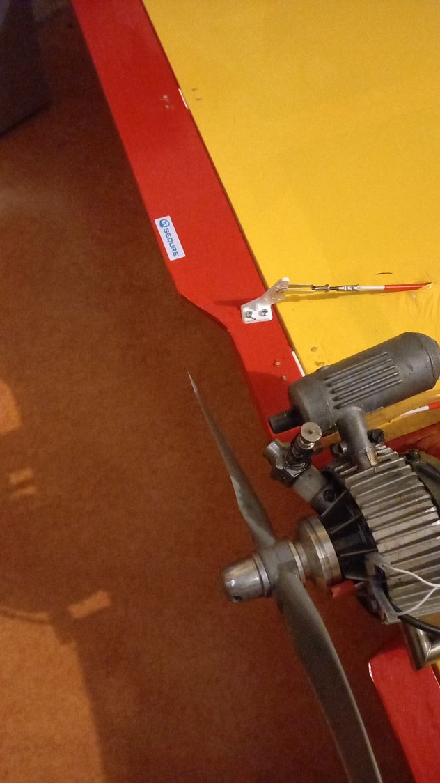

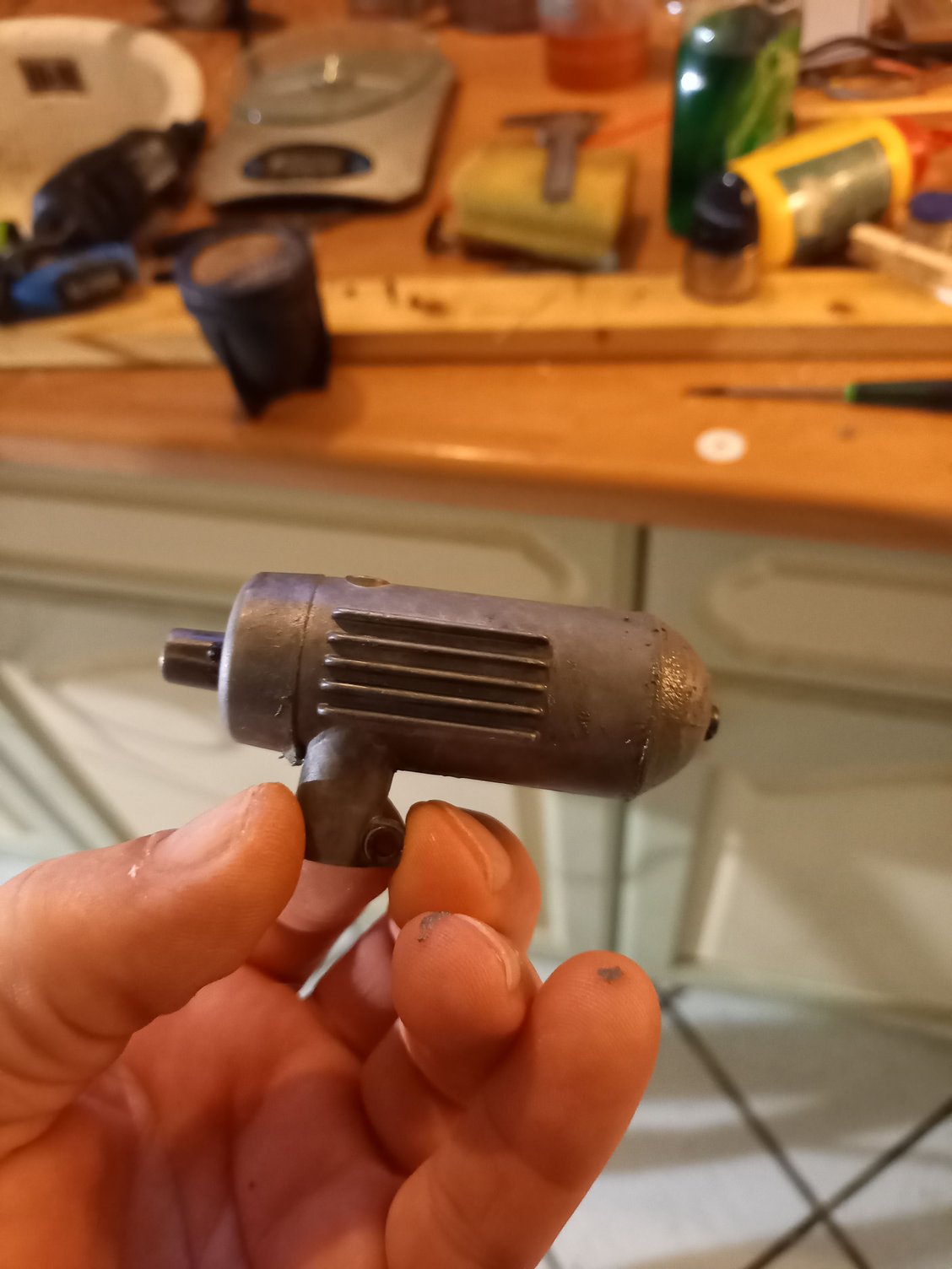

This is about "modifying engines" but has little to do with "modifying to gasoline".
The Wankel is being used in pusher configuration, however, there is no pusher muffler availlable and the stock muffler cannot be reversed. That is to say, it can be, but will protrde into the prop arc.
So despite these parts nowadays basically being "unobtanium", it was of little use to me as is: it would still cover part of the plane with oil during startup and warm up, and I decided to bring out the hacksaw, basically (actually, I used my Dremel motorized Jigsaw, but that's just minor details )
I cut off the dome of the muffler body, and chambered the now open end on a lathe to accept the tailcap. Then since there is not much flesh left to machine the domw, I flattened the edges as good as possible and used Belzona 1111 to seal things up on that end.
Pretty sure I am now not only the only person with an OS Wankel running on gasoline, I probably also am the only person with a Wankel having a "Stock OS pusher pipe"
