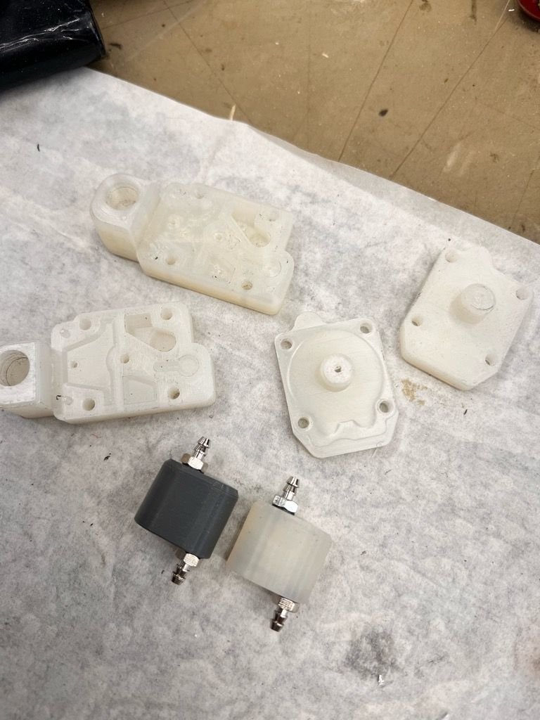

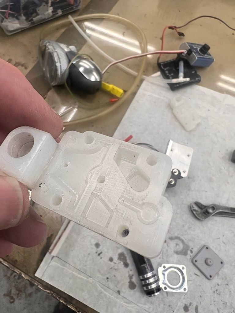

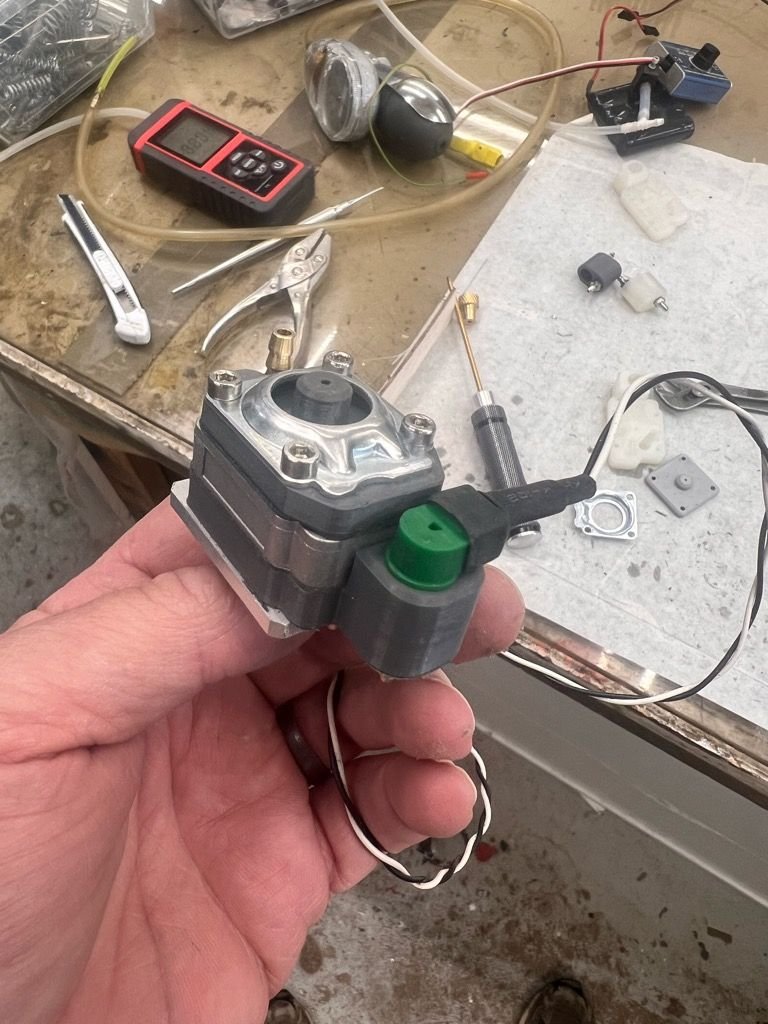

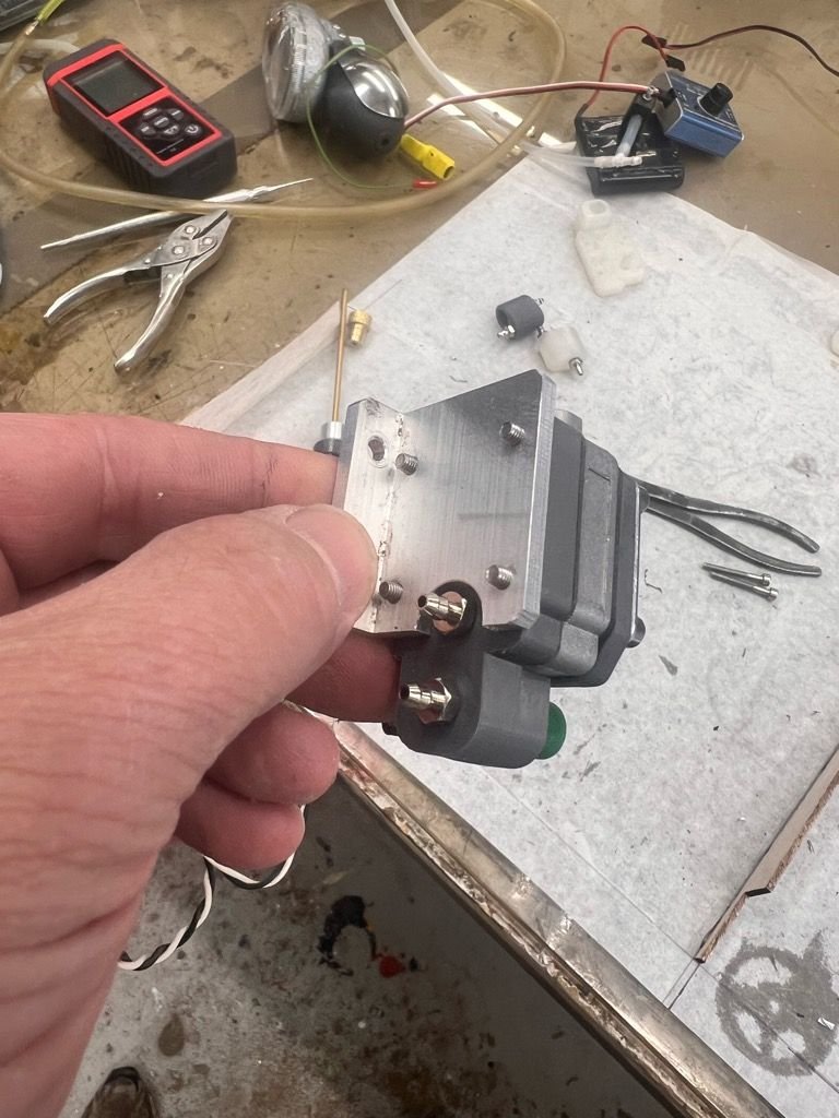

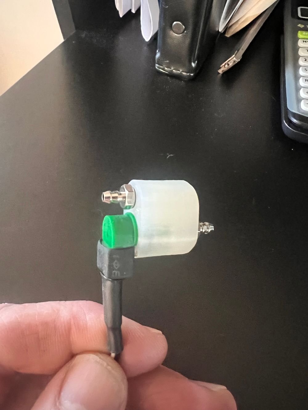

SO.... This little project took a lot more fiddling than one would think but I have finally succeeded at 3D printing a Solenoid housing. Made in Nylon (PA) for fuel resistance the Print parameters needed much tweaking to get a liquid tight seal and tolerances for the housing bore - But its now repeatable on higher end printers I would think.
This is just an offshoot of a bigger trial to print an "all in one" pulse pump and fuel control "block" - getting close on that one too but fighting getting the unit to seal up tight. Have a working unit but its still a little leaky...

Default 3d printed housing for solenoid
Do you think a sla resin should be gasoline resistant in Time it should be more accurate than fdm in nylon petg asa or abs, i have sla and fdm printers i should try your STL but personally, trying to maximise experience of conversion as we use to hear by now, i'm using brutus1967's aluminium housing.

I absolutely like that housing design.

Its one of those "unintended" designs Bert.. I like it too as it's very compact and inline. I wasn't intentionally going for this but I have found if I print with the "openings" at both ends its easier to get a tight seal than if the openings are on the sides and break the continuous outer loops. The ability to do blind internal holes is neat..

As a single package unit here is my effort so far - have a leak proof workable copy now and am working on printing the last piece which is still a takeoff of the $18 Amazon carb. This is an all in one Pump/regulator/ controller. Some of my test pieces also shown..
I would think your ender is capable of this type of printing with patients and some testing. Nylon is a great filament for RC stuff if you can sort it out.

I sincerely do not know if an "all in one" setup is that desirable.
I can see the appeal, but personally, I really do not want to give up on the freedom to place the temp/press sensor to a place of my liking.
