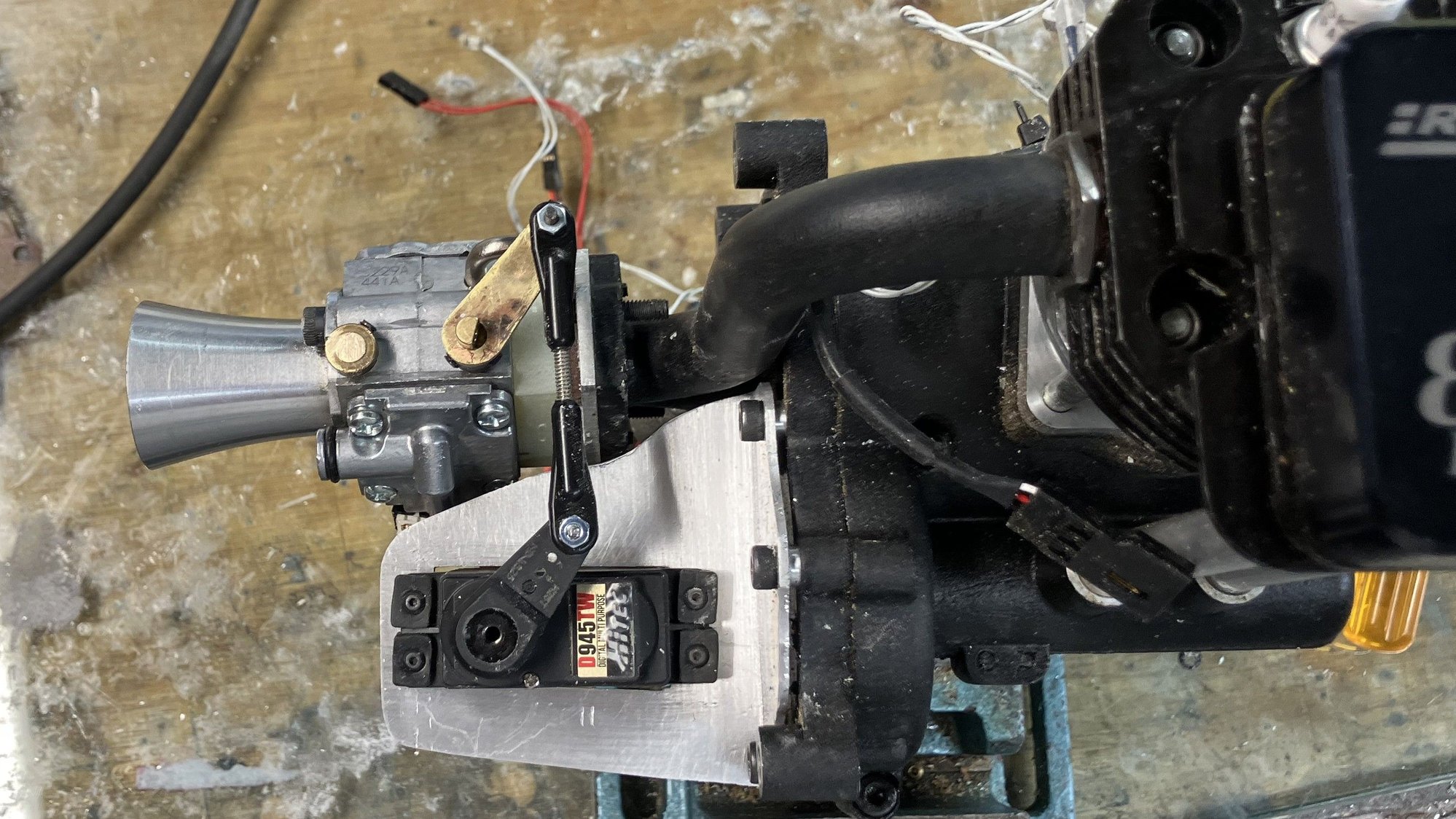

Work is slowing on my 30% Piper Cherokee built so today decided to look at mounting the Zama carb on the Roto 85 FS. This engine was purchased around late 2018. During the built the carburetor flange was broken on the intake manifold. Little info was available at that time and I purchased the engine from an importer on Ebay. Made up a piece of aluminum that is screwed and glued on with JB weld. The repair worked well over the 5 year period that I flew the plane. The second engine I purchased a few years ago has a much more robust intake manifold.
The hole in the intake is 1/2" in diameter, the original Walbro WT962 has a 14mm bore, and the new Zama needs a 20 MM bore to accommodate the black plastic piece. The plastic piece sticks out about 1/2" from the flange on the carb, see second photo. I plan the make a isolator plate out of 3/8" G10. The plastic piece is there for the idle circuit.

About ready to tune the engine, waiting for a warm spell, less than 20F now.
The throttle servo is set for a 1 to 1 movement, so that 1 degree on the serov moves the throttle plate 1 degree. The throttle channel is controlled via exponential curve, the solenoid channel is controlled by a curve used by Jim Thompson. The S1 slider is set to add or subtract 15% from the solenoid curve for tuning. The engine is equipped with RPM and cylinder temperature indication. Pressing switch SI will play the current output value of the throttle stick and the solenoid channel. Each click on the throttle stick is approximately a 10% move from -100% to +100%, thinking i will tune at each click, then plot the data and fit it to whatever point curve makes sense in OpenTx.
Am I missing anything?
#2712
Because at full throttle (high end of the curve, where the values are high as well) 10 or 15% more or less fuel isn't that bad, it's a fairly decent range of adjustment.
But at lower throttle settings, where the curve is low, 15% more or less WILL kill your engine. Probably 5% allready will.
What you need to do, is set up the programming such, that the curve is fed to an unused channel (say, channel 17 or higher, one you do not have a servo connection for) and then set up S1 such that it affects the "weight" of that channel. Then link the output of that channel 17 back to the channel you hook up the solenoid to.
That way, adding 1% of fuel by means of the slider, will be 1% of the actual curve value that you are running at at that time.
Set S1 in neutral and set up a running curve on the ground. Go fly, and whenever you detect a spot on the throttle range where the engine is not running to your liking, you can carefully tune, for no other purpose than to determine whether that rough spot is lean or rich, return the slider to neutral (these sliders should have a tactile neutral position), land, and adjust the curve accordingly.
Be very careful when doing this, because airborne, "running optimal" and "flame out" are VERY close to each other, there is not much of a lean range between those two points, and at times, rich and lean are hard to distinguish by exhaust note alone. Therefore, when adjusting, ALWAYS first test towards "richer". If running improves, you were apparently in that very narrow lean range, if running deteriorates, you know you were running too rich.
A first adjustment towards lean because you THINK you heard a rich run, in case you misheard, will cause a flameout and a deadstick landing.

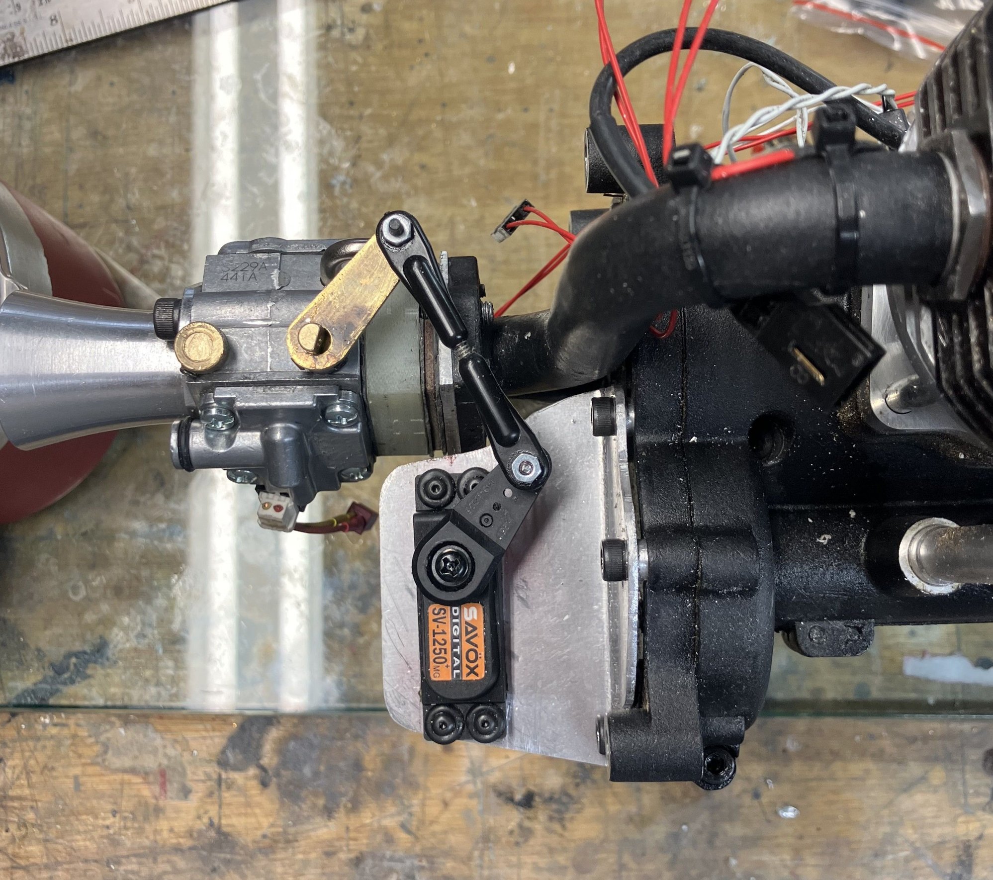

Had a little extra time yesterday and decided to start the engine. Solenoid off , ignition on, choke off, after a dozen or so flips the engine started and ran. Shut it off and turned the solenoid on. Had the throttle trim set to the max. Started again and attempted to reduce the idle speed after a short warm up, was running at 3400 rpm, with the trim was able to reduce the engine speed to 3000 rpm. While at 3000 rpm turned the slider to full positive position and slowed the engine and turned to the negative side and was able to kill the engine. I did not remove the idle stop screw when the carb was installed. Shut the engine off and removed the carb to remove the idle stop screw and reset the throttle travel.
My channel output is -100 to 100, with the slider set to add 15% this gives the ability the change the output by 0.1 %, I feel good with this.is good. I'm only guessing here but I think the carb is not as sensitive because the engine much larger than the conversions done on glow engines.
At any rate I really enjoyed doing the conversion and expanded my knowledge in the Arduino world, thanks to all that the paved the way!

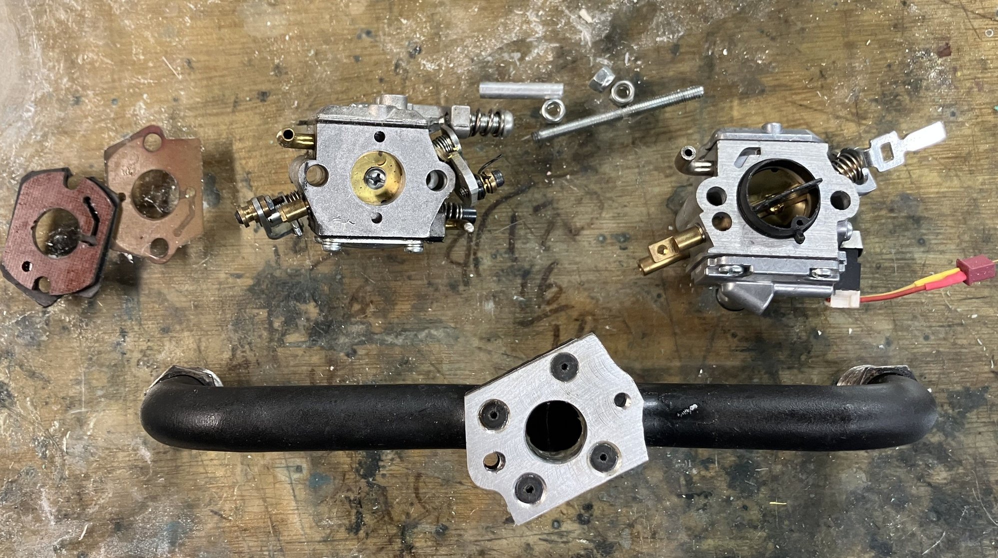

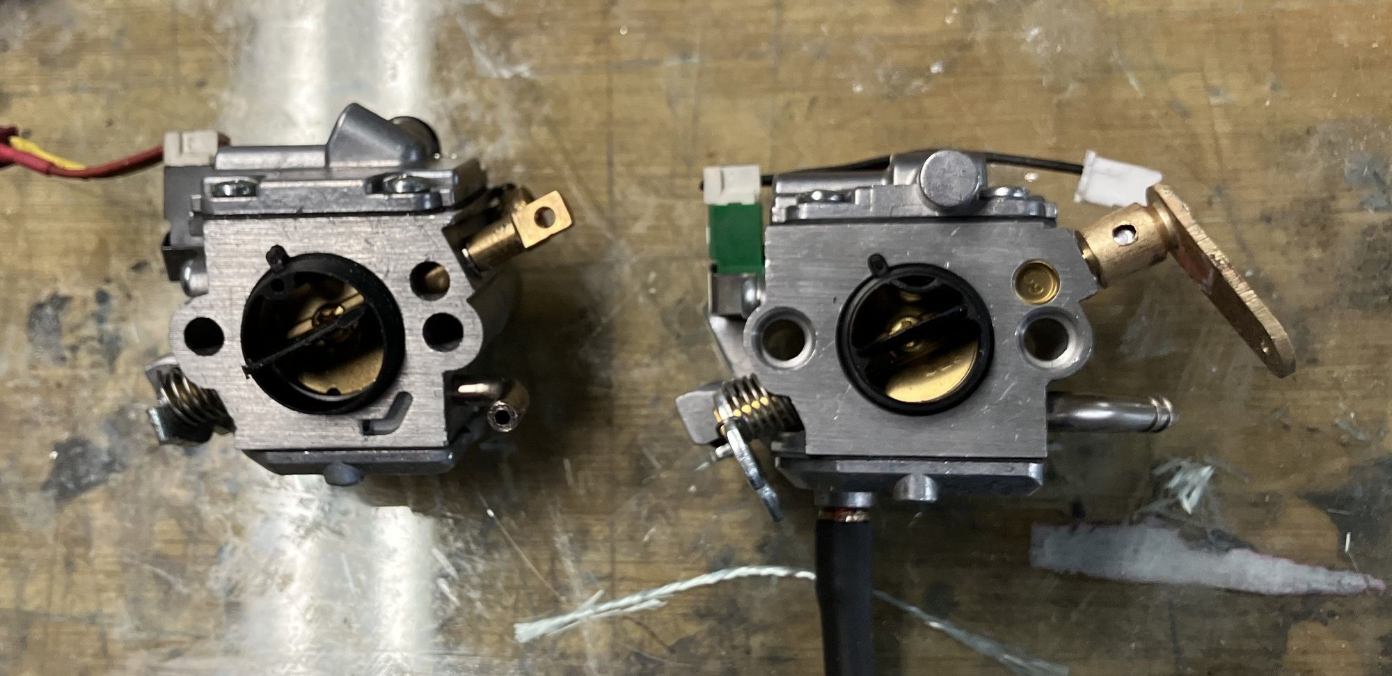

With the carb back on and the throttle servo reset started and ran the engine, lowest possible idle when leaned out was about 1600 rpm, this engine would tick over at just over 1000 rpm with the WT 962 carb installed. When I look at the throttle disc you find the small slot where the idle jet is and there is also a second slot about 160 degrees across, I have not seen this second slot on other carbs.
When I compare the slot in the WT 962 carb it is much smaller than either of the slots on the ZAMA. I would estimate the slot area to be about 6X that of the WT962. I would like to have the idle set before completely the final tuning. Going over the gaskets and heat isolators, might find an air leak.

Found another carb for the MS201TC saw that has a smaller bore, it's on the way, may need to make a smaller heat insulator to hold the black plastic piece in place, we shall see. Should be here next week. I believe the existing carb is for a 55cc saw, the MS 201 TC is 35cc.
