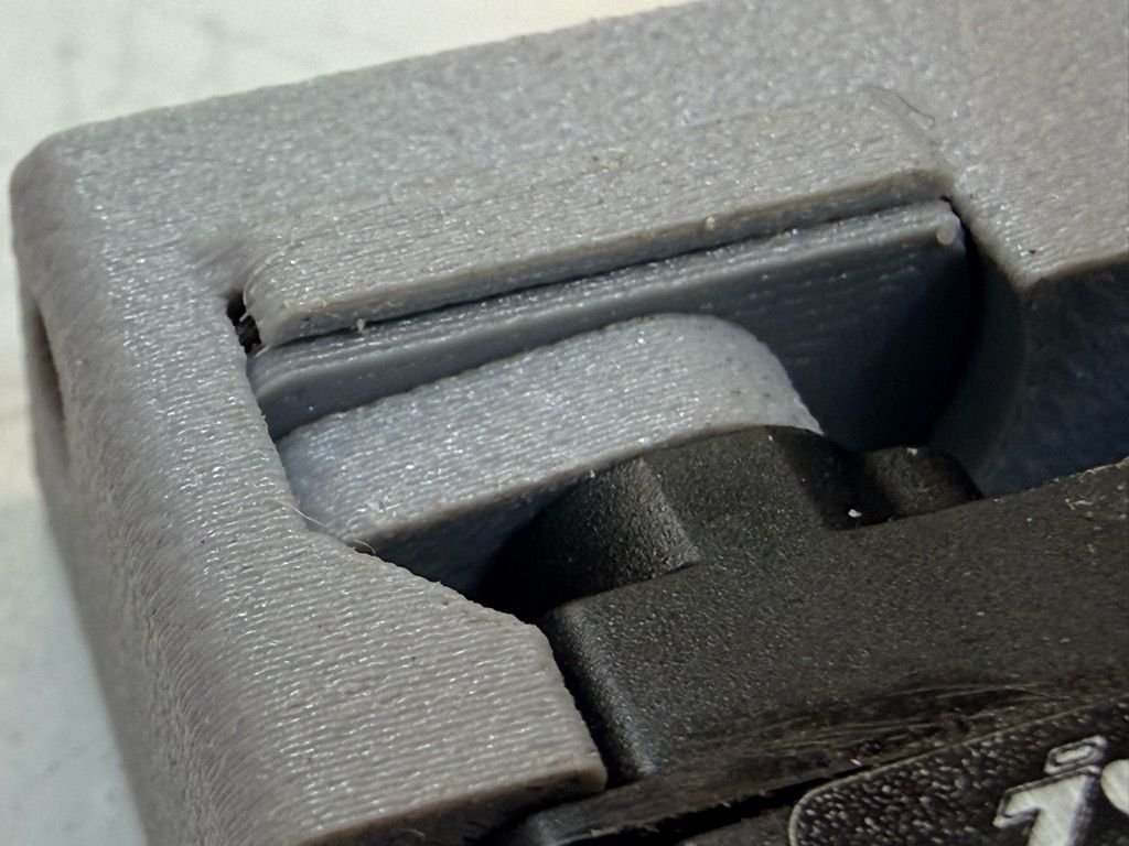

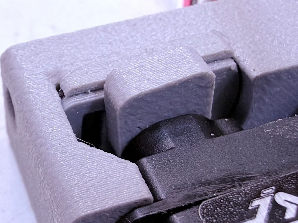

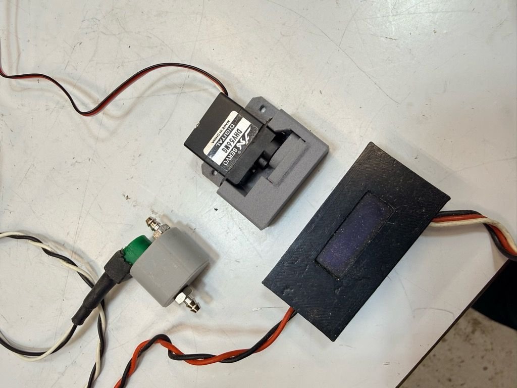

Here is where I am- just as you describe. A small printed rotor against a flat seal plate with a hole. The curve is “area ruled linear” for the hole as it turns through 90 degrees. The plate was going to have a oring for seal and some seat pressure but I think I will try some foam tape as all orings I have are on the stiff side. The seal plate and rotor will be in a printed “box” that attaches to the top of the servo using the original mounts.

Something like that, absolutely would work...
My thoughts however were more along the lines of something suitable for a microservo, to keep it as light and compact as possible.
A bit like a plugvalve. Since you can print 3D, square holes (linear area increase) in the plug and body should not be an issue to print, no?
Although I an not sure if linearity really is that important, given the free programmability of the curve.
But what I am thinking is, it might be a bit more "size limited" (a smaller engine requiring a narrower valve passage than a larger engine).
I have to say, I absolutely like this...

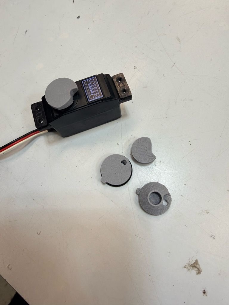

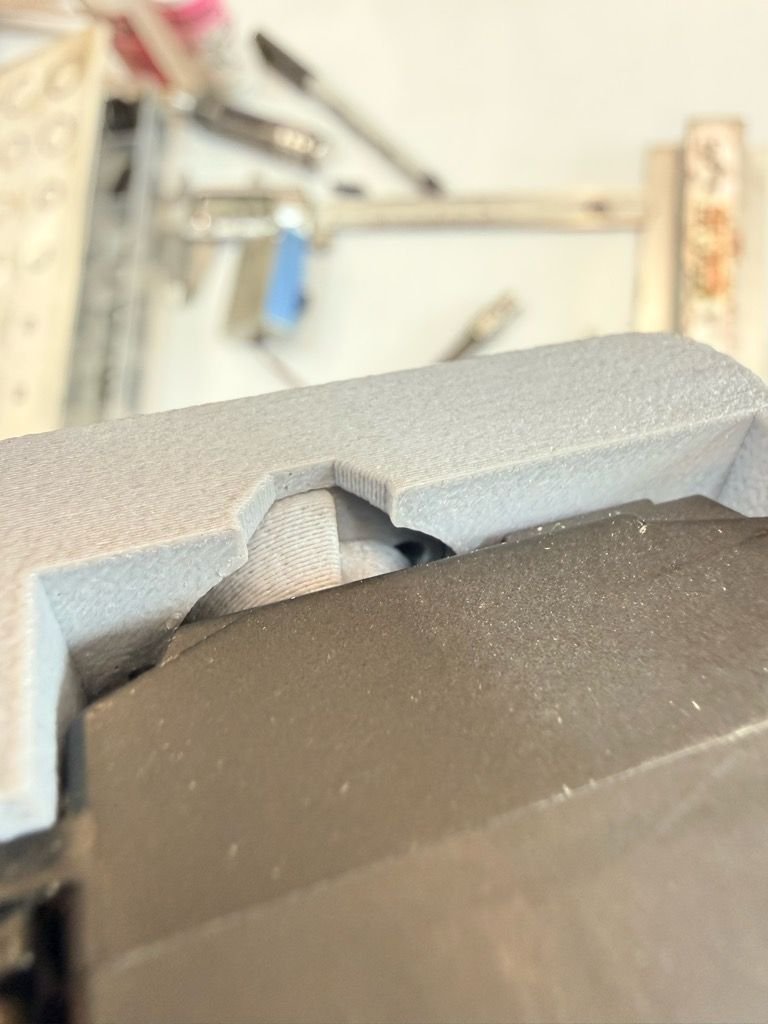

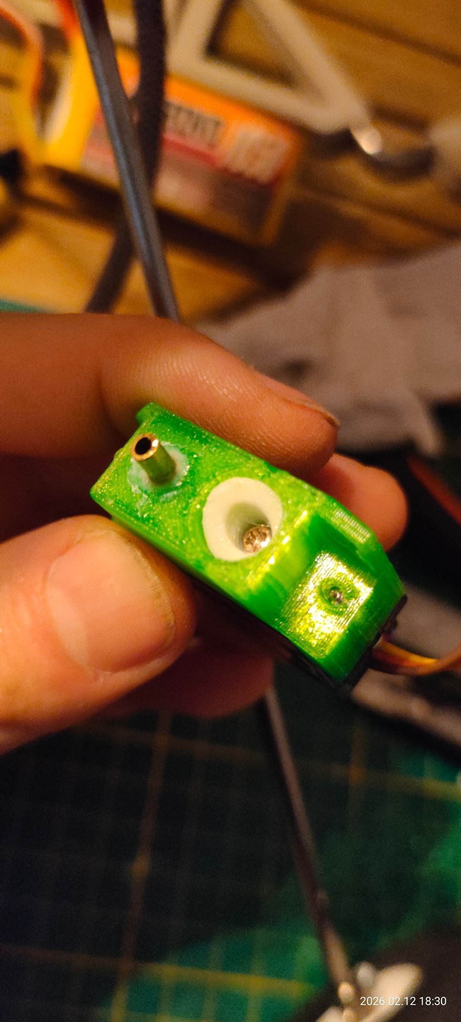

This is a mini servo…only because I don’t have a micro with what I would call good resolution. It’s smaller than the first version.
Send me a drawing when you can as I tend to get stuck on an idea when there are many ways to solve this. My earlier ones are what I would call a plug valve but maybe you have a different idea. I like this latest version and it seems to work well. It can also be made smaller or bigger easily if needed. I can print square holes and plugs but the biggest limitation with all this is print orientation. A square hole is trouble if it’s horizontal. (Support for the roof).
the effort has been to try to get the required flow (about the area of a 2.5mm hole at max) over a full 90 degrees of servo travel. Testing shows a fairly benign criticality though as the bleed seems to have some range of acceptable setting throughout except very close to closed throttle
Getting smaller
Valve half open

yeah, size is different to judge in pics, I was going by the assumption that 4 attachment lugs meant a standard size servo, as most my smaller ones only have 2...On the bolded, I would think that a progressive opening aperture could make the area near idle less critical? Something like a triangular opening in the valve plug against a circular opening in the housing?
Just thinking out loud here.
Normally plug and housing having both a round aperture, results in a very regressive opening characteristic, and even a theoretically linear shape, like "square on square" is not as linear as it seems, despite the flow-area is mathematically linear to opening angle.
But a triangular opening is not suitable for a plugtype, that would be more fitting for your earlier linear slide valve design.

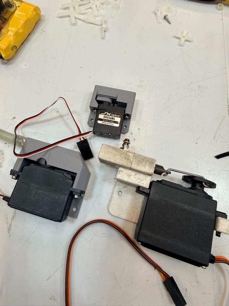

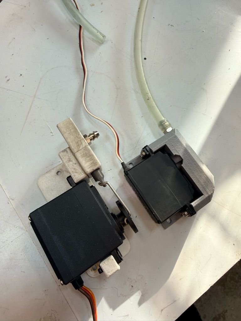

Here we go... The baby is born and it works well in function tests. Seals really well and is very smooth in operation. Size comparison to other versions and the solenoid and control box setup.. The shape of the square hole (visible in the one function picture) could be modified to change the opening characteristics. Just have to affix a hose nipple and will try to get this tested. In design it should flow the same amount (or more) as the first version.
#2738
So micro works just as well as big brother... The "system" seems very uncritical. I ran the 91 4 stroke and a 37 two stoke and both set up with very quick tunes to be quite good on bench run. The Air is injected on the .37 by replacing one of the carb screws with a nipple as shown.

Cat, that's a really great solution! I love Bert's solenoid, but it requires more electronic modifications (and I've already had two Xiao solenoids fail after my plane was in storage for a long time, I don't know why). I'm currently assembling a Spacewalker with an ASP FS61, and I'm going to try your air bleed system on it. It's such a simple and easy solution! Well done!

WOW! I really am impressed how this solution seems to be repeatable and especially how this setup seems to eliminate the need for throttle delay.
Also VERY pleased with that solution for the air injection on the 2stroke.
Not even going to do an effort for an alternative design, for reason it won't be any more compact than what you allready have, NOR do I see any improvement from what I had in mind.
Can't wait for the flight tests!

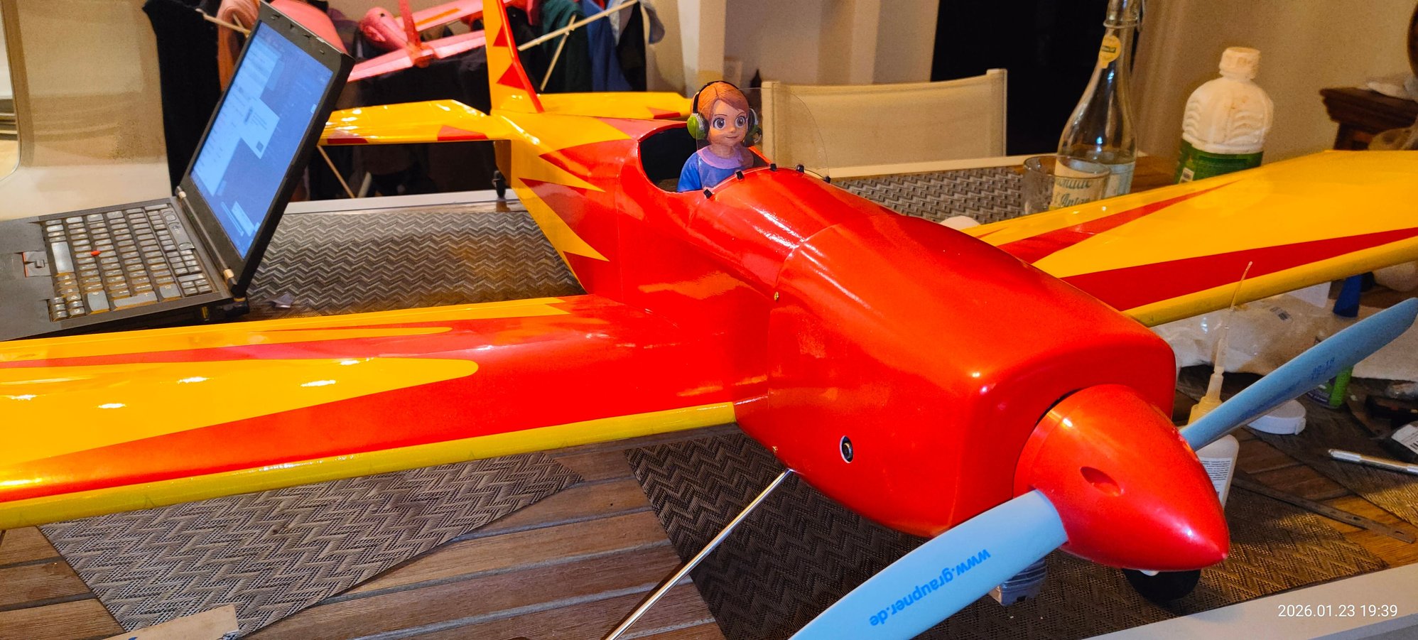

Hi Bert, yes it's the first spacewalker from seagull of year 1999 I think.
Wingspan is 160cm, and normally it's for a 52 fs.
I hope my 61 fs converted is enough, if not I will change for the 91 fs.
The solenoid controller from you never failed, but the others I make with seeeduino Xiao failed randomly after a storage, I don't know why.
My air bleed valve :
Engine test tomorrow if the weather is ok.

Mine is the one from VQ if I am not mistaken, but AFAIK it is the same. MIne is something like 155 cm or so, just a touch over 1,5 metre anyway. Weighs in at about 2,6 kilo, mine, and it does very nice on an FS91 and a 14 x 6 prop. Strictly talking gasoline conversion, of course, on MEthanol a .70 fourstroke would be enough and an 80 would already start to get ridiculous.
But with gasoline conversions, it's the old adage of "nothing substitutes cubic inches", and the 91 is the way to go.
Don't worry, it will most definitely fly with the 61, even on gasoline. Just not very powerful...

Great Alternate design MK... There are many ways to skin this cat I think, And Bert is correct that you could make one out wood if you needed to.
I really wish it wasn't winter here and I could get out and try this - I have an idea to get it into a plane but the weather might not cooperate. I will soon be ready as soon as I have a nice day. I tested a plane last week but the trek though hip deep snow wore me out.
I do not think this will replace the solenoid setup for accuracy - You can tell by the vague response to curve adjustments that this is more a correction not a setting. I'm thinking if you have a good running glow engine with a reasonably good carb (accurate needles) - this will allow it to run well on gas. It seems to correct the issue of the "thick mid range" very well.
Just a note - My "systems" use the bigger size tube and nipples (ID of nipple is 2.5MM) - This was determined to be minimum size needed in initial "open" hole tests. - But your results may vary......

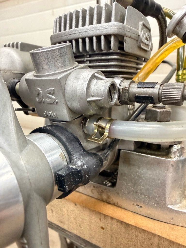

I just tested the OS FS 61 with the controlled air bleed.
First, I adjusted the engine at full throttle with the main needle, then I found the optimal idle and transition points with the secondary needle. Next, I tried to improve the entire range with the air bleed. I can see a change in engine speed when opening or closing the air vent, but in my case, the improvement wasn't very noticeable. So I tried the engine with the entire air bleed system removed, and I must say that this engine runs quite well on gasoline with electronic ignition, and that's all. So I'm going to try a flight like this and see if there's a need to reinstall an controlled air bleed or solenoid system.
