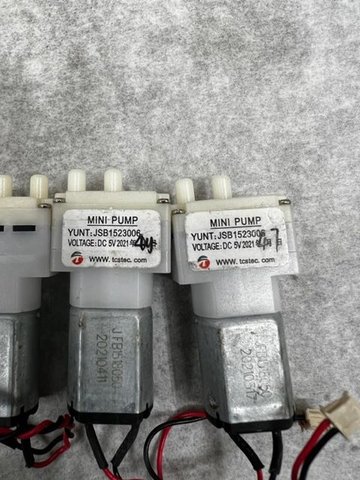

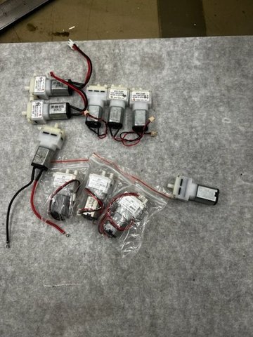

Package showed up today from overseas and had some air movers in it.. Have an assortment to play with of a few differ styles - One is even marked "water pump"...
Attaching a little video to show just how fast this system can react if needed - Just pumping into a closed and empty 4 oz tank. Using mbar to appease Bert - for our US followers 1 psi = 69 mbar I think the demo shows how quick it is. I then let the pump off scale the manometer (240 mbar)

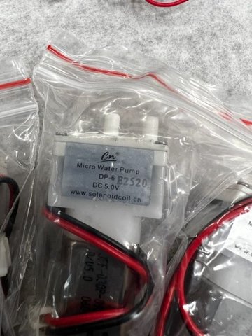

I ordered 3 of these. Seems to be a bunch of different part numbers. I figured 5v could be powered from 2s life without a regulator since the solenoid and OLED is probably close to max on the onboard 3.3v supply.

On your picture Dave - Looks like you got the right style - There are tons of versions and it seems like many different manufactures too.

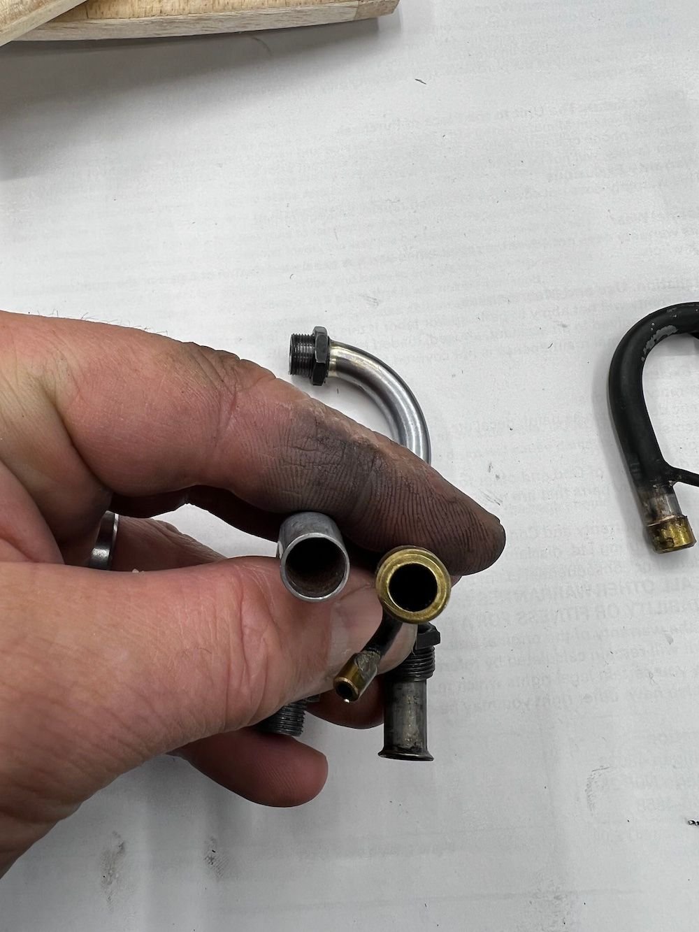

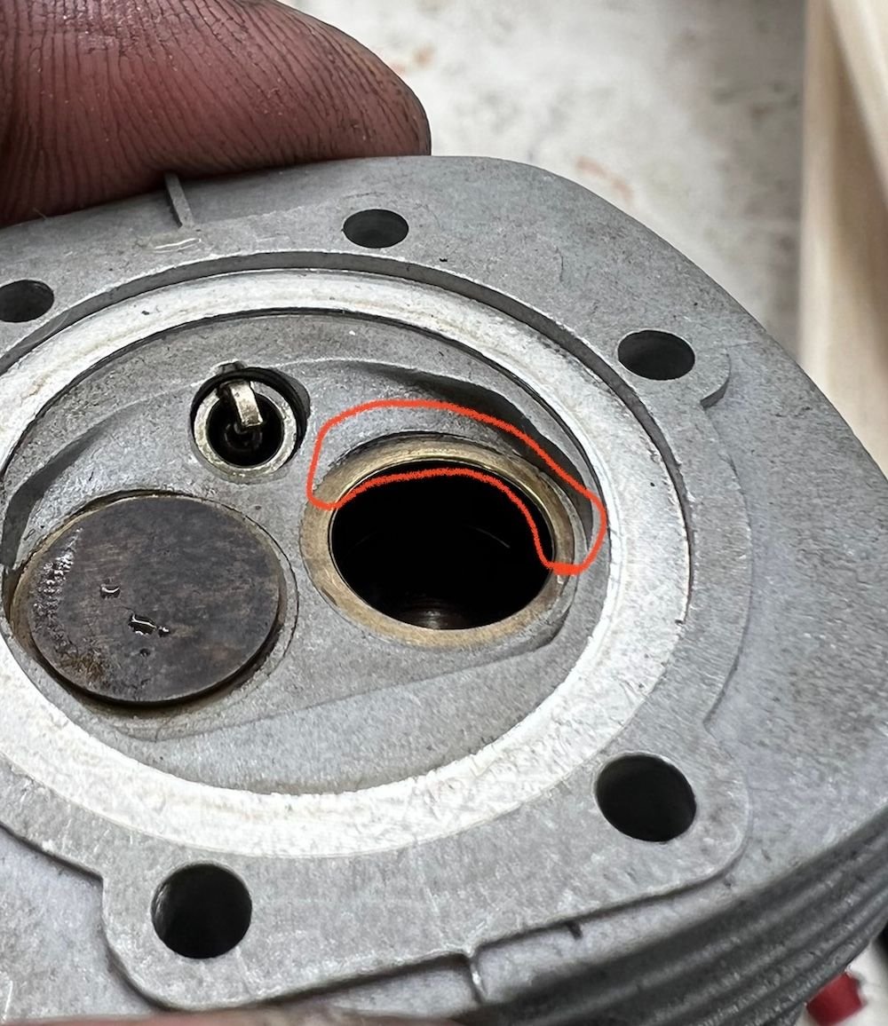

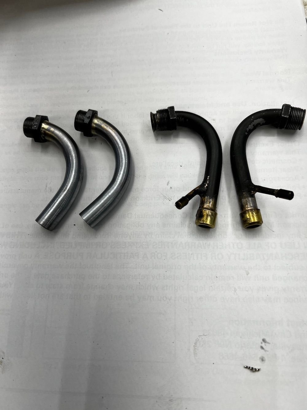

I'm stuck up at one of our northern bases this week doing management coverage so no shop time this week.. but I want to share a couple of weekend items.
Because I plan to utilize the e-pump now on my Boxer setup I can free up the exhaust for better flow - so I made up a set of stacks to help with that.. My last set was 6.7 mm ID and I had to restrict then to about 6mm to get sufficient exhaust pressure to move fuel. The new ones are about 8mm ID made by having a "fixed" external thread and a jam nut rather than the compression fitting..
On another finding - I have always had "mushier" compression on one of the cylinders of this engine - I think Bert and Dave might have had similar issues.. Dave suggested I check for a stuck ring and I did that but found it OK - ring gap is a little excessive but nothing else is apparently bad there. As I was reassembling I tried to check all leak sources and noted the intake had a draw and pressure as it was turned over with the port plugged with a finger. (both valves closed) Took a while to find it but there is a leak between the valve seat and the head in the area noted in the picture. This engine runs excellent so I don't think its an issue and I don't think to would be a simple fix.

So the bronze valve seat insert is leaking around the head casing.... I believe the head is cast around those bronze seat inserts... I can't imagine the leak being that great around the casings when the engine is turned over by hand... but being a single piston ring, the excessive ring gap on the effected cylinder would cause a noticeable compression loss when turned over by hand, but at reciprocating piston speeds, the dynamic compression loss is less.
Valve seat face doesn't look uniform, maybe its just shadows... but you can use a mild abrasive toothpaste, or a pumas cleanser and lap the valve / seat faces.
Old 11-29-2022 | 12:48 AM

Valve seat is ok and valve seals well - Made a delrin plug and held it in with a 3mm cap screw though the guide. filled the head and small pressure on the port and bubbles showed it definitely coming from the seat /head interface. I think I'm just going to accept the fact that compression is mushy on this one as it runs so well. Might throw rings at it if I find some.

If you have the access to a deep vacuum chamber, apply a bead of high strength high temperature Loctite or other sealant/threadlocker and place the head in a deep vacuum chamber. Expose the head to vacuum for a minute or two, then release. The air being drawn out of the crevice will cause the sealant to be drawn in when vacuum is released. The Loctite will cure in the crevice and remain liquid on the outside, so after 30 minutes to one hour, you can wash off the excess Loctite.
It is a bit similar to how small cracks in car windshields are repaired. There they use UV to cure the resin, but that prolly won't work on more opaque parts like cylinder heads

Does it leak that much around seat edge?... small bubbles would indicate a seepage around the insert, but I'd be surprised if it caused any issue with the engine running... The only concern would be if its a shrunk in seat ring, then it could drop out, but usually they are cast in and are fully captured.
Try Berts suggestion, red loctite or the loctite Bearing retainer, which should wick in under a vacuum for sure, good idea actually.

Brilliant idea Bert ... I think I have all the materials needed. Will document when do it. As John said I don't think its enough to really effect how the engine runs and I'm sure the seat will not fall out but it does effect the slow speed compression because of what I have observed with the intake port pressure fluctuation with the valve closed.

Yup... a leak in the general area of the intake seat, be that a leaking valve or a leaking seat, will strongly affect the required needle settings for a good idle mixture and also affect the ability to "draw" fuel at idle.
