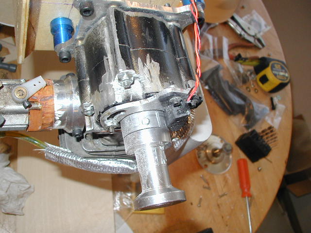

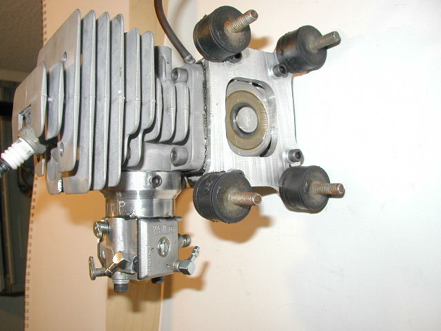

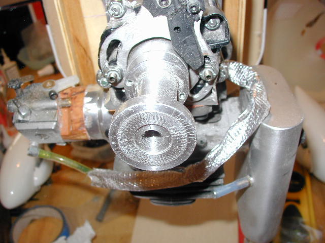

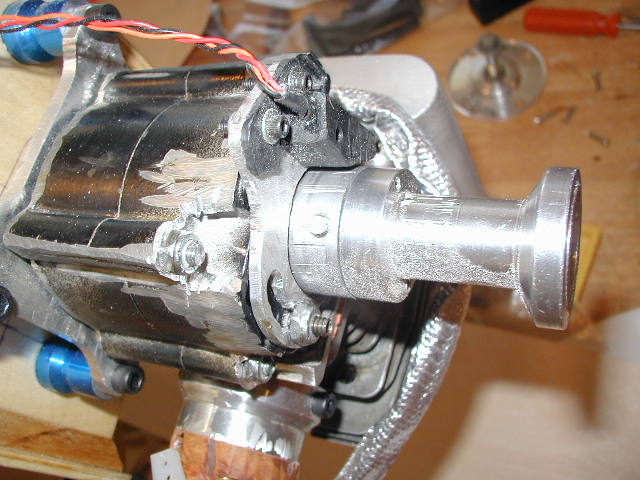

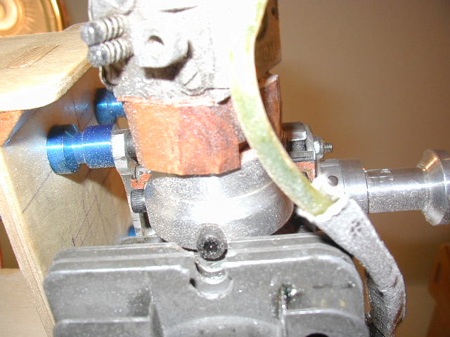

Here are some better pics of the engine after it's done.
You can see the phenolic spacer.
You can see the carb adaptor and where I had to drill a hole in the fins to install one of the bolts into the cylinder.
There is whats left of the magneto and the magnet(crank trigger) that installed into the side of it.

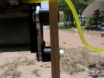

Muffler is a Bisson for an upright mounted Moki180-210. The Moki has a 34mm bolt spacing and the Poulan has 36mm spacing. I just drilled the holes out bigger and it bolted right up. Sounds nice.
I'm using an insulator on my pulse line from the case to the carb. I wanted to insulate the line to keep the exhaust from melting the line.
Ken Lambert made my carb adaptor, timing bracket, backplate mount, prop hub, and he turned my magneto down on a lathe and installed the magnet. It all works.

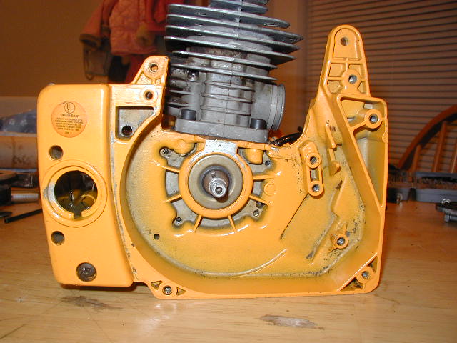

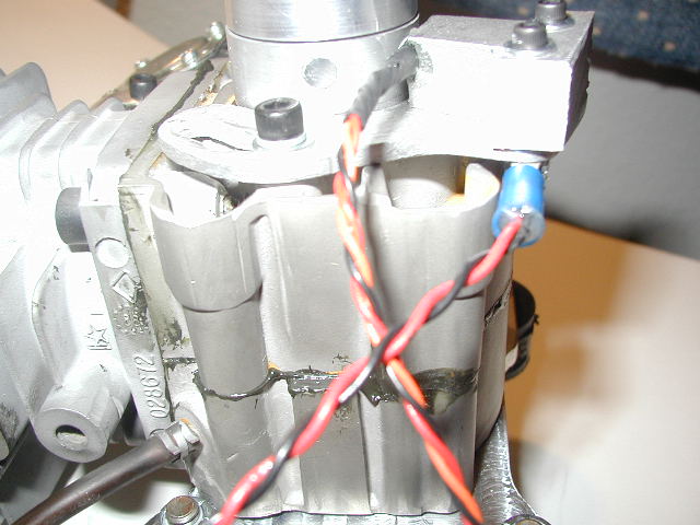

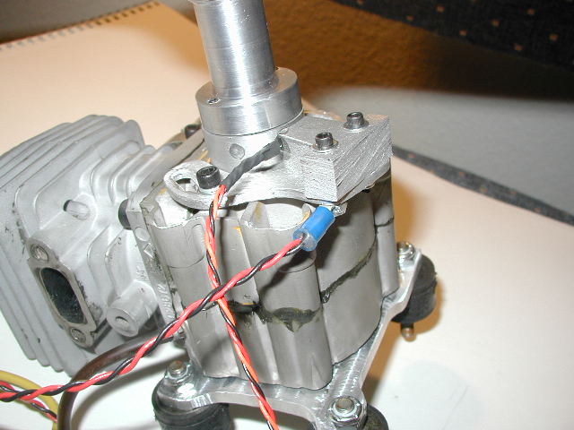

These are the pics of the engine when it was removed from the saw. I hadn't cut it up yet.
You can see on the first pic; this is the side where the clutch and sprocket where. Mainly- notice the two bolt holes on the left and right sides of the crank. Those are the holes I used to mount my U shaped timing bracket.
But, in this pic-- thats the wrong side of the motor. You'll cut that side of the crank off and then flip the motor around backwards in the case. Don't forget the flip the cylinder to match.
In the second pic, you are looking at the side where the magneto was attatched. This is the side where the crank is tapered and has a keyway. This is the front of the motor at this point; before I flipped it around. The big giant hole on the left side is where the bar oil was filled. Two small holes - just slightly to the right and up-- are where the coil was mounted for the magneto.
Third pic. Back of the engine. You can see the intake port, plug hole, and the pulse line. After flipping the engine, the pulse line and intake port will be on oppostie sides from each other. You'll need a longer hose, and possibly some kind of insulation on the line to keep it from begin melted as it passes by the exhaust.
4th pic-- after a little cutting. Not done yet.

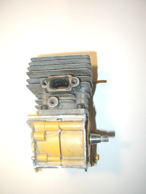

Rcpilet, that was quite a description of how to convert the engine ! I wont need a carb adapter, mine bolts right to the cylinder with an adapter. The case I have is a bit bigger than the one you started with. The fuel tank on my saw was inside the aluminum case. I have been looking it over and think I might be able to do a flat plate on the backside. It doesn't look like the 180 degree flip of the cylinder and crank would benifit me with the case I have. Here is a couple of links to pics of the case I have.
[link=http://home.bresnan.net/~superfast/files/engine1.jpg]Engine Case Picture 1[/link]
[link=http://home.bresnan.net/~superfast/files/engine2.jpg]Engine Case Picture 2[/link]
