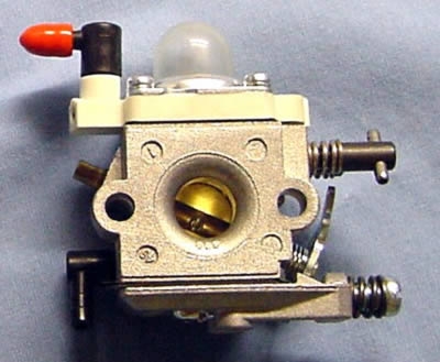

Thanks again for your insight I was just wondering how big the ventury on the g23 carb is so that I can compare it with mine. I am hoping that my project will be less that 11 lb so I can get the best performance from and yes hovering is in my plans(hopfully).

There are two (or more, depending on which era) carbs on them that I know of. The most common is the 7/16" (28) carb. The glow version had a 27/64" carb. I have each and I run both on gas and they run about the same.
The most common in recent times was the WA167A Walbro. It's the gas 7/16" version with the bulb on the regulator side.
