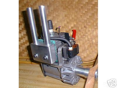

I make a pitts style muffler aluminum with one pipe my engine gained 300 rpm with these they sell for 28.00 shipped Kenneth

Kenlambert,
Do you have any pictures of your muffler? I'd like to have a closer look at it to see if it will fit my particular application. It's going in a 70" Diabolo 120. Thanks for the ideas!

Default RE: homey 25 mufflers
you can see one of them in the for sale engines under gas that I have posted it is on a homelite engine ,I have several for sale just haven't got a seperate pic yet

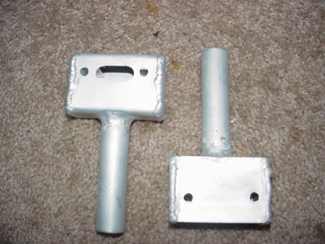

You can get a muffler from www.wackerengines.com for $28.00 shipped to your door. They are of top quality construction and the pipes screw it and out for easy installation around cowling's. Peter is a great person to deal with and he will help you with everything you my need.

here is a pic

at the risk of upsetting Ken, here a muffler from Pete at www.wackerengines.com for the same money. Much better finish quality and removable pipes....

piper cub how much do the mufflers weigh just interested mine is 44gramms Kenneth
oh Im not in competion with anyone this is just to pass the time and to have something to tinker with so I don,t get upsett thanks Kenneth
Good Ken, Im glade to see people having fun making parts to further the cost effective conversions of these engines. I know it takes a lot of work to make some of the parts. As far as the weight of the muffler, not sure but its feather lite.
I've got one of Kens mufflers on the Homey in my Ultra Stik. It weighs 46.8 grams compared to 115 grams (weighed on a triple beam Ohaus) for the B&B that I took off. The single tube exhaust gave me 200 more rpm over the B&B on the same prop and it is much quieter. This doesn't work on all engines but on the Homey it did. Less than half the weight, more power, less noise, works for me!
