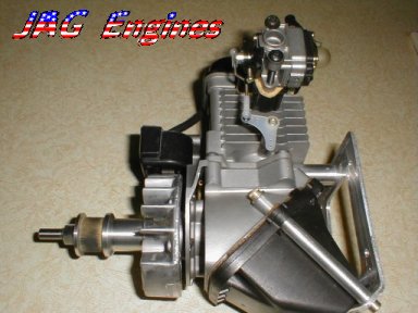

Jag use to make this but as far as I know, no longer offer them.

I may check with Jag ltd. Even if they don't have the mount in stock the pictures are still helpful. I'm considering a similar mount with a plate sandwiched between the case and the sump. I've cut a lot of metal off of the case but it looks like I can go farther yet.

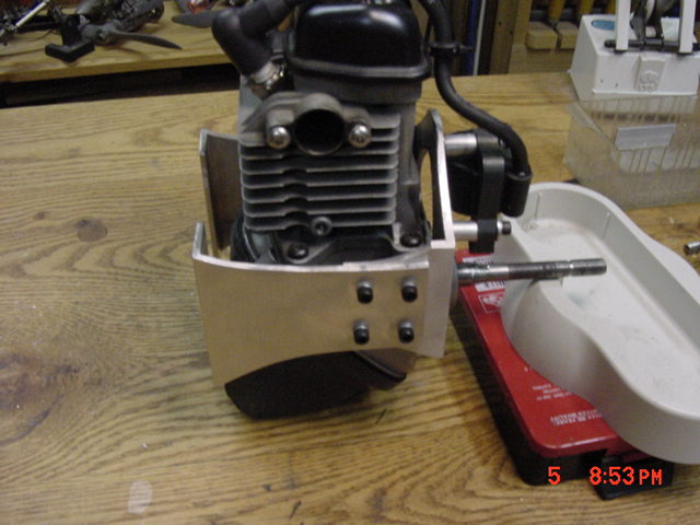

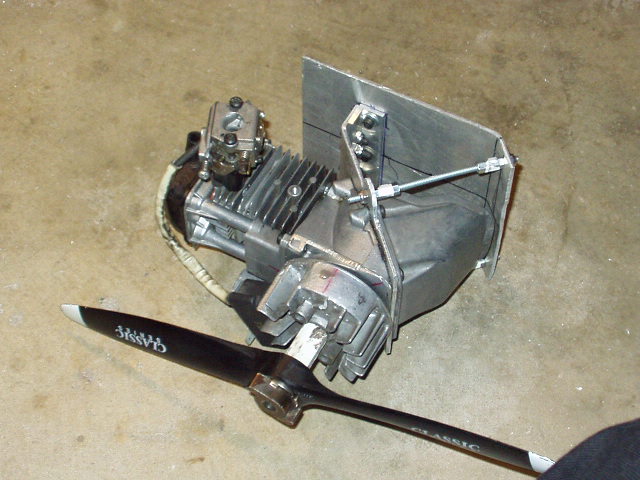

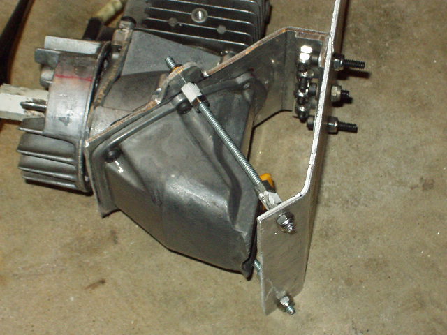

Here are some pictures of what I have accomplished so far. No test run yet but the mount seems solid. There is a plate between the case and the sump. The struts serve to triangulate the plate. It's pretty rough. there is a lot of room for lighhtening and cosmetics and I am a little concerned about the long term durability of the allthread for strut material but it should serve for proof of concept. I'll post a picture as soon as it is running.

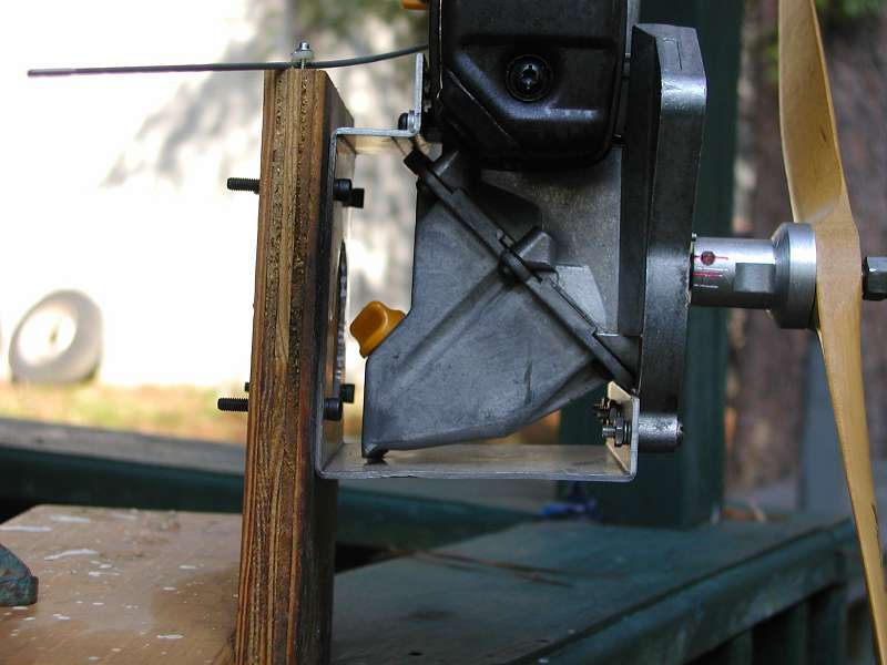

These are pictures of the mount that I made for my old Ryobi 4 stroke. It runs on a homebrew CD ign. I have a Bridi Corben Baby Ace kit that I plan to try it on.
W5RA

I like that mount, much less machining than mine, way to go.

Thanks for the comment. I still have some trimming of the mount and the engine to do, but it seems that it should work ok.

Matt I like the engine mount. It looks strong and very functional. For me the cosmetics are never important when prototyping.
I would not worry about the allthread. I mounted an engine on four 1/4” carriage bolts used as standoffs so that the thrust could be adjusted and it has been in use for over ten years.
