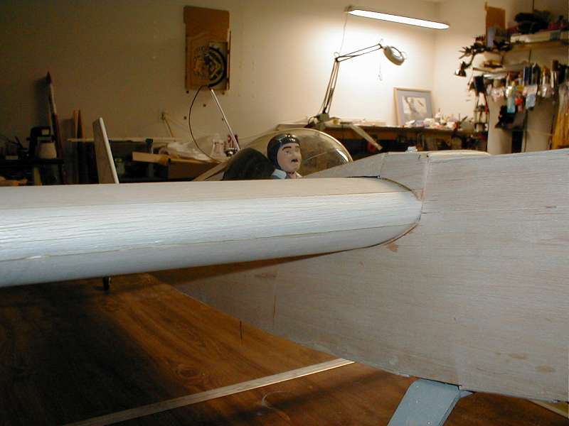

I have not gotten very far with the build. I will post some more pic's tonight when I get home. I have changed a few things like putting a conopy on her and beefing up the landing gear. She is not going to look like your typical stingray. BB and Mr Piper have been a lot of help in the project. Have you gotten your stringray yet? I would like to see how your project is coming along if you have.

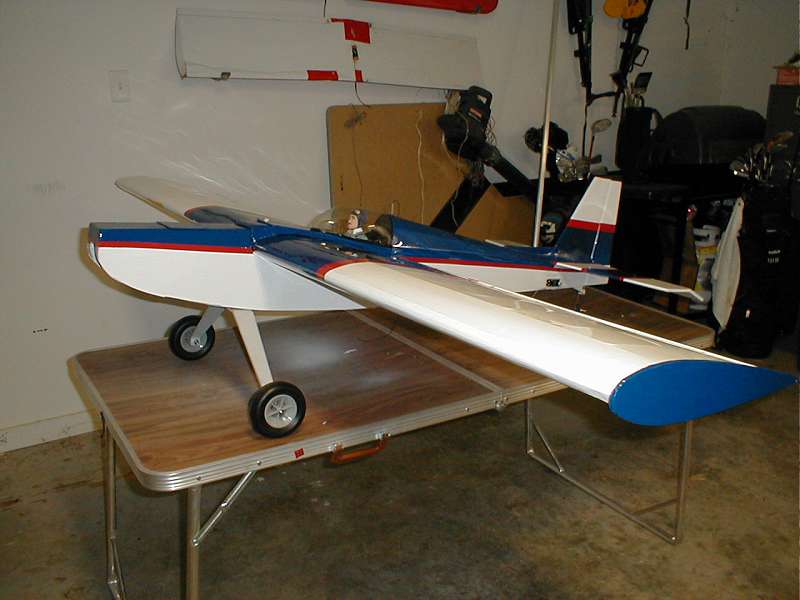

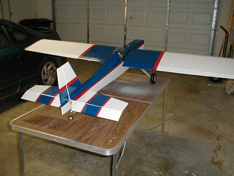

Here are some pic's of the plane I took tonight. As you can I have not gotten very far , but it is coming along. I hope to start covering the plane this weekend if the season does not get in the way if you know what I mean.

*GASP*.... Is that Monokote on the tail!? I've got my old timer bout all framed up. 1/2 of the wing to do yet and then ready to sand all the corners to shape. At the same time I'm trying to get a homie 30cc, husky 41cc and a ryobi 4-stroke ready to fly. If I only had a few more irons in the fire, like Christmas or something, umm... that would make it easier,

Yes that is Monokote on the tail. I have been working with the cloth and I do like it, but it is going to be heavier than the Monokote. With the extra added weight of the 31cc Ryobi I decided to go with Monokote on this plane to try and keep the weight down as much as I can. I have already beefed up the landing gear because of the extra weight and that to add a few more onces. I know the power of the Ryobi is a little less than a 1.20 nitro weighting half as much. I have moved the 5 cell battery pack, receiver, and both rudder and elevator servos to the rear of the body and she is still going to be nose heavy. That is why I decide to use MonoKote over cloth on this plane. I will us the cloth on the Balsa USA Taube 40 I now have. I too have about three more planes to build after this one and the holidays are slowing me down. How is you old timer coming?

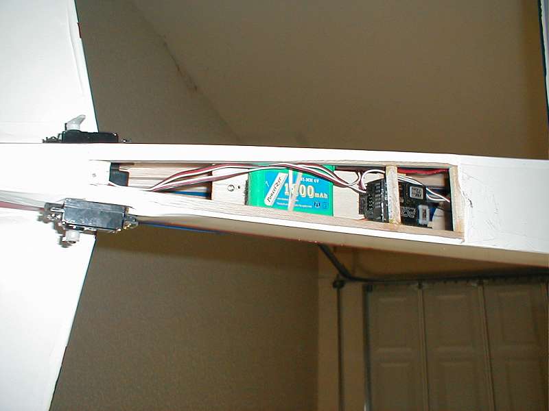

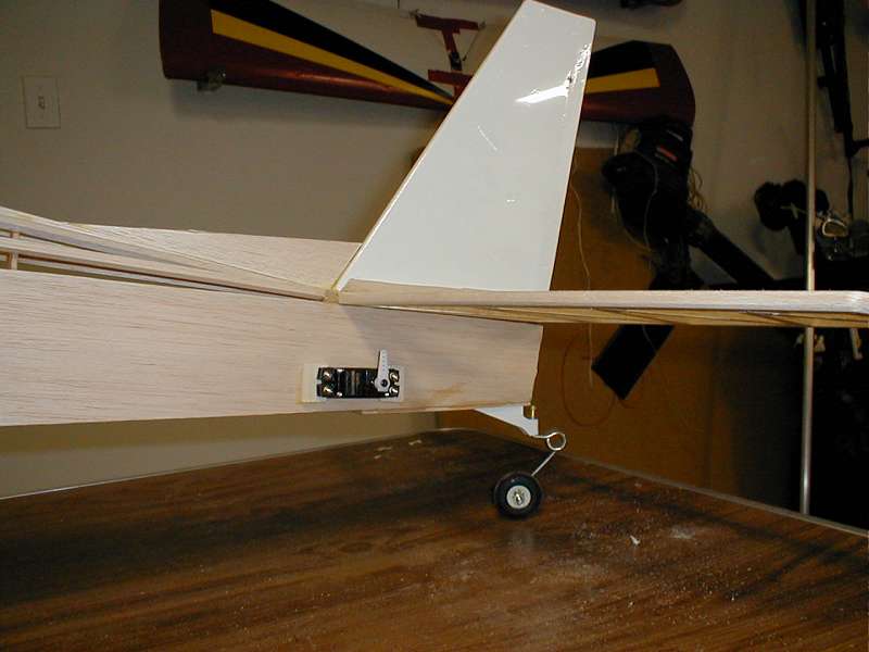

Here are some of the latest pic's of my project. I have one pic of the 5 cell battery pack and receiver in the tail section. You can see the two servo's in the same pic. Even with the battery pack and receiver in the tail section along with the servo's I still needed to add 3 oz's of weight to the tail section to get the plane to balance at the CG point.
#56
Posts: 35
From: Rexburg, Idaho
Hi Jim,
Your Stingray came out very nice. You are going to like the way it flies. It makes me want to build another one. I have one suggestion, I would move your battery pack back more instead of adding any more weight to the tail.
Good luck.
Doug
Good luck.
Doug
