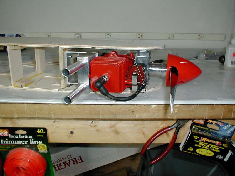

I have just started building my Stingray 120 for use with my Ryobi 28cc engine. I decided to build the body first to make sure the Ryobi would fit OK. I had to move the motor mount back 3" from it normal position to get the engine to fit the frame. from the pictures I believe I will move the motor up about another inch to get a better looking fit. I will be positioning more pis's as the build comes along. Any suggestions are highly appreciated.
Jim

Looks good. Are you going to cover over the top of the cheeks or leave it open?
I built one of those a few years ago with a G-38. I cut the cheeks off and also moved the firewall back. I had a lot of fun with that airplane until the engine quit during a low hover.

I plan on covering over the cheeks with some Balsa, but leave an opening so I can get to the Cab. What size prop did you use. I am thinking of trying an 18x8 to start with.

I think I used an 18-6 prop. I mounted the radio equipment, rudder and elevator servos back as far as I could to help balance the cg.

This thread is making me want to get another stingray. If I do, my wife is go'na shoot me. Heres my two cents worth. I see you got the 3" mount, remember to use some hardwood triangle stock on your firewall and also use the trick of drilling 3/32 ( I think) holes, 4 or 5 per side and epoxy toothpicks through the fusalage sides into the ply firewall. With that engines weight ,that far out, hanging on the firewall it has a lot of leverage. A bounced landing might end up with the plane running over its own engine. Think strength but build light. Keep posting pics and such. I'll try to resist rushing out to get one. Piper

I am sorry this is causing such a problem with you. I am glad to here that you like the stingray and that the Ryobi might be a good engine for it. I will ad extra strength to the motor mount as you suggested. I to do not want to lose a engine on landing. I ordered my Balsa USA stingray from www.sheldonhobbies.com for $116.94 delivered to Memphis, TN. That is the best price I could find. I will keep adding pic's every couple of days and the build comes along. I am working on the wing right know and the plans are missing a couple of things, but this should not case a problem because of the extra building instructions with 9 pages of pictures.

I figure the total weight to come in around 13 lbs. plus or minus a couple of oz. With a 83" inch wing with 1276 sq in. this should be a good combination.

I will use the toothpicks. It does make since on what you said about maintaining the over all strength of the 3/8"' plywood firewall. I do thank you for you help.
I will be posting more pic's tomorrow on how it is coming. I did move the engine up an inch on the firewall. The wing is coming out fine and I should be ready to cover it this coming week if things keep going as good as they have.
