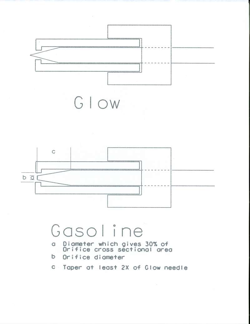

I've been following this disscussion with interest. I have an OS .90 four stroke that I was planning to convert to ignition and gas but if it can be done with glo, all the better. However, I'm not sure about lubrication. One of the main reasons for going to gas is because of the gunk that methanol, or rather the castor oil, leaves on the aircraft. If gas is used and 20% methanol could two stroke oil be used at say 25:1 or would this damage the engine?

RCIGN1 is absolutely correct about the oil content for four strokes. I have a Magnum 80 on ignition and gasoline that has about 50 hours on it with no problems on 15% synthetic oil. However, the glow engine carb setup is for metering methanol at a 6.5 air to fuel ratio. On gasoline, even with 20 to 25 % methanol, the needle settings between rich and lean are usually less than 1/4 turn. It is really sensitive. However you can take a spare needle and modify it to give you more adjustment latitude. The mod is shown in the attached drawing.
#31
The SuperTigre carbs already have a loooong taper, should work well with gasoline, or maybe the thread size on the needle would be the same...Harry Higley used to sell SuperTigre replacemant needles...the needles were quite long and tended to vibrate open..We cut the needle close to the carb and soldered on a 4-40 nut..
