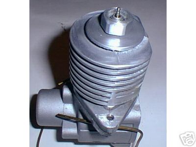

I have an old Super Tigre S2000 that was aquired as part of a trade. It has what appears to be a gas carb (says "walbro" on it, and guys in my club say it is a gas carb), as well as a nipple and tube coming out of the crankcase backplate. There is no ignition system or muffler with the engine. Can anyone help me identify this and tell me what it would take to get it going? I have 5 year's experience with glow and 5 seconds experience with gas.
Would it be cheaper to just get a glow carb for it? Since it's a larger displacement engine, I know it will be expensive to operate on glow fuel.
Any help would be much appreciated. I can send photos if needed for identification.

Hey convert! doe's your engine have a regular glo plug head? if so try the arrengment that I am experimenting with and that is use 87or 91 octane gasoline with 2 stroke engine oil at a 40:1 ratio have an O.S four stroke glo plug and two 1.2 volts AA in series (2.4 volts) conected to the plug, If you read this forum you will find a lot of information regarding this subject. As far as the engine that you have is definetily a gas conversion set up like the one that CH ignitions offer for Supertigre Engines but who ever traded you the engine kept the electronic ignition set up. you can visit the CH gnition web page and look at their conversion to see what I mean.
So try it with the glo plug/Gasoline set and let me know your results I realy need feed back on this project to keep me motivated

The tiger won't live with a 40/1 oil mix. It will require 10/1 mix and so will most of the "glow" conversions.
This is because of the bushed rod. Most 40/1 mix engines have needle bearings on the rod.

No SuperTigre ever had a needle bearing on either end of the rod..Some aftermarket rods were sold with a needle bearing on the bottom..The crank surface is too soft for a needle bearing..It only works for a while....
Lower number, HIGHER oil content...
