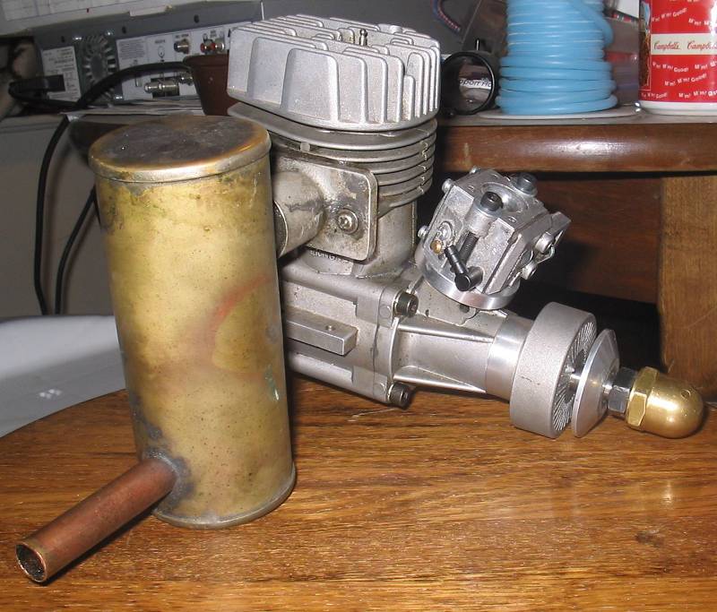

Ralphbf's Avatar
My Feedback: (27)
Joined: Mar 2004
Posts: 1,450
From: Woodland, CA
Default RE: gas fuel with glo plug no ignition
I have a ST-3250 I been thinking about selling.
What kind of numbers are you getting with your 3000?
I tried the ST-3250 on gas glow with the extra oil and a walbro carb,
but was not impressed with the way it ran.
Actually I was never impressed with this engine on glow, diesel or gas-glow.
