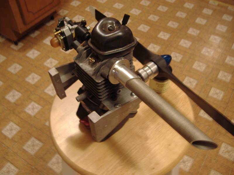

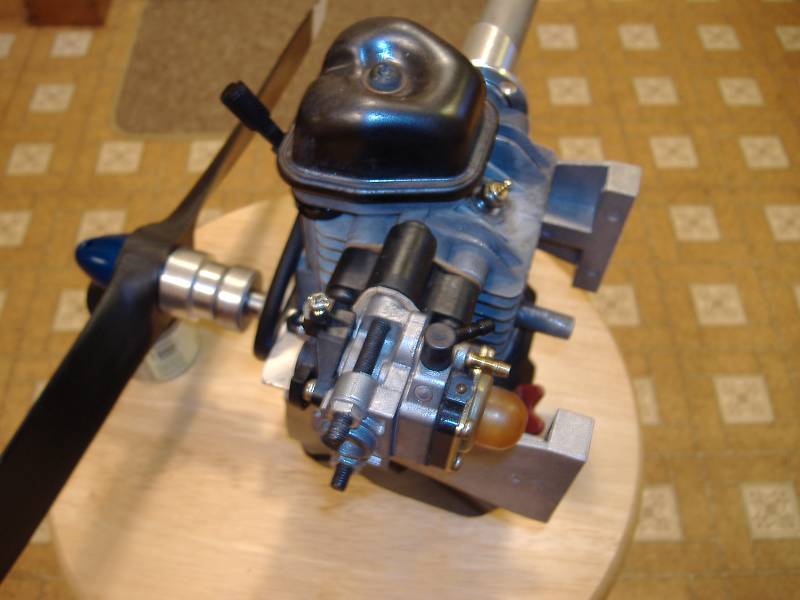

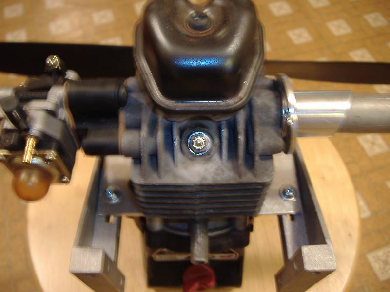

Default RE: gas fuel with glo plug no ignition
Hey yall, as I said in a earlier post the, ignitions are coming of most of may gassers. The 1st victim is this Ryobl 4 cycle. I just got the glow plug adapter made this afternoon and cobbled together this test exhaust. I made the plug adapter from steel this time hoping it will be a heat sink for better idle. Will try the stock carb, but it may not work well as it is a non-adjustable rotary barrel type. If it doesnt work I will go to a WT Walbro, but will have to tap the valve cover as a pulse source and mod the carb for external pulse fitting. Will let yall know if I have any success.

Old 01-29-2008 | 06:51 PM
  #2065
av8tor1977's Avatar
Joined: May 2003
Posts: 7,245
Received 6 Likes on 5 Posts
From: Tucson, AZ
Yeah, we've all been waiting for someone to try Gas/Glow with a four stroker. Please let us know how it works!
Of course the worst that could happen is that it might need glow heat at idle, but maybe not! Good luck.

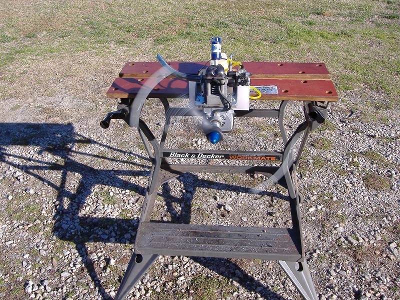

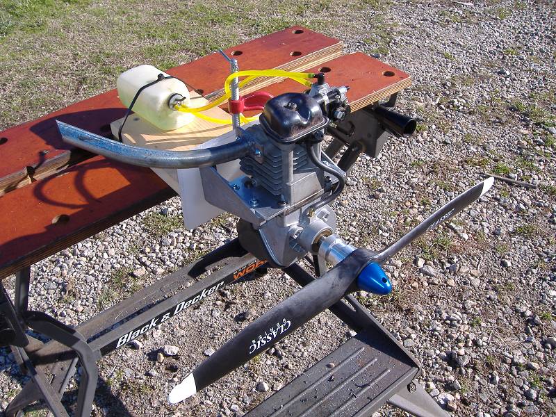

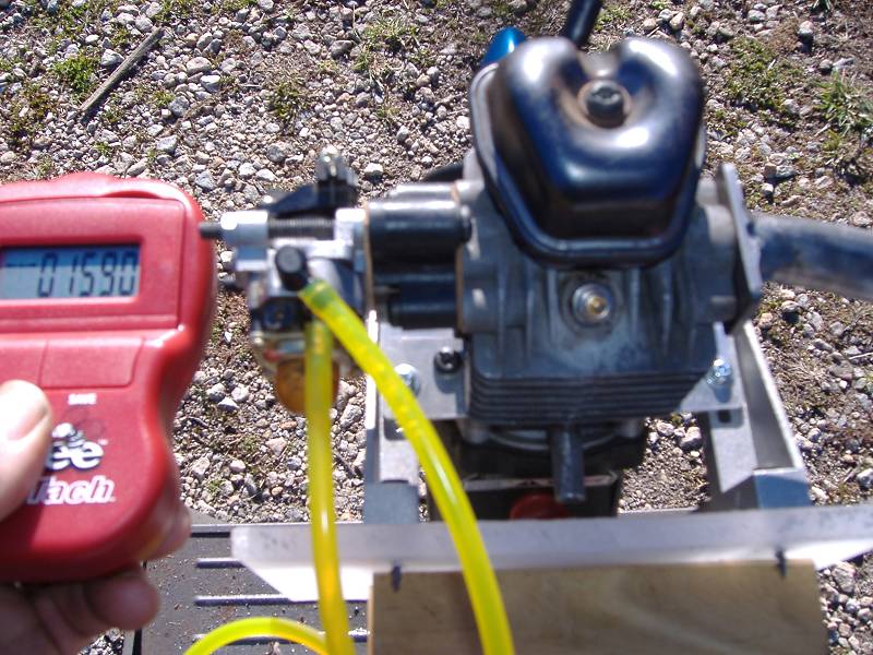

Hey guys, Well we have a running 4 cycle! Here are a few pics. As I suspected the carb is all wrong for gas/glow, will not supply enough fuel. Runs well on the bottom end and even IDLES! The idle is consistant but rocky, plug up the glow driver and it idles like a Lexus. I will idle through a tank of fuel if you wanted but it is smoother with the plug lit. I cant tell much about the top end. I did get it to rev pretty high by putting mu finger ovet the carb intake but I couldnt hold the tach too. Notice in the pics it is ticking over @ just under 1600 rpm with out the glow driver. I have several different WTs to try and I think it shows real promise!

Ha! That's too cool. A four stroke gasser running on Gas/Glow. Now we know it works!
Congrats, and good work!
