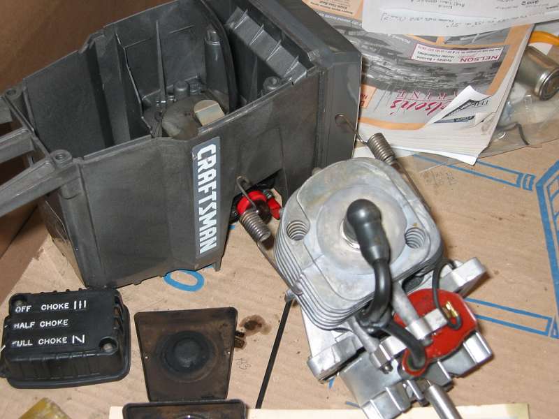

Picked one up yesterday; I am curious whether it would be worthwhile to convert. Reed valve set-up like Ryobi. It has a small WA219-B Carb (7.14mm), single ring, spring held muffler. The head has fewer fins, but thicker than Ryobi 31. The grey plastic case does not look like it would be as durable/strong as the black material used by Ryobi.
What is the trick to getting those muffler springs off? they are STIFF!
It may just go back to original duty.

<What is the trick to getting those muffler springs off? they are STIFF! >
Vice grips and big biceps are what I use

Note the spring puller next to hammer.

How did you get the clutch off that thing? I am about to give up on mine!!

My clutch came off by placing a flat head screwdriver down the center of the clutchbell and removing the screw.

No clutch on this unit, so it was rather a non-issue. Rotating the cutting head I came up with resistance of the crank trying to turn over. No free-wheeling of a clutched unit.
Reassembled with some new fuel line and it fired right up.
What is the general tuning routine on a single needle carb, it lost its limiter. Started at 2 out and just kept leaning it out till it had best sound and then back 1/8 turn. This is just for 'see it does run just fine' operation.

Be sure that engine turns the right way, mine turns clockwise.

I got the bell off ok. Its the shoes that I cant get off the shaft.

They must be threaded on. Can you determine direction of threads CW /CCW? vise it up; Jam the cylinder up with some small line/rope pushed down thru the plug hole; put a strap wrench or worst case a pipe wrench on the clutch shoes and lean on it. Might put some LiquidWrench on and let it set overnite first.
