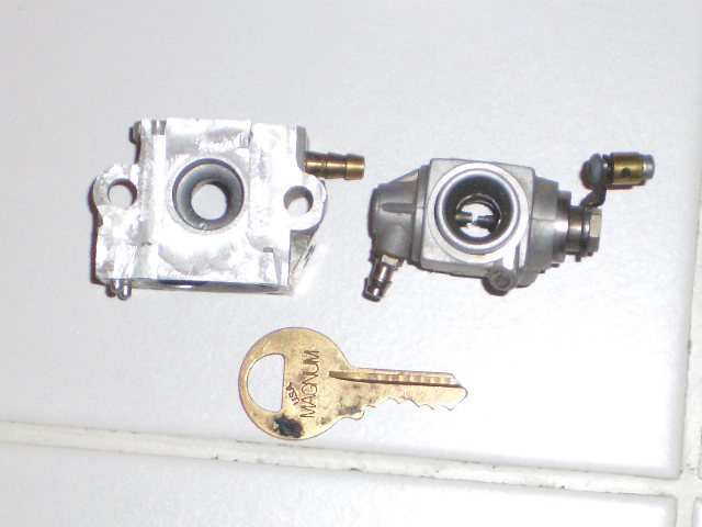

I have a carb from an O.S. FX46. The carb venturi measures 0.302" and the stock WA183A Walbro measures 0.28". ?????? What would have to be changed to use this carb?

the cline reg is about 20 grams and the iron bay is about twice the weight. you will also need some kind of adapter for the glow carb and a tank that can take some heavy-duty pressure. ever seen how a YS turns a tank into a football
i think if you add up all the extras you'll need for the glow carb you won't be saving any weight. also, glo carbs can get touchy when trying to run gas through them.
if your stock carb is only 0.28" at the venturi then you might have quite a bit of power to gain by using something bigger, especially if you want to use a higher revving 15x6.

I think you're correct on the 2-stroke carb not saving any weight. For the complexity, sensitive tuning, unfamiliarity, and cost, I think the Walbro is the best option. You mentioned a DA/3W plug boot would fit the CM-6 plug. Do you know where you can find one of these? I'm also trying to source an old capacitor to plug the rear of the case as you did.

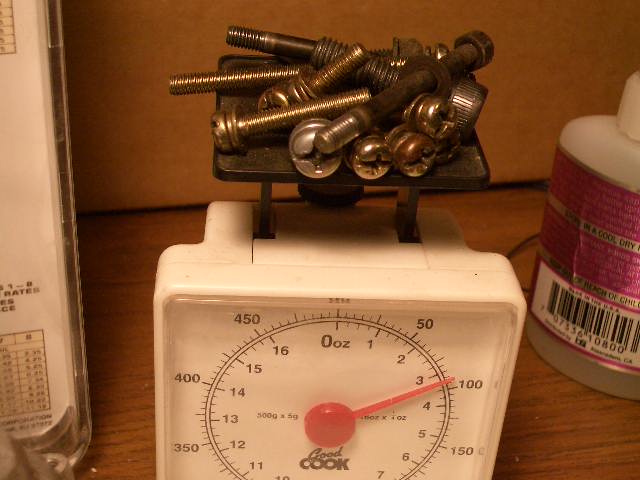

The titanium bolts came in today. The steel bolts weigh 3.2 oz. Titanium are 1.4. Not bad for $30.
ID:	109824   Click image for larger version

nice! almost 2oz saved from just swapping bolts. i would have thought that only those cheesy aluminium bolts would accomplish that.
do you have a link for a web site?
dave
