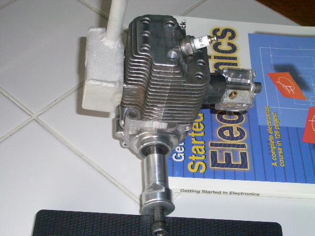

31.7 oz. I still have a little "fat" to trim off. This weight is complete as you see with no hall sensor/magnet. Waiting for LiPo batteries and regulators.

The Echo is definitely on a diet! Looking nice. Have you finalized the aft end of crank and seal or end plug? Curious how that was resolved.

You could get rid of that big spark plug....use a aluminum screw in apater and the smallest spark plug you can find. Thanks Capt,n

ORIGINAL: DougT
at first i thought that you must be including the ignition in this figure but then i went back through the thread and did the math. now that i've started converting a kawasaki 25cc your weight seems heavy.
here's a list of the kawasaki's parts compared to yours. the cylinder is untouched, the crank only has the rear shaft cut off at the bearing and the case halves only have the mag housing and some unneeded lugs cut off. i might be able to lose an oz or two if i go nuts with the dremel
............................................echo.. ..............kawasaki
crank+rod+piston....................9 oz..................7 oz
bare cylinder..........................7.75 oz...............6 oz
case halves+bearings.............7.7 oz.................6 oz
so if i use your techniques on the carb, carb adapter, muffler, hub, Ti bolts and CM-6 plug i should come in under 26 oz!! COOL!!
dave

Mikenlapaz,
I'm still wanting to put the ignition sensor in the rear. I'm waiting for some thin wall tubing that's the same diameter as the crank. I'm going to decrease the diameter of the rear crank behind the rear bearing and cut it off about 3/8" out of the bearing. Then I'll slide the tube over and that will go throught the rear seal and I can solder on a magnet plate to the back of the tubing after it comes out of the seal. That way I can mount the hall sensor on an arm and have it linked to the throttle for advance.
captn,
I would like to use one of the 1/4 X 20 spark plugs but they are almost $15 each and I've heard they don't last long. This I feel was a good compromise at $2.25 per.
ZAGNUT,
Holly cow!!!!!!!! That's light!!! Do you have a model # and/or pic? I'd love to do this surgery to that motor. Keep us posted. The reason I'm not including the ignition in the weight is that the ignition will be mounted over the wing so it won't affect the balance. The only thing forward will be the sensor/wire and plug boot.
Doug

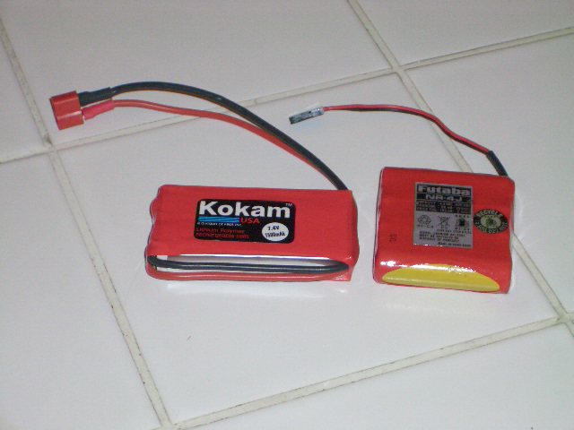

Hey y'all,
Sorry for the delay. I got a new job/promotion at work and have been in training out of town for most of April. I'm back now. The engine is complete minus the ignition. I've been having problems with it and may have to use a larger(standard) size resistor plug. I have a brand new Kokam 7.4v 1500 mah LiPo battery, a 6.0v regulator, and a voltage monitor. All the radio gear is installed. Just waiting on ignition. After that's working, I'll put the engine on a test stand and fine tune it and then it's a go.
Stay tuned...
Doug
7.4v, 1500 mah LiPo next to a 4.8v, 600 mah NiCd
