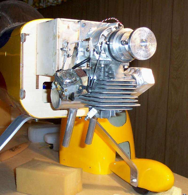

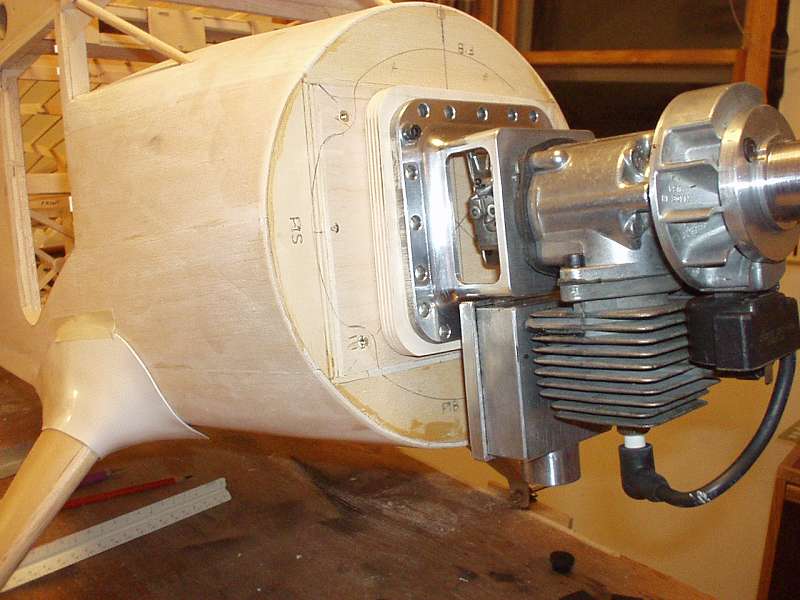

Hi everyone,
Let's use this thread to post pictures of engines and hardware. Share your ideas and engine-uity with pictures!!

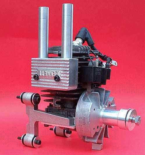

The first three here, I can't claim credit for, as I didn't convert them. They are out of my file of engine pics. They are Poulan 42cc engines. Nice work eh? The last one is of my Kioritz 23.6cc engine that I converted and modified with a 25cc crank, port timing changes, larger carb, more compression, etc. It's a lightweight, and powerful engine.

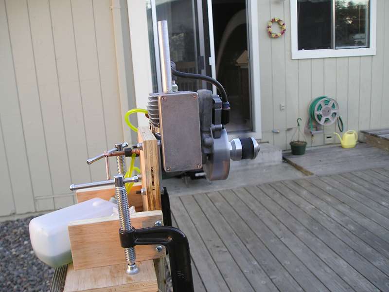

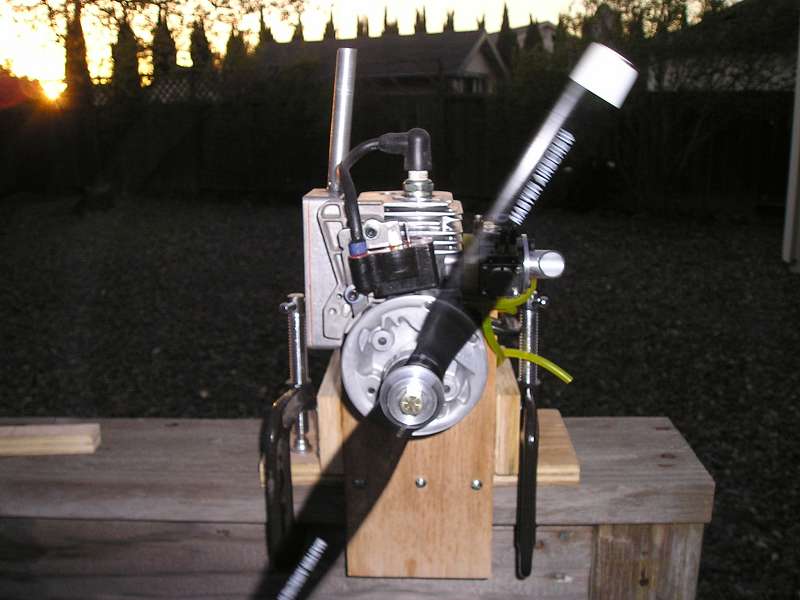

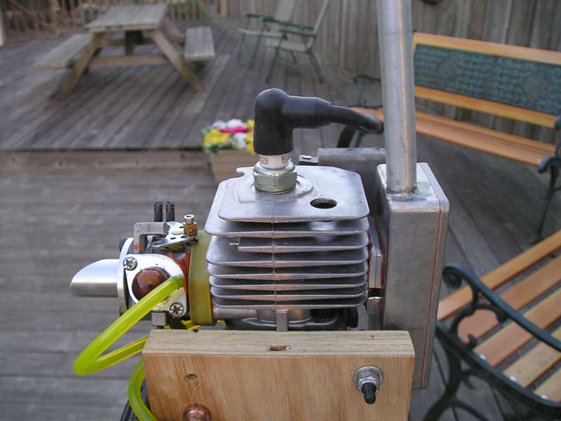

Here is my Weedeater 25cc conversion. G10 epoxy board intake, Drilled out WT-363(off a homelite 25cc), electronic enclosure box muffler, Carr Hub & mount, Weedwacker velocity stack, lightened flywheel, MA 16x6 prop (The engine has no trouble turning this prop, I need to try a bigger one).
The engine hand starts and runs great!
