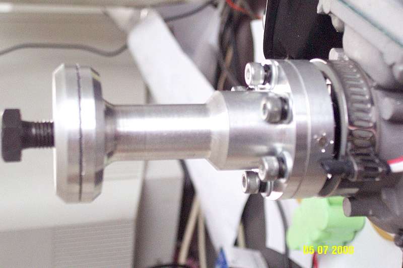

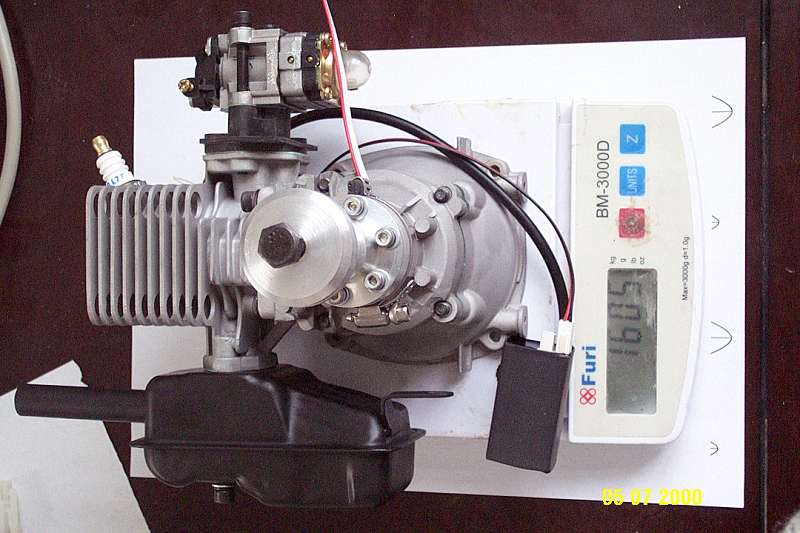

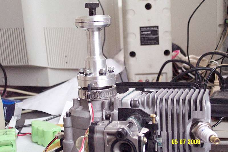

if one 40CC conversions engine with E-ignition ,and less 4oz weight then zenoah 26 , but get 40% more power , what price are ok?
long 15.9cm
high 12.7cm from center to spark plug
19.4 cm from carb to muffler
we use JXF prop( NX PROP IN CHINA)
17x7 8020 RPM
18x8 7450 RPM
18x10 7400 RPM
20x8 6450 RPM
20x10 6230 RPM
thrust about 8.5kg use 20x8 wood prop
this engine are not full break in ,

I think if you could keep the price to $250.00 US dollars or less, you could likely sell all that you could produce. Price should be with electronic ignition and a decent light-weight muffler.

This I gotta see, a 40cc engine that weighs 2 lbs 4 oz and works better than a G26, and will sell for less..Another 55 extreme ?
Wait till some distributor gets it, the price will skyrocket...

40% more power???? Yeh sure,,, mabey on nitros oxide.........

I tested my engine and it can sway 20-8 wood prop over 6400rpm , that mean about 19.8lb stastic thrust , but G26 can get only 14lb thrust . that way I said this engine has 40% more power than G26. If change to 17-8 prop(wood) , the rpm will over 8000!!

A good Q35 will turn those numbers with those props. What are the numbers with an 18-8?

If the 19.8 lbs thrust is from the ThrustHp chart, forget it, it's way high..
MY G26 tested with at Mejzlik 18-6 and Abell muffler at 9000 gets 17.5 lbs thrust with a scale on the tail wheel..
Put yours on a plane with that 20-8 at 6400 and see what a spring scale reads...
