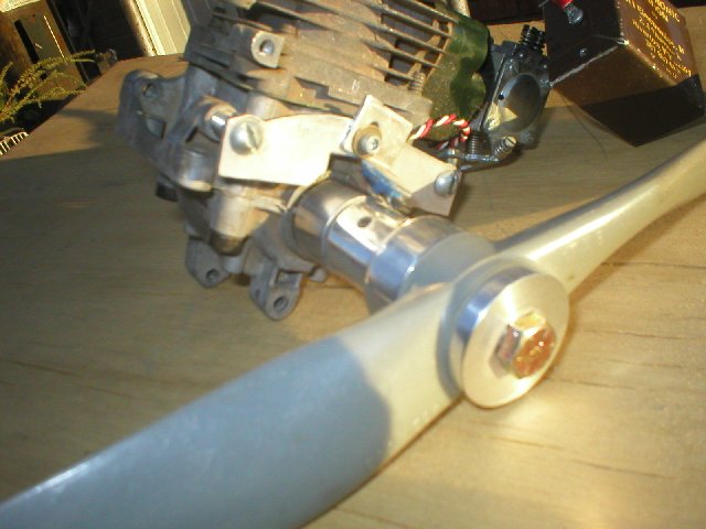

I had a person PM me and is starting a 28cc (27.2 actual).conversion and was looking for a thread but couldnt find it so im continuing this one. heres mine already converted.i have no numbers as my tach broke but im ordering one on monday.heres a few stats to start:
52oz RTF with prop and IGN..ill have to take a new pic of the engine after i ran it on my stand.first pic doesnt have prop
ken lamberts muffler--1/2 tubes
17x8 APC prop-ran an 18x8 carbon fiber from TBM but will post rpms later.
ill show couple shots of mounts-3 point on rear or rail.
WA200 twin needle 11mm carb.
hub and sensor ring were made from stock flywheel and lathe
length from back of engine to back of prop 4-7/8 inches

Your welcome.didnt get a chance to order my tach today,hopefully tommorrow.If ya need anymore help post it here or just pm me like ya did before and ill post answers here or what ever works thats easier for ya.What problems are ya having with the pics.

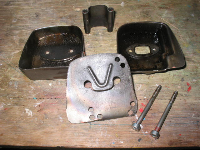

Hi
Photos not in order, sorry.
The first photo is the last.
Modifying exhaust, too much restricted, also take out baffle, less weight.
In this moment the engine is searching a new test stand, obviously.
Problems with needles, plastica caps, now the plastic caps are cut.
Trouble with transition, solution, plastic from syringe.

looks great.you did a very good job converting it it looks like.when i sent ya a pm i mentioned that im going to put mine in the 120 size edge 540 from texasrc.i stihl have to do my other 25.4 but ill put that in the stihl 25cc thread.but it will be a couple weeks a least.maybe ill get my tach ordered this week.
