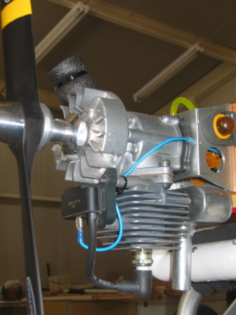

You're on the right track, Steve, the larger carb and a less restrictive exhaust will allow your Ryobi to turn out some useful power.
I trimmed off the flywheel fins with a milling cutter in the drill press, after cutting most off with a hack saw. This allowed me to true up the center as well. You're gonna really hate yourself if you didn't keep your dad's drillpress, it's more than a bit handy for this conversion stuff.
By the way, keep everything you remove from the engine. I reused the choke assembly on the bigger carb (mine's a Tillotson), and I used the starter pawls, springs, and pins and recoil assembly to make up a starter.

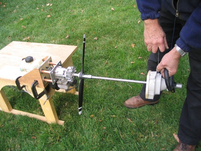

Now that is the most ingeneous starter I've seen. Good going sportflier. Has anybody been able to hand start a ryobi. Someone asked why I use a starter and my reply was because I dont think I can hand start a stock setup. I know other gassers like the G-38 with a mag ignition will hand start, just wondering if a ryobi will.

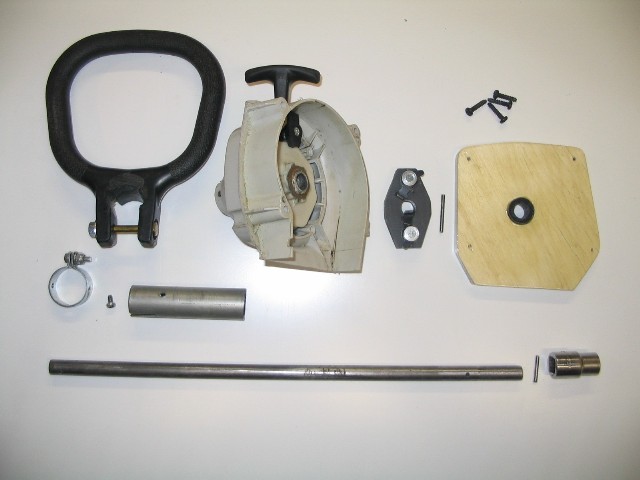

Here's a couple more pics of the economy starter for Mike. It really does work, and you don't have to get as cozy with the propellor as you do with an electric starter.
