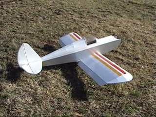

I modified the bandito grande a lot to handle a gas engine. Sheeted the aft control surfaces with 1/16" balsa and mounted the servos in the back. The bandito builds very light and is a frame structure behind the wing trailing edge. I sheeted the inside of the frame with 1/8" balsa on the inside of the frame work so there wouldnt be any outside contour problems. I moved the firewall back 3 1/4" and made it out of 3/8" ply. I balanced with no led at all. Also moved the canopy back one fuse former and lowered the profile for a more streamlined look. I made a fiberglass cowl sorta P-51 style. The flaps and ailerons were increased in size to 2 1/2" wide. With all those mods, its ready to fly dry weight is 13 lbs 14.5 ozs. Attached is my stock built Bandito Grande and my modfied version. It flys great.
Edwin

Thanks for the Bandito info! I really like the look of your mod'ed plane, very 30's racer-esque. Nice [sm=thumbup.gif]

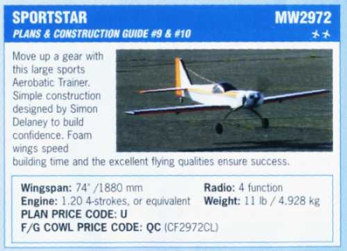

Hmm, the Ryobi's weigh 4lbs huh? That's over twice the 1.20 OS used in the SportStar (above). I can see why you had to move the firewall back by 3&1/4 inches aswell as it being longer! As I mentioned, I'll have to see if the designer will enter into some correspondance with me about modifications for the gas motor. But I need to get the engine running first - that should be fun! Eek, again!

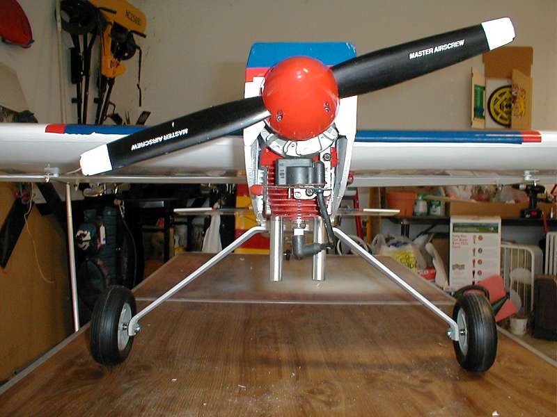

Here's a couple pictures of a really simple Ryobi motor mount. It's just a flat piece of 1/8" (3mm) aluminum plate cut out to suit. You could mount it on stand-offs, but I chose to bolt it to a plywood fire-wall for rigidity. In the photos, the whole mess is being held on by clamps for a trial fitting.
You may be able to put your hands on a piece of plate easier than the square tube. A bit easier to work with too. I've just used the 4 scews that hold the plastic intake block to the motor, but it may be wise to use slightly longer ones to make uo for the plate thickness.

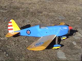

I just finished building a Balsa USA Stringray 120 and used a converted Ryobi with whackerengines part. Peter was a great help and his parts worked out great. I am posting a few pictures on the building process. I hope they help. I had to move the firewall back 2".

Here are some more pic's that my help. I also mounted the servo's for the elevator and rudder as fare to the rear on the fuselage as possible. I also mounted the battery and receiver in the rear of the plane.
The Balsa USA stingray 120 has an 83" wing span with 1276 sq. in. wing area. The total flying weight on the plane with the Ryobi 31cc conversion engine came out to 14 lbs. I am getting 7200rpm with a MAS 18x8 prop. She flies real well.

I painted the engine with a good engine paint I got at the auto parts store. When I had the engine broken down I just cleaned it up real good with a engine cleaner Than I covered the exhaust port, engine shaft, and the rear of the engine where the reed value and carb attach to. I than painted the engine with two coats of paint. After it dried I installed the Flywheel, Magneto, prop shaft, reed value with carb. The paint has held up real good and adds a little to the total project.
