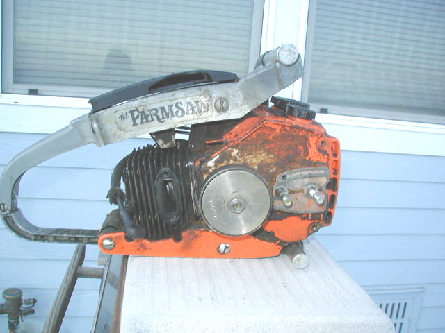

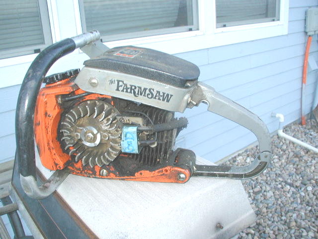

I've got an old Pioneer saw thats reed valve induction. It's somewhere in the range of 64-67cc. I'd have to definetly use an elec. ignition system with it. I've talked to Ralph about converting it, but I'm concerned with getting parts if it ever needs repair. I think it would be kinda heavy, because the cylinder fins are HUGE and bulky. Looks like a lot of metal there for cooling. Looks heavy.

Hey i just acquired a pioneer model 1110,all i know is it was made in 1965 or 66.Since you have a pioneer do you have any idea on this saw as to size etc. Thanks[&:]
My Feedback: (78)
I have no idea what size saw you have.
You can find out though. Remove the spark plug and drop a long wire down the hole. Measure the stroke from BDC to TDC. Record your #s.
Now remove the muffler and bring the piston to BDC and measure across the cylinder- top of the piston.
Volume = area X height
