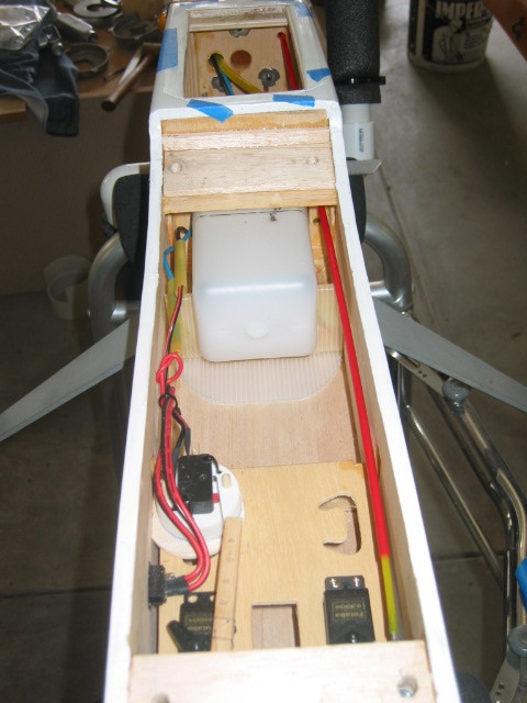

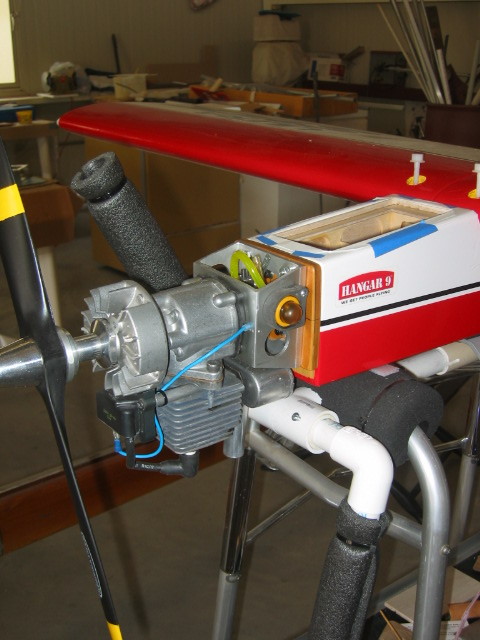

Old 06-11-2004 | 02:09 AM
Joined: Dec 2002
Posts: 1,986
Received 7 Likes on 7 Posts
From: La Paz BCS, MEXICO
Default RE: 31 cc ryobi on a ultra stick
Moved some things around. Rudder servo pull pull aft, Elev servo aft (single), radio & 4.8 bat aft, (FWIW TE prop is 8" fwd of supplied ply motor mount. Ended up with about 3/4 oz lead near TE hor stab.
If I were doing it again, probably alum standoffs instead of engine mount pictured. I'm still learning and the plane needs 6V bat which would more than offset the small lead added.
Plane balances to midpoint of suggested CG.
