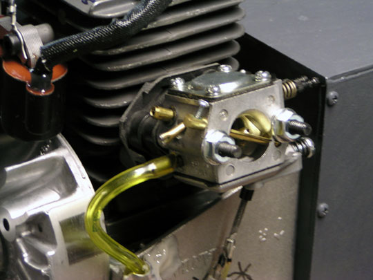

I finally decided to try my electric starter and the engine started, but it wouldn't run. I backed out the needle valves and it still didn't run. I finally got it to run by holding my finger over air intake, choking the engine. I think i have an air leak and that is causing the pump not to work on the carb. I have a stupid question, but since I got the saw in pieces I never saw which tube on the carb is the feed tube and which is the vent tube? Can anyone tell me? Right now I have the feed line hooked to the smaller tube located in the middle of the carb and the vent line to the larger tube that is closer to the top of the carb. Is that correct? Any help is appreciated. Thanks

Put the feed tube onto the bigger tube on the carb, and block off the narrower tube. I usually pinch it off and sweat solder it closed to seal it. You could also put on a short piece of tubing and plug it.
If you got the needles out of whack now, just set them at 1-1/4 to 1-1/2 turns out and start from there.
Here's a picture of how mine is set up.

Thanks for the picture. I definitely had the feed line on the wrong tube. But I tried running it again today and it didn't run any better. I switched the tubes and tried choking the engine and it didn't suck any fuel when the line was hooked to thelarger tube. It seemed to be sucking through the smaller tube which I had hooked to the vent line back to the tank. When I hook the feed line to the middle smaller tube the engine sucks fuel easily when fully choked. I also noticed that your carb is mount upside down compared to mine? I have the needle valves facing forward. I checked the carb mounting piece and and the hole from the engine that drives the pump is lines up correctly and the carb's pump hole is lined up on the mounting piece. I'm confused? Of course if I didn't have the pump hole lined up correctly that would explain why the engine is not running right. Have you ever seen the carb mounted with the needles pointing forward? Thanks for your help.

The engine will run with the carb either way. I turned it around for the plane I'm using it in. I don't understand why it won't draw fuel through the tube for you. If you removed the choke did you plug the holes where the choke shaft was? I forgot to do that once and couldn't understand why it wouldn't draw fuel when I choked it with my finger.[sm=bananahead.gif]

I might be mistaking but if you turn your carburetor around the vent line that 'flick' the pump won't align and it won't draw a fuel.Correct me if i am wrong
