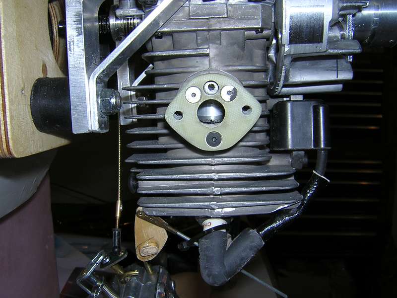

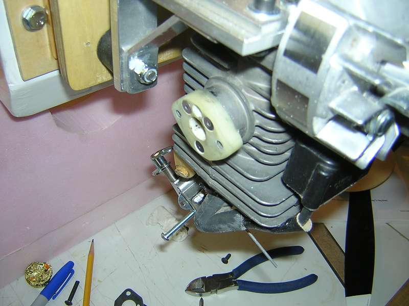

Old 02-26-2005 | 12:43 PM
  #34
Deadeye's Avatar
Posts: 4,516
From: Dutton, MT
Default RE: First conversion- Homelite 45cc questions
You guys will have to forgive me for not updating this thread. I have made the adapter, and the test run should be done possibly tommorow. The CAP-21 is almost done!!!

Deadeye
Now that's an insulator! It appears there is no direct metal contact between the head and carb. Nice work.
If I'm looking right at the pictures, you retained the pulse hole (no need for worm hole on back of adapter) and the carb still has the original rotational alignment to the head. You will use a bellcrank linkage setup?
Old 02-27-2005 | 01:47 PM
  #36
Deadeye's Avatar
Posts: 4,516
From: Dutton, MT
No bellcranks yet. For throttle, I simply use a cable and a 225 MG bolted right to the firewall. The stock throttle is spring loaded, so I just loosened the spring a bit so it's not such a pull for the servo. I still have positive return to close the throttle. As far as the choke goes, I haven't decided what to do with that. I'd like to have some kind of bellcrank that would allow the pushrod to extend down by the air exit on my cowl, but I'm still working on that one.
EDIT I forgot to say the carb is in the same relation as it was stock. The needles point forward, but i don't anticipate that being a problem once I get the engine tuned right. My Quadra has never needed a readjustment of the needles.

Test runs on the ground have proved successful. I haven't tached it yet, but will as soon as I can get somebody to hold it. I have it strapped to a heavy pole, but still...I don't like to sit in front of that 20 inch meat grinder. The Homey 45 has some pull, and I can prove it with the bruises on my calves from the horizontal stabilizer! She fires right up with a twist of my Dynatron (24 volt). Transition is a little sluggish, but I'm running pretty rich on the hi and low end right now.
