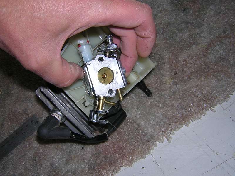

Hey guys. I'm new to the conversion end of things and i have a few questions regarding a Homey 45cc pulled from a chainsaw.

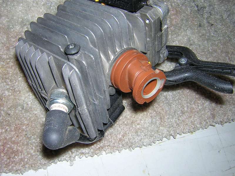

1) How does one attach the carb? The saw used a rubber hose and I see no way I can bolt the carb to the crankcase.

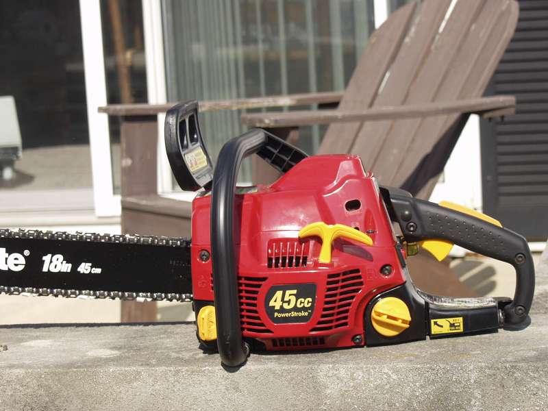

Deadeye Where did you get the engine? I'm considering HarborFreight's offering at $109. Don't like the sound of the carb mounting problem.. What series is your saw?
W8ye: Does the pic shown here give you enough to tell which carb setup may be on it?
This shows the color scheme on HarborFreight saw? Can anyone tell which carb setup it may have?
http://www.harborfreight.com/cpi/cta...temnumber=9967

This outfit has a bunch of carbs and adapter plates; depending on the furnished carb and 'meat' for tapping some holes it may be an alternative.
http://www.davesmotors.com/store/carburetors.html
Some posts quite awhile back mentioned some problems with adapting around the rubber boot. Don't rememeber the make of engine.
Where did you buy your engine?

looks like the round intake spigot has plenty of material to drill and tap for a normal 3/8" thick adapter/insulator. if that little nub is for case pressure to the carb pump it could just be relocated.
dave

How about two brackets holding a trimmed version of the existing plastic housing?
The brackets could be strips of alum bent at 90deg, and attatched to the motor using the crankcase mounting bolts.
Maybe worth a try!

Dave_M, that idea just might work! I was thinking of using an aluminum pipe bushing that would be thick walled enough to get the carb bolts in. But #1, I doubt I will find the right diameter, and #2, I would have to relocate the case pressure tap. Thanks for the idea. I will get my mounts ordered from Peter Faith at Wacker engines, and see if I can make it work.

Mike, the saw in the Harbor frieght picture is the old style with the bolt on carb. It has the red and black case.
As a general rule, so far, the refurbished saws have been the old style while the newly purchased ones are the new style.
I found this out the hard way. I bought a 45 from a well known auction site. The seller was actually a pawn shop. It was a used one and not refurbished. When I got it, the saw was barely used at all but the chain was ruined. Anyway, it was only made a month before I bought it and was rather different from the 45 I bought from Cumming tool that was refurbished a couple years ago.

deadeye
Expanding on Zagnut's comments, How about:
1) tapping for studs in meaty area 2) pheolic resin plate sized/drilled to fit to allow using the adapter per pic; 3) drill install smoke fitting nipple in head to meet existing pressure/vacuum hole; 4) someone knows where to put a nipple in that carb and gasket seal the existing hole in carb face. 5) system would allow optimizing the linkage alignment if it is a problem.
I visualize the messing around that would be involved if that rubber seal loosened either at the large OD or the pulse nipple. That rubber boot may also affect linkage as it will allow some movement.
The part is for a G62 so size and ID should be close to your carb. What model / size carb comes on that engine?

The carb is a 'Zama', made in China. That's the only markings on it, except for the choke valve. It has '58' stamped on it. I'm taking the whole works to a chainsaw repair store today to see if they can fit something to it. I will defintly keep you all updated on my findings.
EDIT I found 'H58B' and below that '42A' stamped on teh fuel inlet side. On the needle valve side, I see '0.1M'.

I'm almost finished with my carb adapter, fellas. It really wasn't that bad, and that sucker is mounted tight and strong. All you need is a about a 2 1/2 square of 1/4 aluminum strap, some 10/24 or 10/32 bolts long enough to extend about 1/4 inch through the carb, and 3 or 4 6/32 countersink blots for the plate. I will post pics when I finish, but all I have for tools is a bandsaw, drill press, and belt sander, so just about anyone can make this. I'm heading to the shop now...
Old 07-08-2004 | 04:35 PM
Deadeye's Avatar
Posts: 4,516
From: Dutton, MT
Default RE: First conversion- Homelite 45cc questions
As mentioned above, this uses a chunk of 1/4 inch aluminum stock. I drew a line a little bigger than the gasket I had to get my shape. Measure the plate to block screws far enough out that they don't interrupt the flow of air for the carb. I used 6/32 tapered allen head screws, so I could countersink them flush with the plate.

nice! basically what mike and i had in mind except you managed to keep the pulse hole usable and avoid rerouting it.
now you just need to be sure that the lack of insulation isn't a problem while running.
if heat is a problem then you can just make a new adapter out of 3/8" phenolic or epoxy board. this can also be threaded for the 2 carb bolts without the need for inserts or nuts. but being thicker than the alum adapter it would be better to grind the little pulse nipple off flush with the surrounding area.
now run it!
dave
