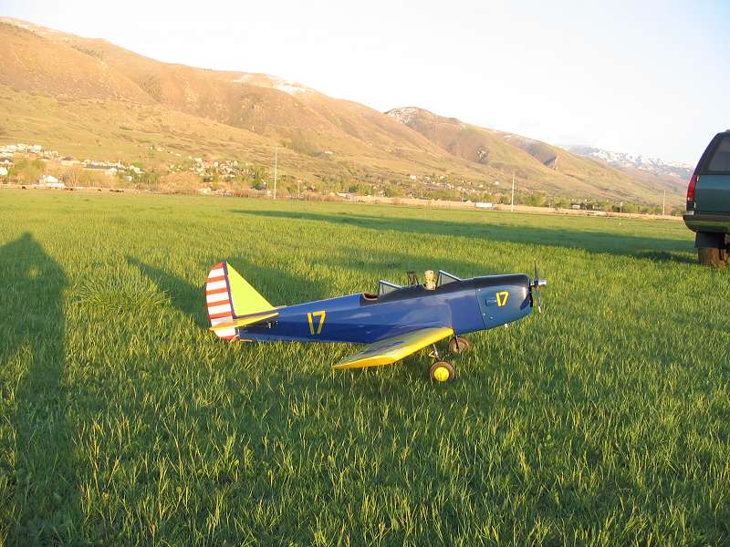

Hey my friend I'm not to far away from you. I live in Centerville. I am currently flying two planes with the Ryobi. A Hanger 9 PT-19 at around 14.5 lbs. on mag ignition and a Great Planes Ryan STM at around 13lbs. on C&H ignition. Both fly very well and it is quite surprising how well the Ryobi's pull them around at our altitude. Both of mine are the two ring versions. I am thinking of putting another in a Lanier 1/4 scale Extra 300 that is supposed to weigh in at 12lbs. RTF with a glow engine so I will be watching to see how yours does. I think it will fly very scale aerobatics but no 3D which is ok with me anyway. Both of mine are using a Master Airscrew 18x8 wood prop which I have found to be the best all around prop so far, although I haven't used any APC's because I am trying to keep a scale look. They might even pull better. Drop me a email when you get her going.

(Maximus) I am getting alot of advice from on the engine tunign side in this string-
http://www.rcuniverse.com/forum/fb.asp?m=2030275
Have you done anything special to your carb? I was going to leave mine stock for now and see how it performes. I'm sure altitude and the summer heat will be important factors here.

Currently running the factory Walbro on one and the factory Zama on the other. They both seem to do fine.
