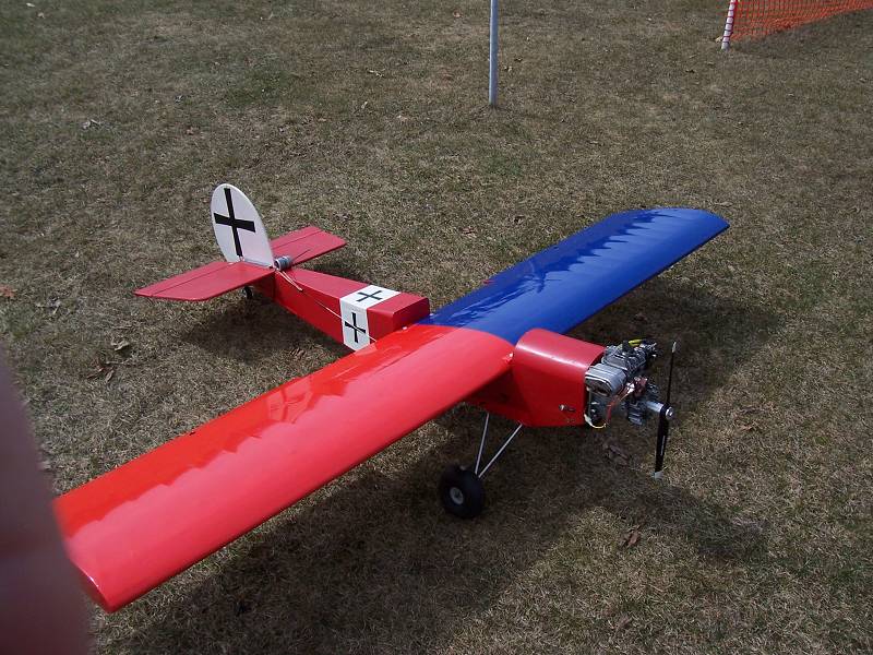

That sounds like a perfect match. Here is a picture of a huge stick I tested the Briggs on a couple of years ago. It was really heavy 25 ish pounds.

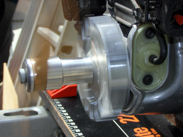

I'm dink'n with my BS. Ground down the flywheel, and excess chunks on the engine. Decided not to mess with the carb spacer for now. I think I could take off about a half inch, without destroying it. Should be easy to braze an exhaust pipe to lose an ounce or so, and give it that sound of power.

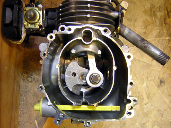

P. Nut, I may have to get one of those Ryobi carb spacers. I ground down mine about 1/2 inch and am a bit worried if I got the bleed channel carved in it OK. Attached are some pictures. The first shows the 360 degree oil sump. Very simple idea, with splash lube. The other photos show it running with the prop spacer, ground flywheel, shortened carb spacer, and exhaust pipe. The original muffler was 8 oz, this pipe is 4 oz now and I will eventually trim off a bit more.
Rod S
