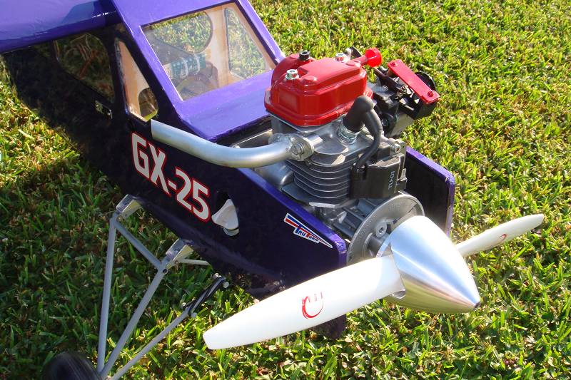

If anyone is still looking at this thread, here is a couple of pics of my recently completed plane with Honda GX 25...
I had the same issues with the carb return spring, every time I tried cutting the hook off, I ended up with a spring that wouldnt coil tight enough to fit in the space above the barrel. Did any of you guys remove the barrel to cut the spring, if so, how did you do this ?
You may see the added plate ofer the carb, this was to hold a spring on top of the barrel.

Default RE: Briggs and Stratton 34cc Fource?
Certainly am watching and with much interest. Nice to see the Honda in an airframe, how does it fly? What's the noise like with just a header pipe? I have changed my carb to a normal type Walbro and it's transformed it, I just had to drill the manifold to fit a pipe to the carb for the pump and it works a treat. I forgot to mention mine is the GX31.
Old 07-09-2009 | 05:09 PM
  #120
Joined: Jan 2007
Posts: 317
From: pearland, TX
I is pretty low on power but flies the 14lb model ok.
noise is low and sounds great, idles at @ 1300rpm with a "put put" sound !!
Which carb did you use ?, the carb on it is a walbro but the return spring issue is a real pain in the a**.

That sounds promising, I intend to put my 31 in a 1/4 scale SE5a. I cant tell you which carb I used, it came from my local garden machinery shop off a scrap strimmer, it's at my mates right now having the prop driver made so I cant just nip out and get numbers for you. I'm hoping to throw a 18 x 6 wood prop at about 7,000rpm with any luck. I will report as soon as I have run it with the newly made driver.

My 25 pulls a 16 x 8 at @ 7k, tried an 18 x 6 but it goes down to about 6.6k and doesnt appear to pull as well.
I heard the 35cc will pull an 18 x 8 to 7k with no problems........
