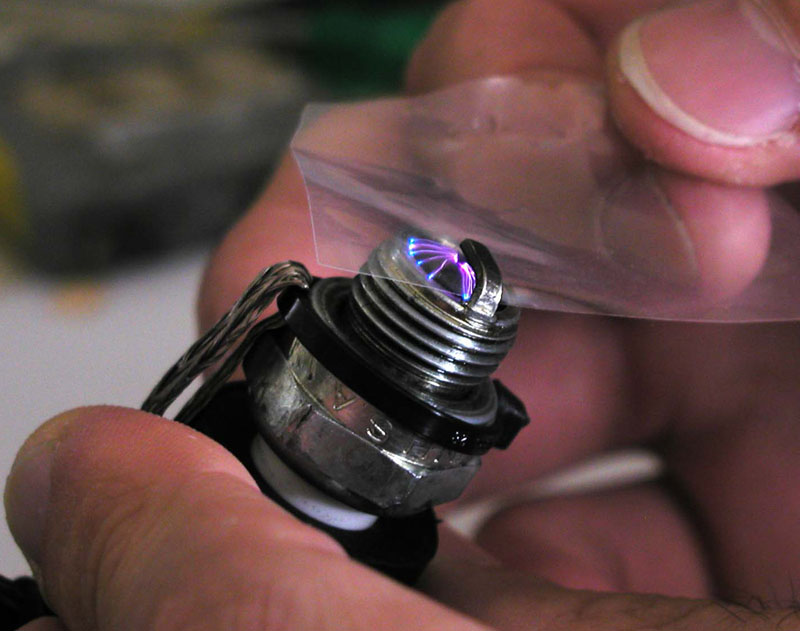

It's running like hell.
Here we go again with the specs of Ultra-Spark:
- Electronic Ignition System with no moving parts
- Microcomputed adjustable advance (the spark advance setting is adjusted by turning a potentiometer while the engine is running, there is no fixed curve)
- No need of large packs (more than 2 hours of continuous running on 5 years old 4.8v 550mA Futaba pack)
- Works with 4.8V or 6V
- Weights less than 6 oz
- Strong spark up to ~25.000 rpm
- Twice spark power at starting
- No kick backs, retarded spark at starting
Included:
- 1 Ultra-Spark Electronic Ignition System with computed adjustable advance
- 1 Wired Hall Sensor (include Futaba style connectors, it's in the picture)
- 1 Extra Unwired Hall Sensor
- 1 Neodymium Magnet (size at your choice)
- 1 Extra Neodymium Magnet (size at your choice)
- 1 Fastener to ground the spark plug
I'm building the first units at U$S80, PayPal accepted so there is no fees at all.

is there enough spark energy?
