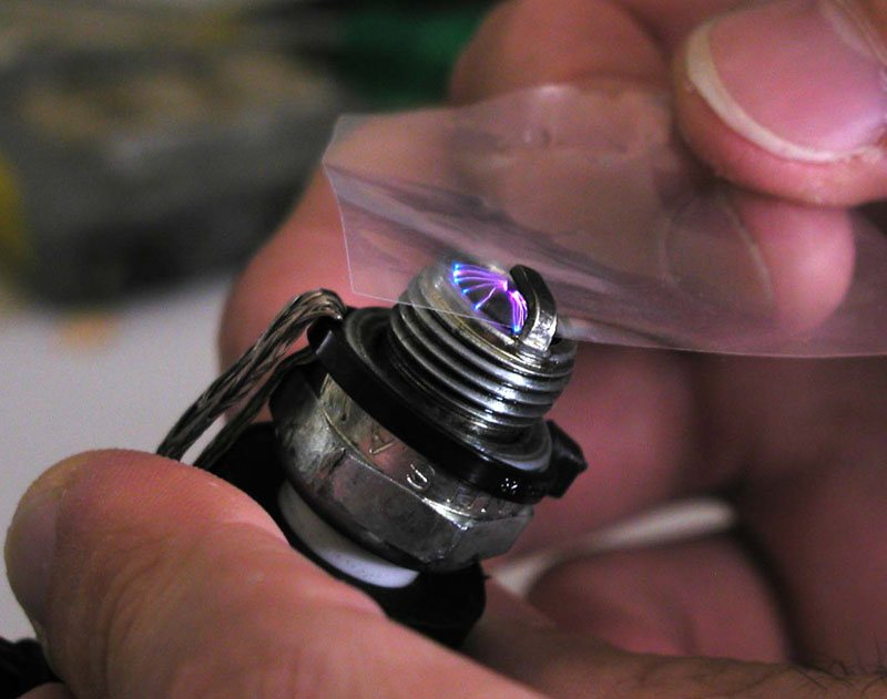

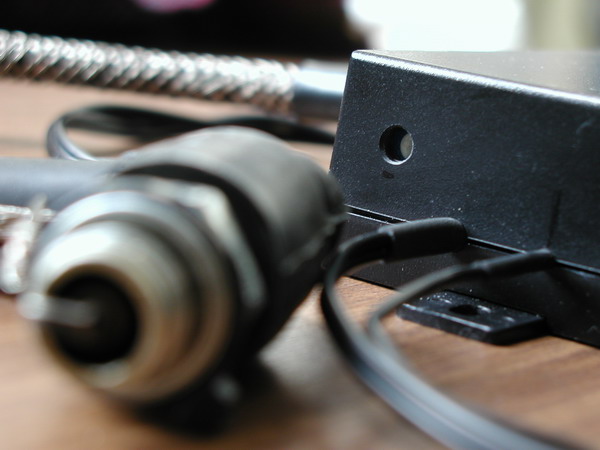

Hi people, I just want to show you my own CDI system with advance timing programmed. The microcontroller is gradually advancing from 2000rpm to 6000rpm where it gets full advance (adjustable in real time from 0 to 33.5 degrees) so I can look for the best point with the trim while the engine is running. It works fine with 4.8V or 6V, 550mA it's enough (power consumption 220mA). Easy start and no kickback (retarded), good spark up to almost 30.000 rpm. Total weight is 5.8 oz
It's working fine on my converted Stihl 60cc, I'm going to test it on a G-23 soon.

Is the braided outer insulation wire attached to the compression ring on the spark plug?

Mikenlapaz, the braided wire can be attached to the spark plug's body with a fastener after install the spark plug on the engine, or directly to the engine's body. In the picture is attached to the spark plug with a plastic fastener just to test the unit without the engine.

El agujero en la caja plástica es para regular el punto de la chispa con un potenciómetro como lo tiene el sistema pro spark??
(The hole in the plastic box is for timing regulation with a potentiometer as the Pro Spark system??)

Exactamente por ese agujerito tenes acceso al preset donde regulas el avance que quieras, desde 0 grados hasta 33 (con el sensor en 35 grados antes del punto muerto superior). El avance trabaja gradualmente, hasta 2000 rpm esta en 0 y luego adelanta progresivamente, de 6000 rpm en adelante ya trabaja con el maximo avance seleccionado con el preset. Ahora te contesto el pm.
(In the hole is the potentiometer to set the max advance from 0 up to 33 degrees)

and what coil are you using?
dave
Old 10-30-2004 | 01:31 PM
ZiLoG Z-80's Avatar
Joined: Feb 2003
Posts: 63
From: Bs As, ARGENTINA
Default RE: my first working cdi with advance
I use lightened coils,think are from XR. I get spark gaps up to about 4mm
